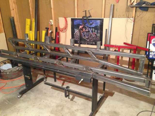

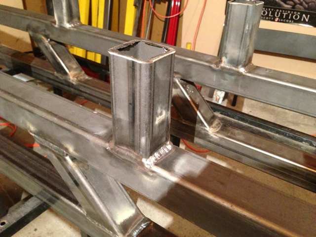

    Got some work done on the sliders. My bro was putting down some great welds

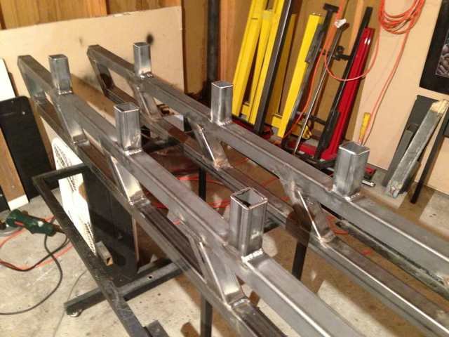

    Been working on my sliders and drinking PBR. Okay so I did the cutting and grinding while my bro did the welding. There are a few of my welds, but just enough to see why I had him do the rest :)

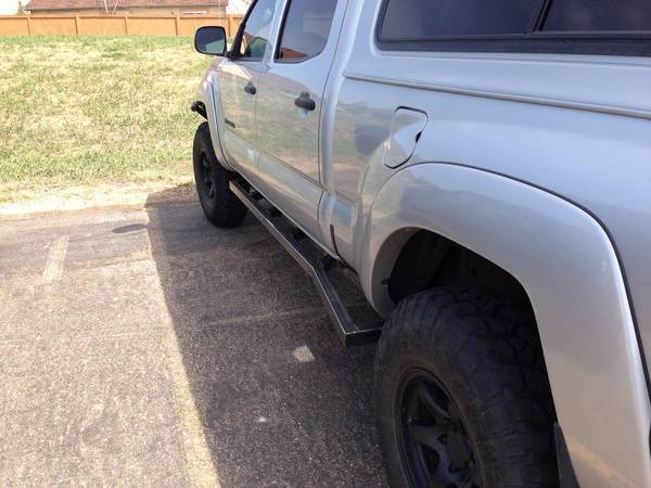

    Got the sliders done... Well not painted but at least they are on
    Took a lot longer than expected because the welder had to be used on 110v to get a cord long enough to go to the driveway and kept tripping the breaker. And of course after I got one plate welded on I discovered that I needed to grind the paint off of the frame before starting to get a good ground. That made for interesting welding: having to burn through the paint before it started welding right. Oh and I kept starting fires under the truck by forgetting about the little plastic clips that hold the brake lines to the frame. almost melted one brake line :eek:, but it is still relatively intact...:eek:

    Oh god! Hope the brakes still work!

    Yeah I was a little cautious on the way home from my brother's house (where i did the welding) to make sure the lines held up. I can't believe that I didn't see that coming. I felt really dumb...
