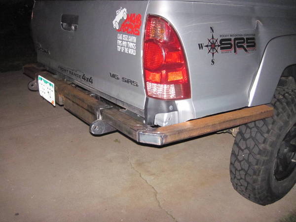

    This is how she will sit for a while. No more time to work before Moab. Will finish welds, build tire carrier and get it powdercoated in the next month or so. For now, this will do.
    Please let me know what you all think. Be honest, I am trying to get better at this.

    I would blend grind the welds if you haven't already done so, and also fab something up to fill in under your tail lights, that gap would drive me crazy. But that's my own opinion. It is your truck so your opinion is all that really matters!

    Oh all that is going to happen for sure. I ran out of time before Moab. Grinding welds, building something to fill in gaps, building tire carrier, and coating. Lots left to do. Thanks for looking! Keep an eye on it, should be done in the next couple weeks.

    I know! If it were an old rat-rod style crawler I would leave it but It's getting bad. I have to build the tire carrier, fix some places where the bumper warped and then get it powdercoated. Hope to have it done before I go to WY

    Been a while since I posted Here. The bumper isn't done but I find it hard to work on the vehicle when I can wheel it, so I don't, I wheel. Anyway I am going for another multi-day trip to wyo next Thursday and would like to have the spare carrier done. Not sure that's happening because of other obligations but we will try.
    had to fix some warpage due to heat concentrating in one place (we got rushed and didn't stitch some stuff we should have) but it turned out great.
    Now for the carrier. All I have left is 2" square tubing with 1/4" wall so it is heavy-duty and just plain heavy. So I decided to make it smaller (only one triangle where most other swing arms I see have two). Here is the preliminary frame just tacked together.
    The spindle housing was tig welded to avoid heat warp
    Now I need to find some raw hdpe material for a strike plate/isolator/closure system. Not sure where to buy raw plastics like that, but maybe I can find a product that is made for something else that I can modify. For this I am thinking the material that a plastic cutting board would be made of.
