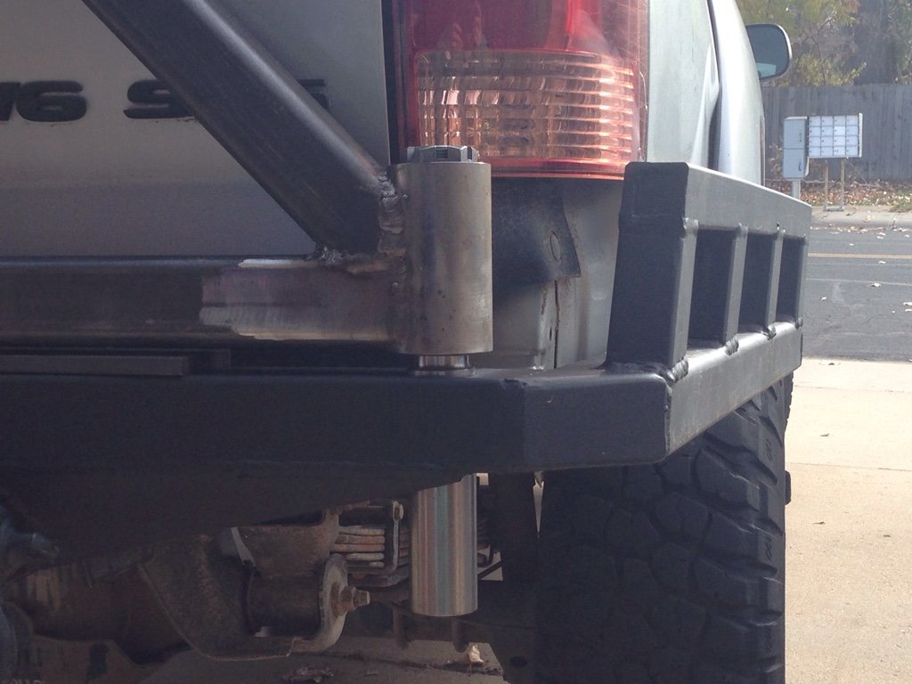

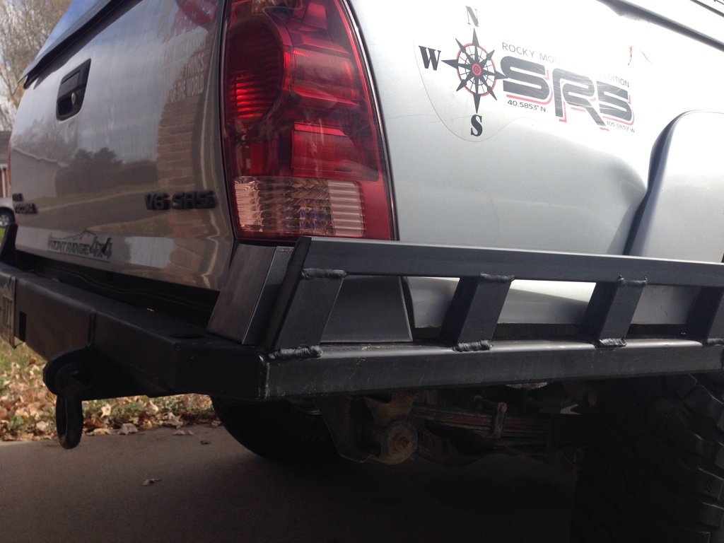

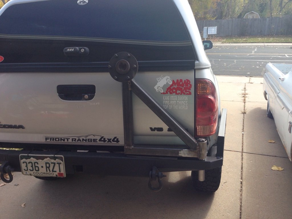

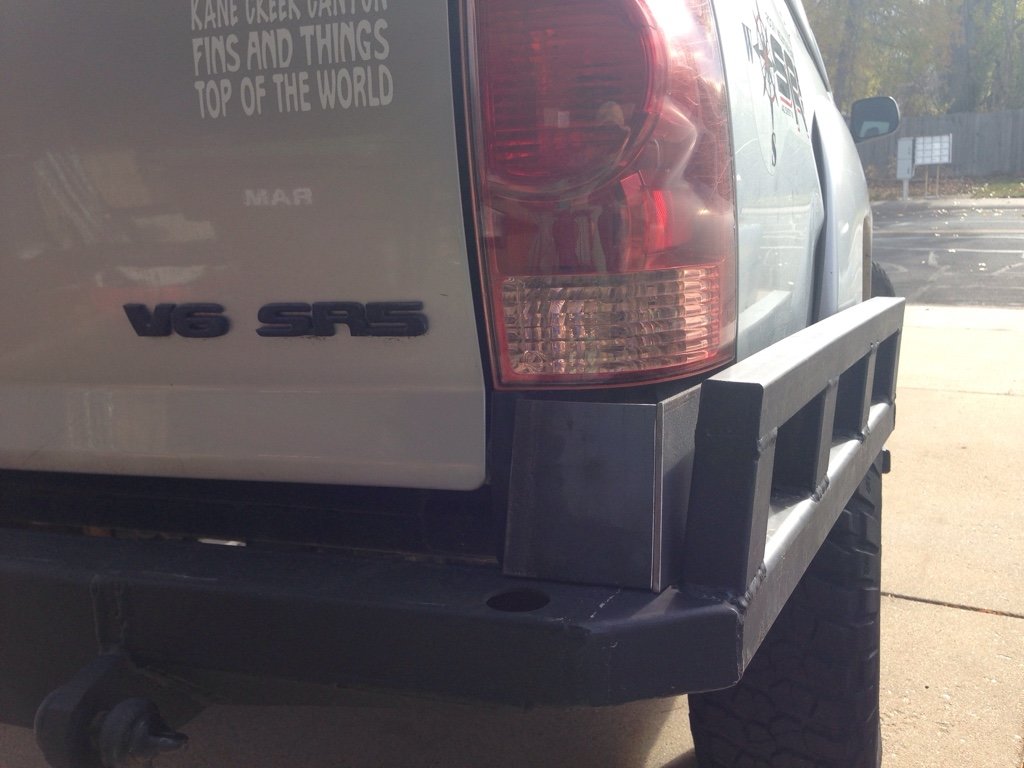

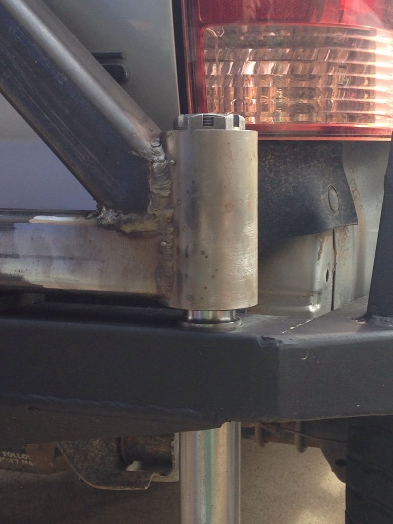

    Did a bit of work today.
    Filler plates cut. Unfortunately no time to weld.
    Got the bearing races pressed into the swing arm so we could finally assemble the hinge and measure for cutting the spindle down to size.
    Some parts Bob threw in with the coilovers I bought from him. A swaybar relocate bracket became a leveling shim for the arm when closed.
    A few more pieces to cut, a weld day and a grinding day then ready for final coating and finally done with this bitch.

    Looks good Travis. Leave some clearance with those filler plates so you don't pop your taillights out when you hit the bumper. ;)

    Planning on it, although I don't know if I left quite enough. It will probably be about a .25" gap.

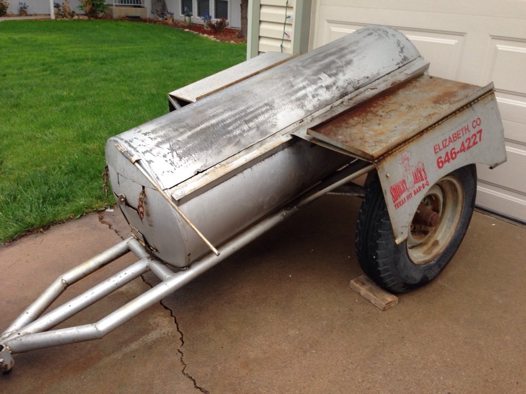

    I picked up a possible project for $25 from a coworker. Might restore and try to get into BBQ catering (especially for outside events like RT, if I ever get to go again) or strip it down to frame and axle and do an adventure trailer. OR BOTH :headbang:
