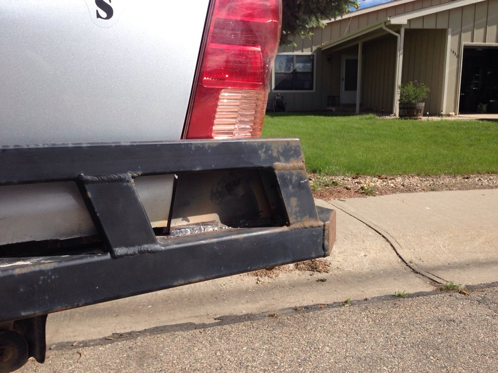

    Got a small step towards finishing the bumper. Burned on the filler plates! They will get trimmed for flexing clearance beneath the tail lights when we take the bumper off for the last time. Waiting on the latch and trying to find some 1/8"-1/4" HDPE sheeting for a good strike plate/rest for the arm when it is closed and latched. Anyone have ideas?

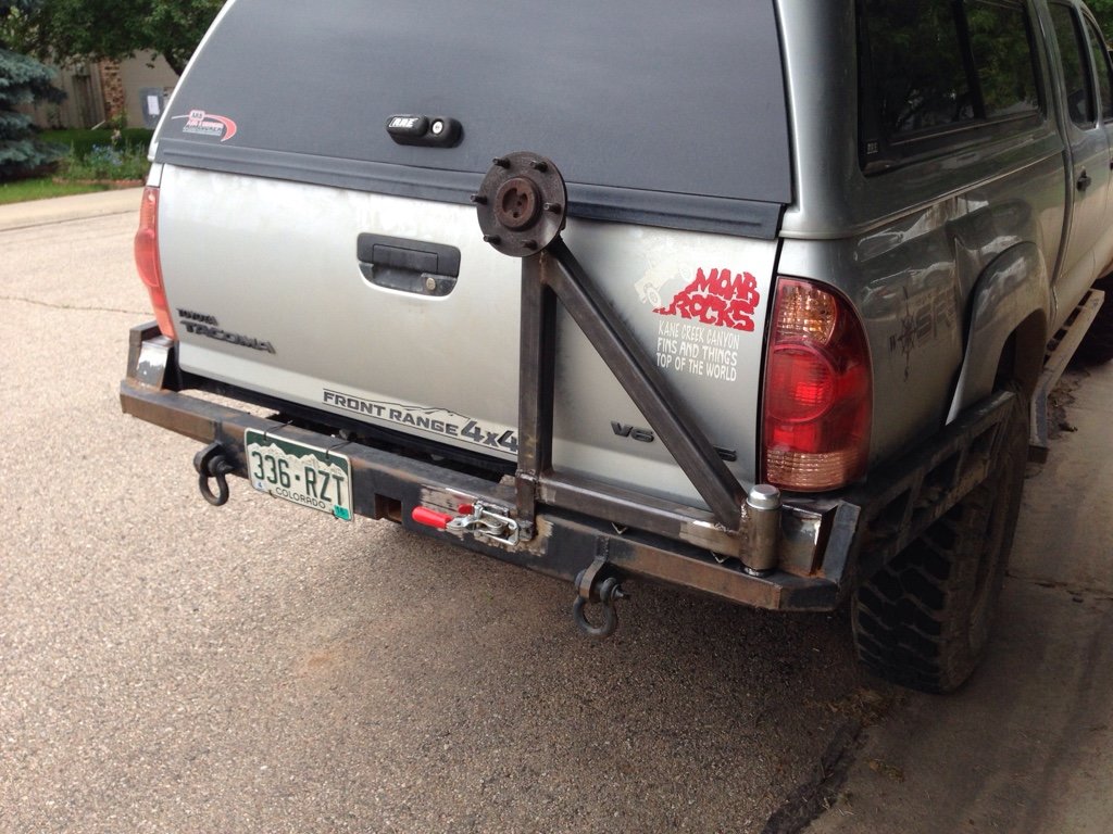

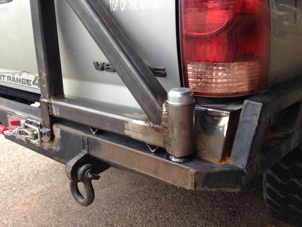

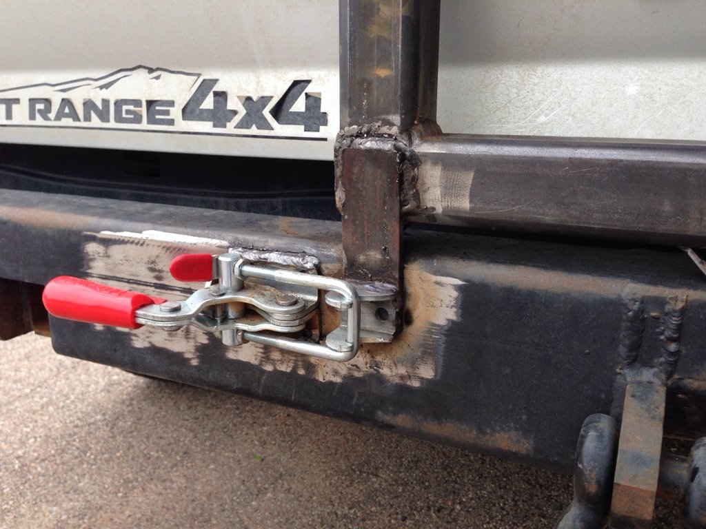

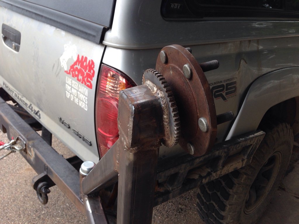

    Got the filler plates in and swing arm and latch mounted. Need some open-end lug nuts and I can mount the tire. A bit of finish grinding then Making the appointment to get it bedlined on top, bring it home to rattle can paint on bottom and the rear bumper will finally be done!
    Pics
    My brother's pro tig work on the thin stuff
    Detail of the spindle mount
    Last minute snag we hit last night was that the Handle for the latch hung down too far (I can't believe I never measured that out)! Anyway, we killed two birds with one stone when we decided to put a piece of 1/4" strap to span the gap between arm and bumper. The strap acts to keep the arm from swinging too far back and hitting the tailgate and is plenty solid for the new latch point.
    In the other pics, note the angle steel cut and put on the bottom of the arms to shim up and take weight off of the spindle. There is one more behind that piece of strap.

    Do you have any gussets on the back of that carrier plate?

    It is actually a whole hub flange from a full-sized Nissan pickup that I welded onto some 1/4" 2x2 tubing.
