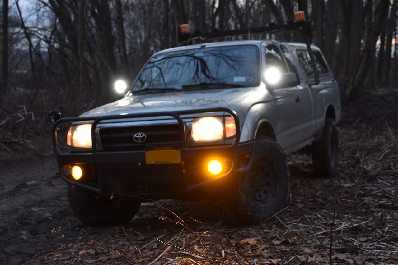

    2000 Tacoma 3.4L SR5 Extracab 4x4
    2000 Toyota Tacoma Extra-cab SR5 3.4L 4x4.
    Truck is my DD,work truck,offroad exploring truck, etc.
    I do a lot of solo driving so the build is aimed toward self sufficient and reliable.
    Modifications:
    Warn front 2" receiver (incorporated into bumper).
    Custom front bumper with foglights.
    2 A-pillar mounted LED lights.
    Blue Sea fuse box.
    Yeasu FT2900 radio.(Ham)
    Uniden 505 radio.(CB)
    16" steel rims with 235/85/16 tires.
    Rear diff breather.(sorta)
    Rear storage panel.
    Fire extinguisher mount.
    Sway bar delete.
    Side/Rear LEDs.
    Amber lights.
    Bilstein 5100 front shocks with heavier coils.
    Warn 9.5cti winch.
    Custom Aluminum flatbed (WIP)
    You will notice that I remove or install the cap depending on what I'm doing with the truck.
    Will keep this post up to date as best I can.

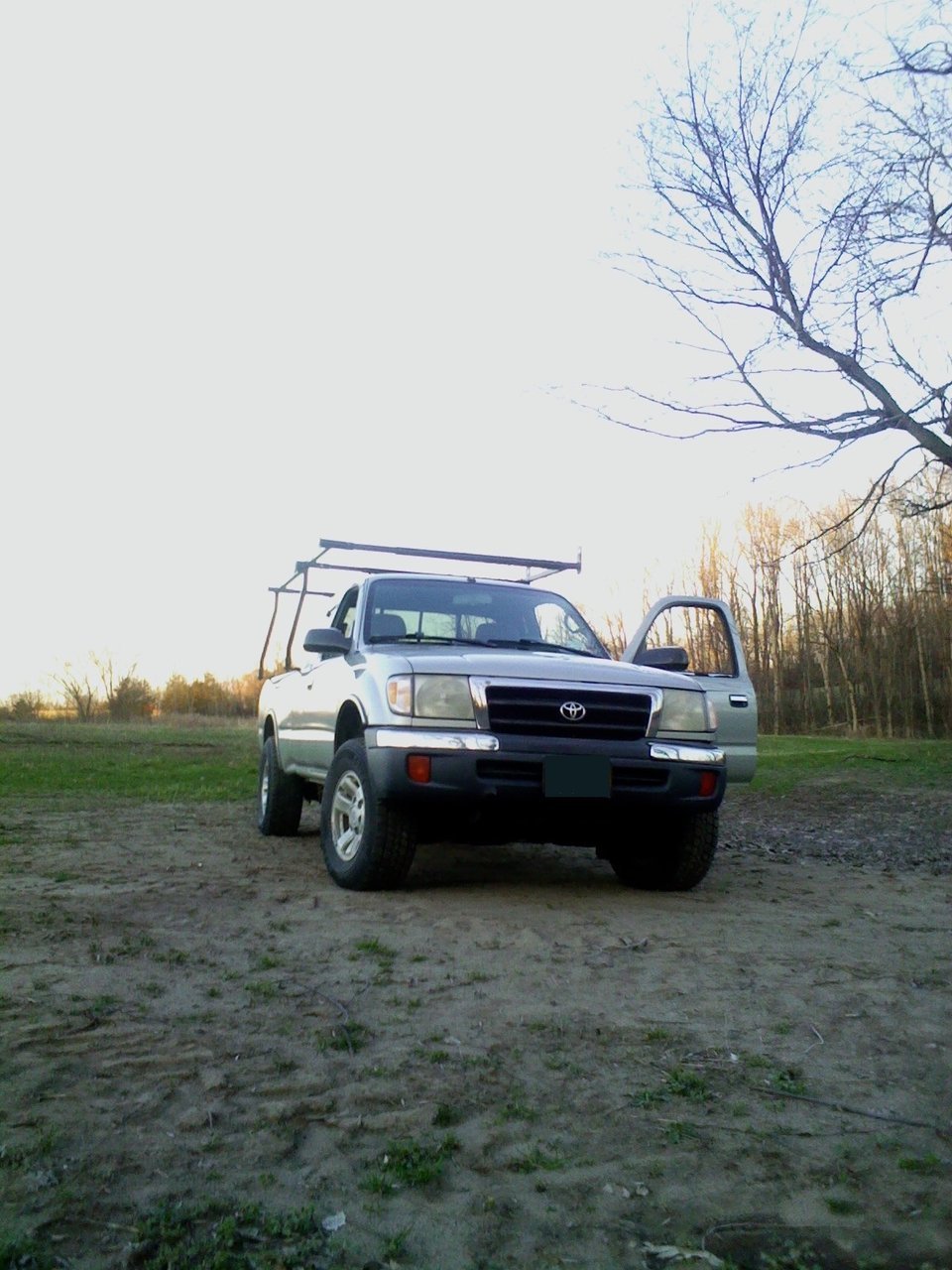

    I bought it from the second owner in the summer of 2015 with 250k miles.
    Came with matching cap and ladder rack.
    This will serve as a before pic.
    Minus the cap:

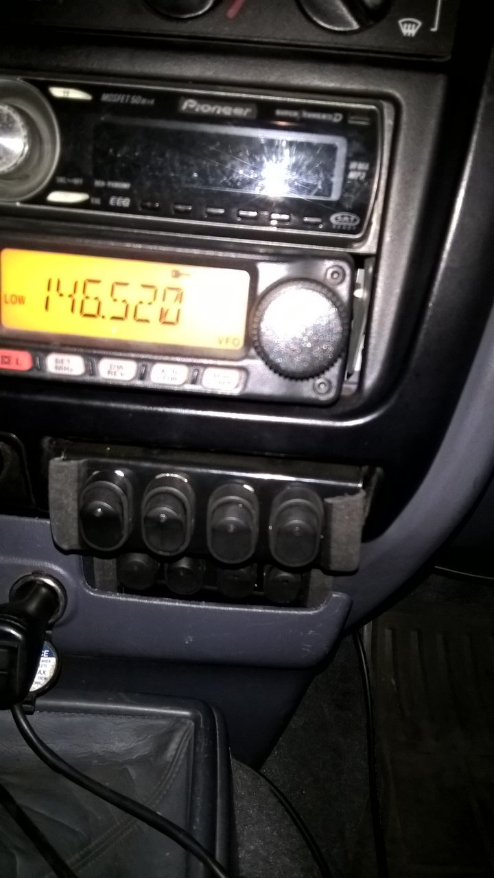

    Installed A-pillar lights using modified clamp on hood antenna mounts.

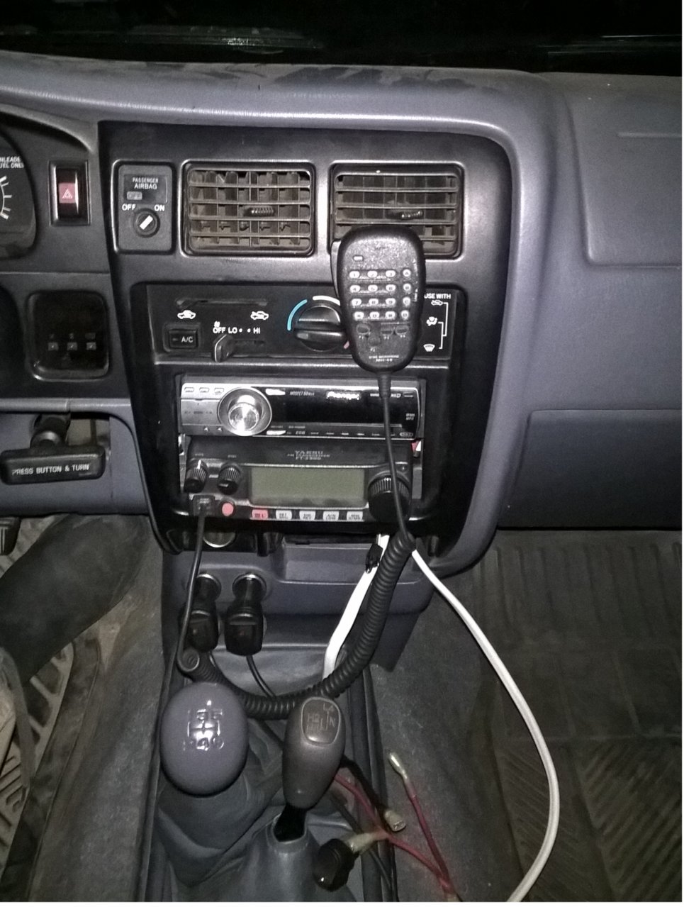

    Switch bank located where the ashtray was.
    Installed the Yeasu FT2900 radio in the dash under the aftermarket stereo system the previous owner installed.

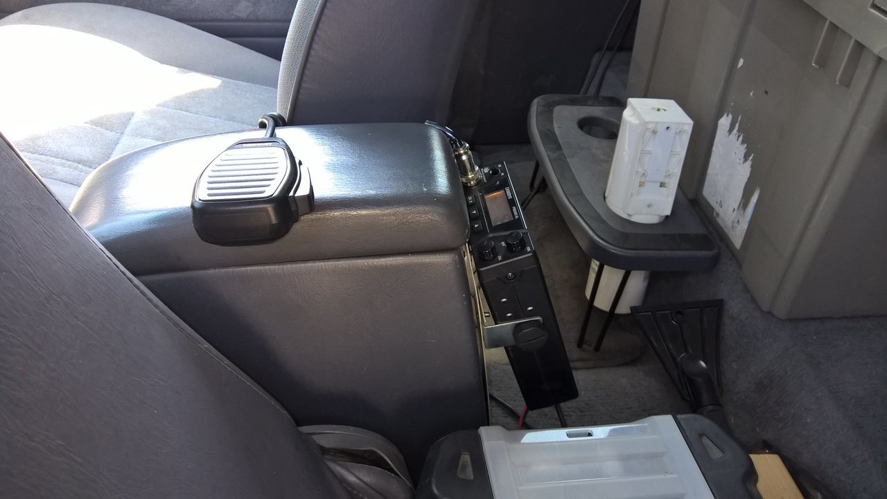

    Uniden 505 CB radio behind the center console.

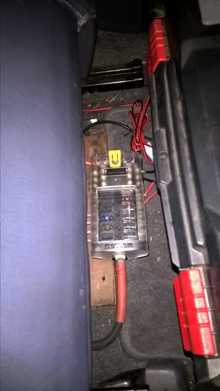

    Blue Sea 5026 fuse block under driver's seat, in the location of the PO's sub-woofers.

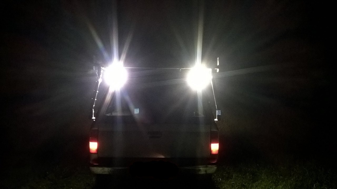

    Hung my leftover LEDs that were on my ladder rack on the sides facing back.

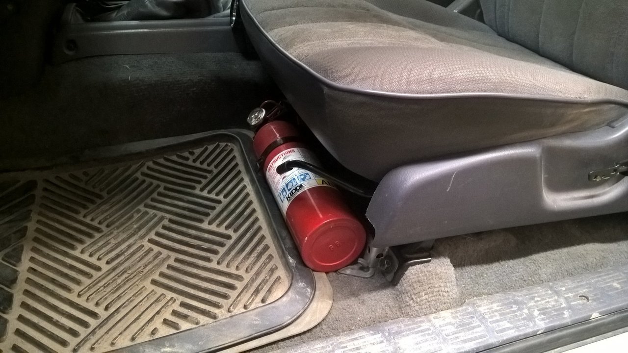

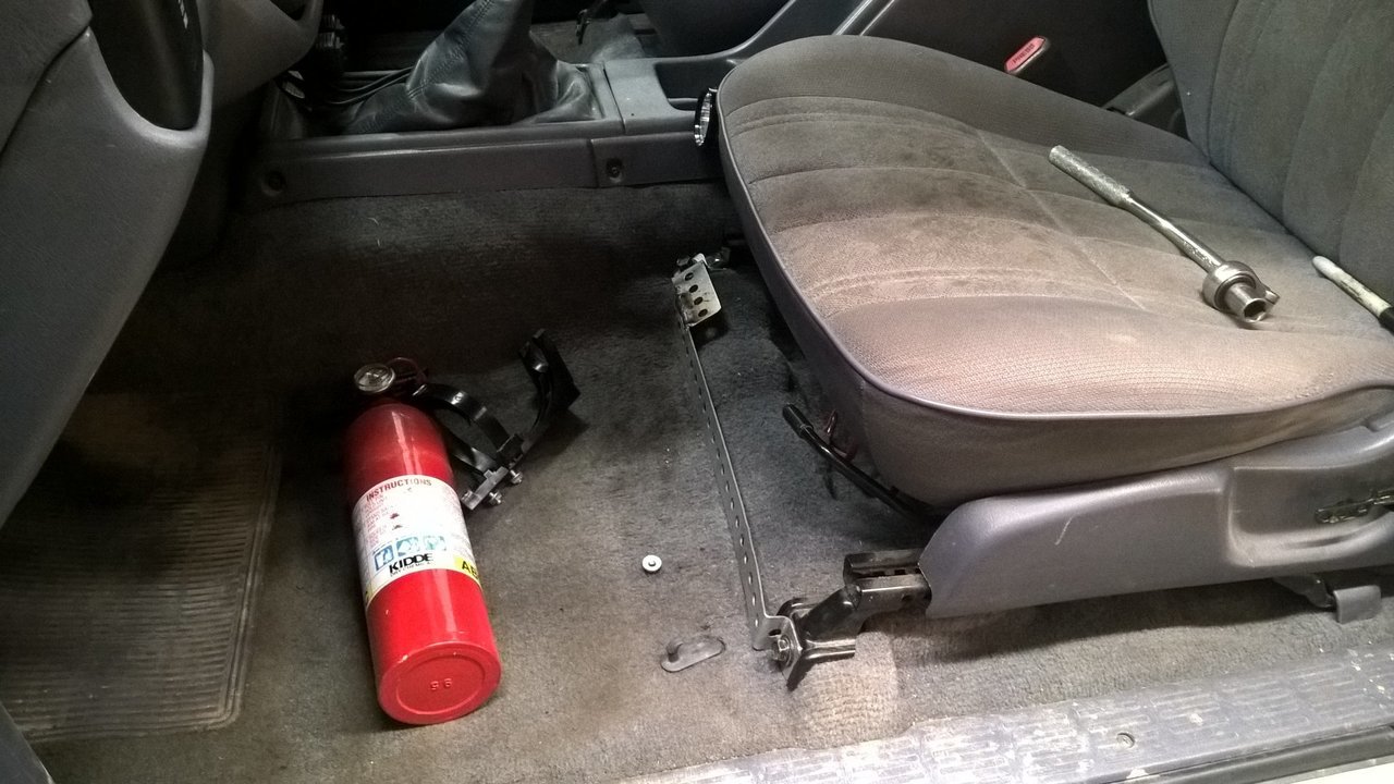

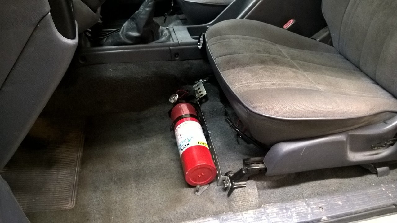

    Custom made fire extinguisher mount under the front seat.
    Basically copied ones I've seen for Landcruisers.

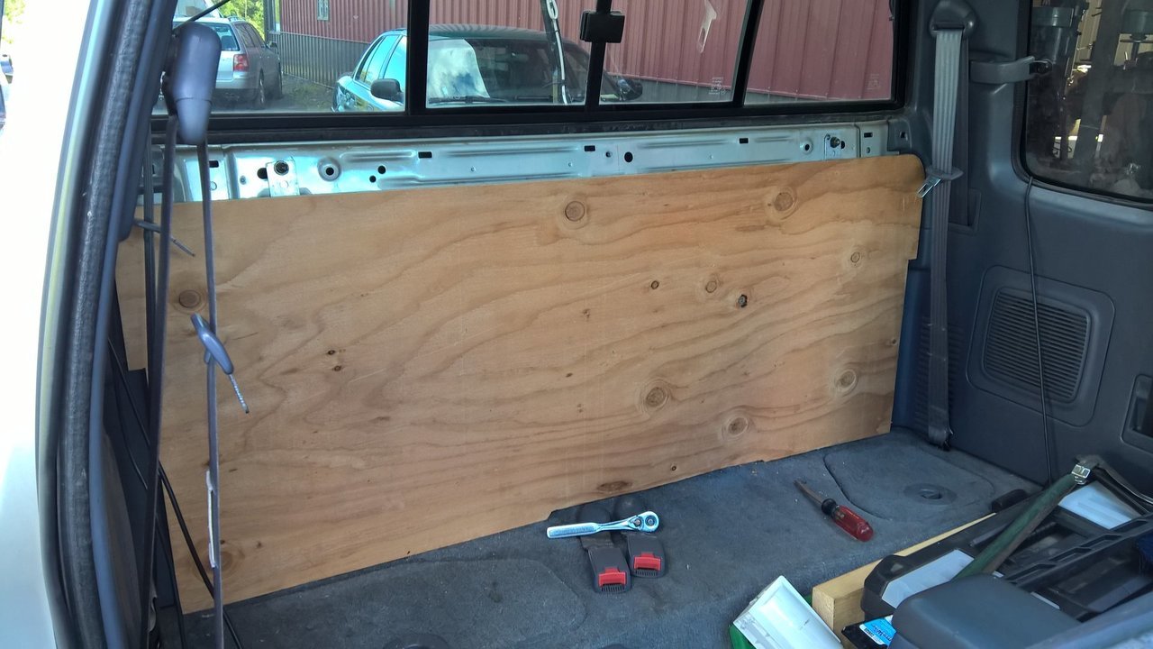

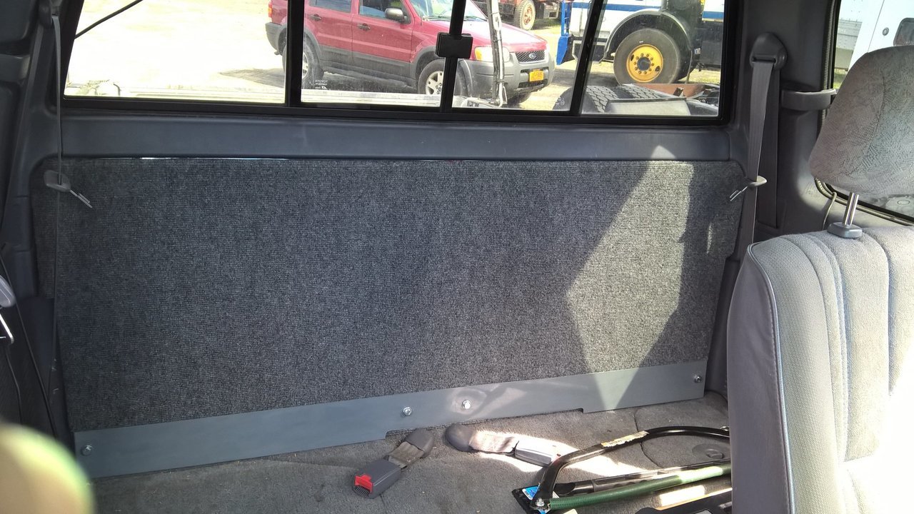

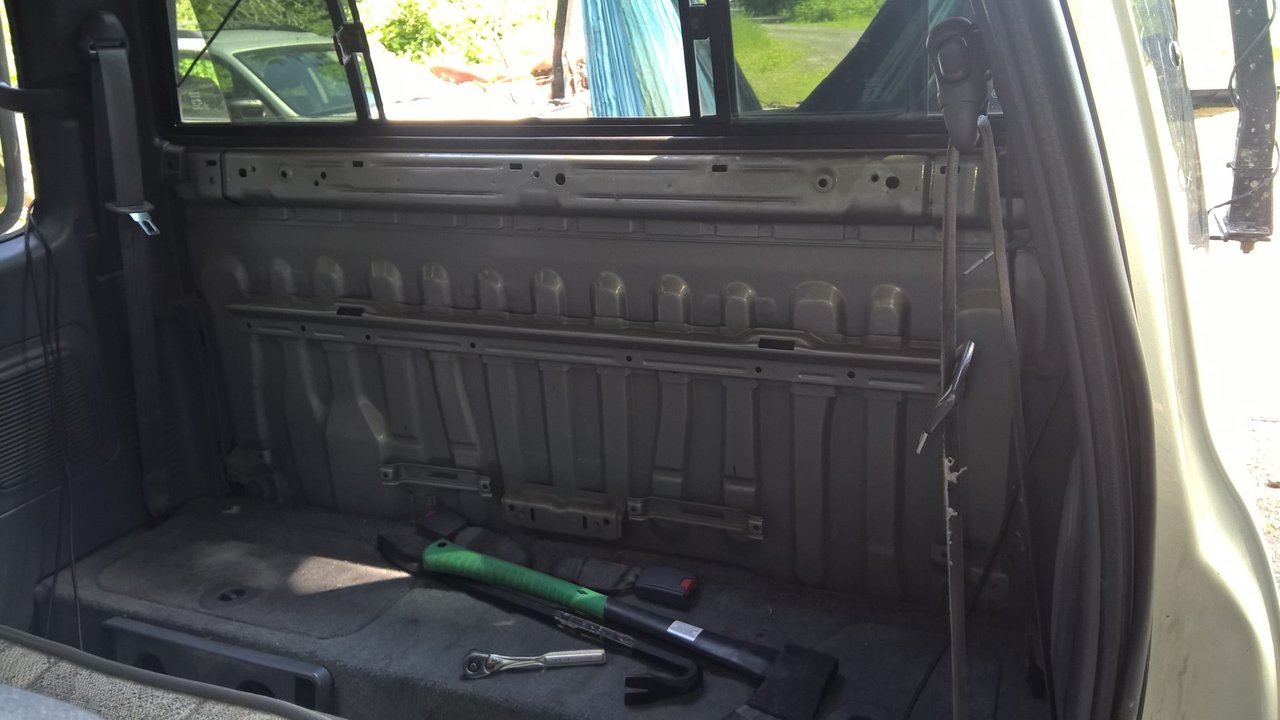

    Wanted a way to store tools and gear on the back of the the extra-cab. After browsing the forums, I copied an idea for a 3/4" ply wood panel covered in carpet, that I could mount tools and pouches to via Quickfist clamps and MOLLE straps.
    Pulled the rear seats, but kept the seatbelts.

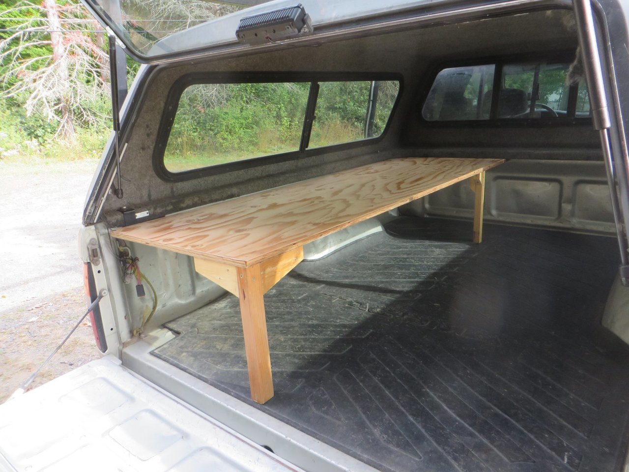

  6. Feb 15, 2018 at 7:42 PM
    MountainN22
    MountainN22 [OP] Well-Known Member
    Jan 29, 2018
    #242878
    107
    North East

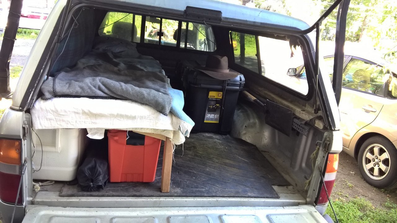

    Made a sleeping platform that comes off with the cap. Much nicer than sleeping on the cold steel of the bed.
    Also made a shovel mount for the cap.

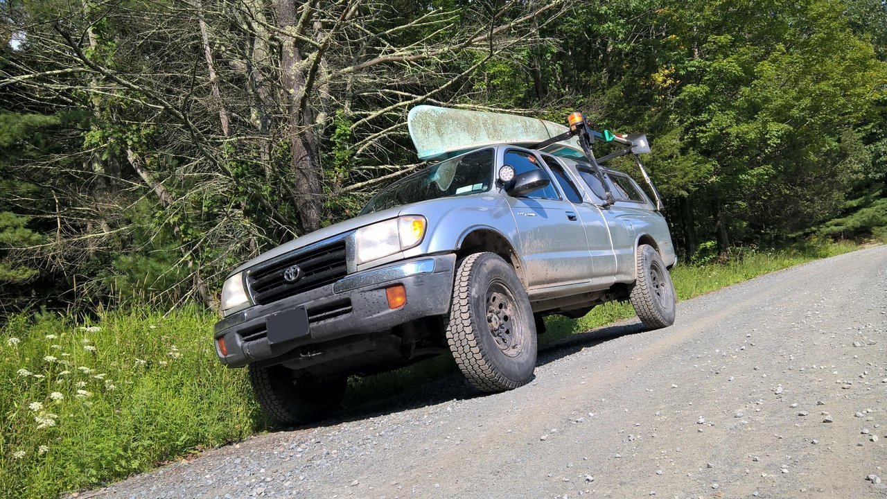

    Tried out the canoe carrying capability of the ladder rack.
    CmdrDaniels and Dalandser like this.

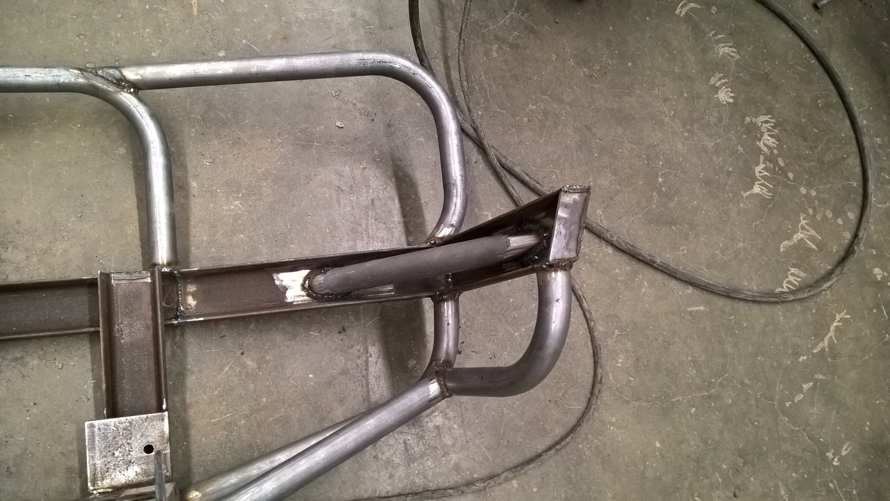

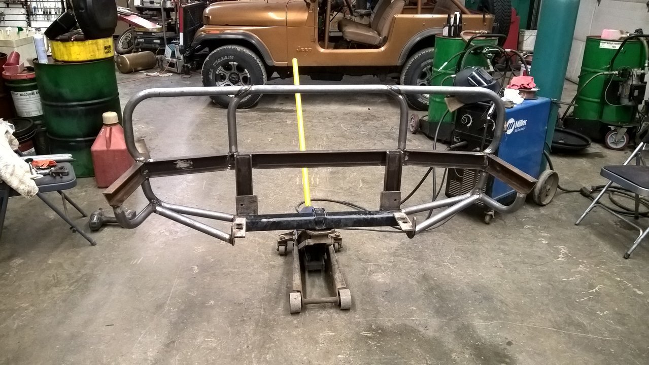

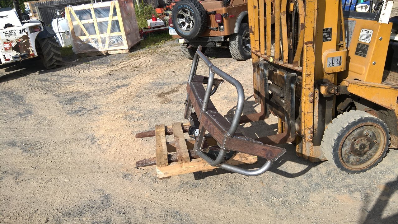

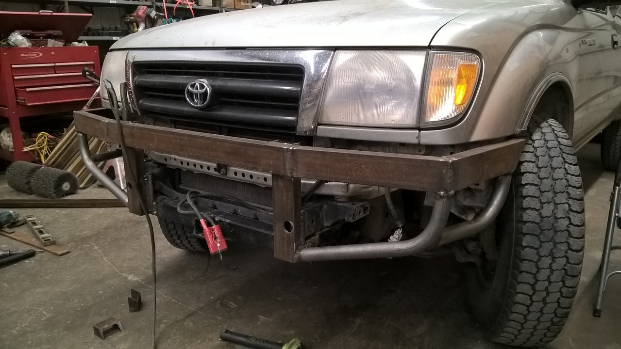

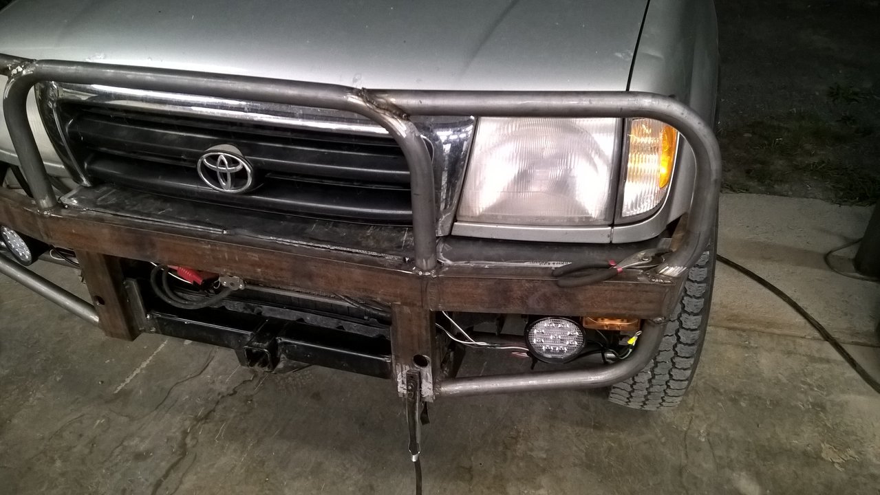

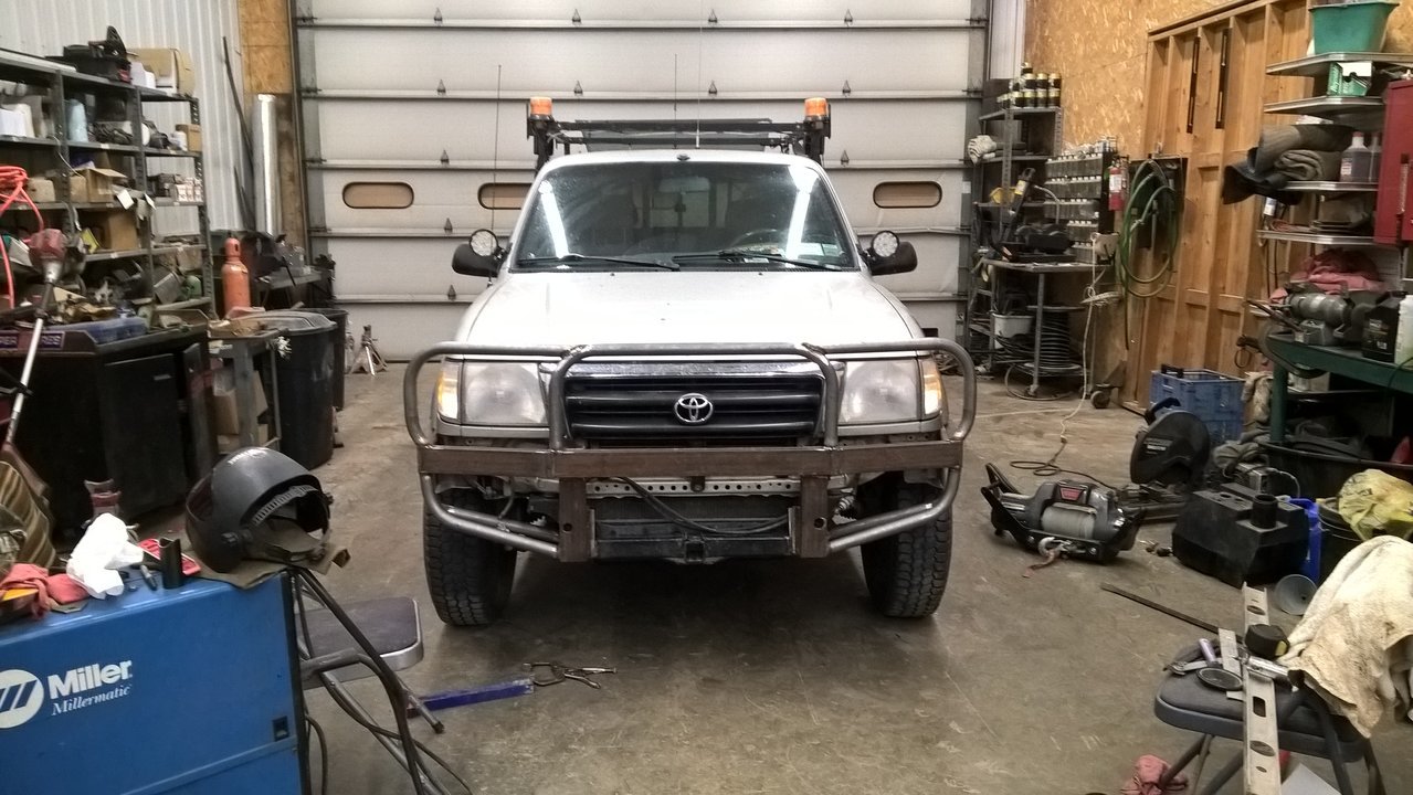

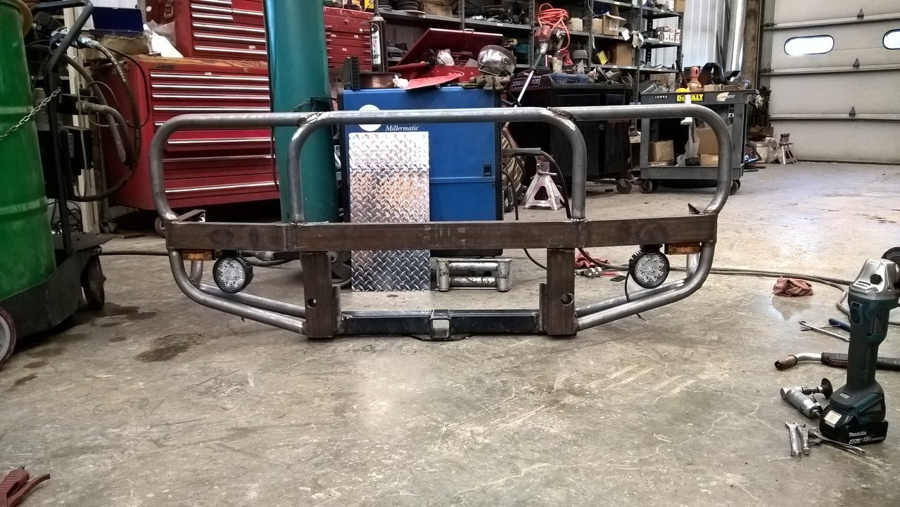

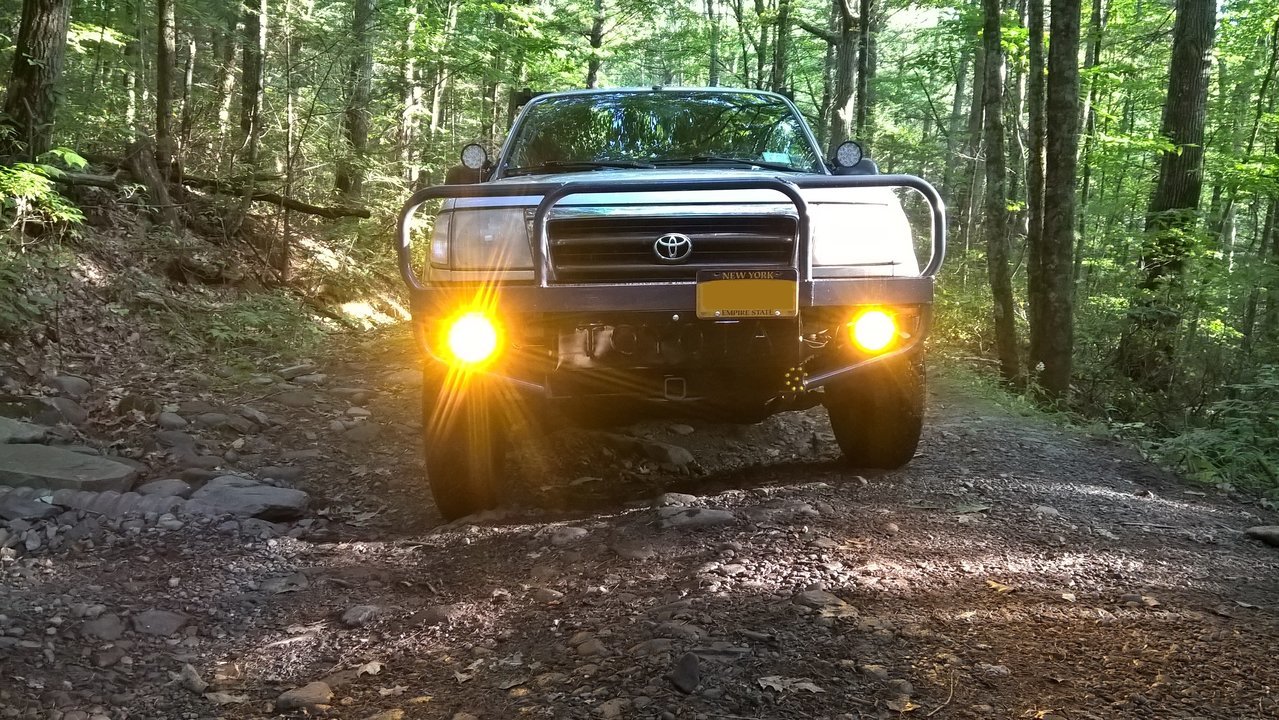

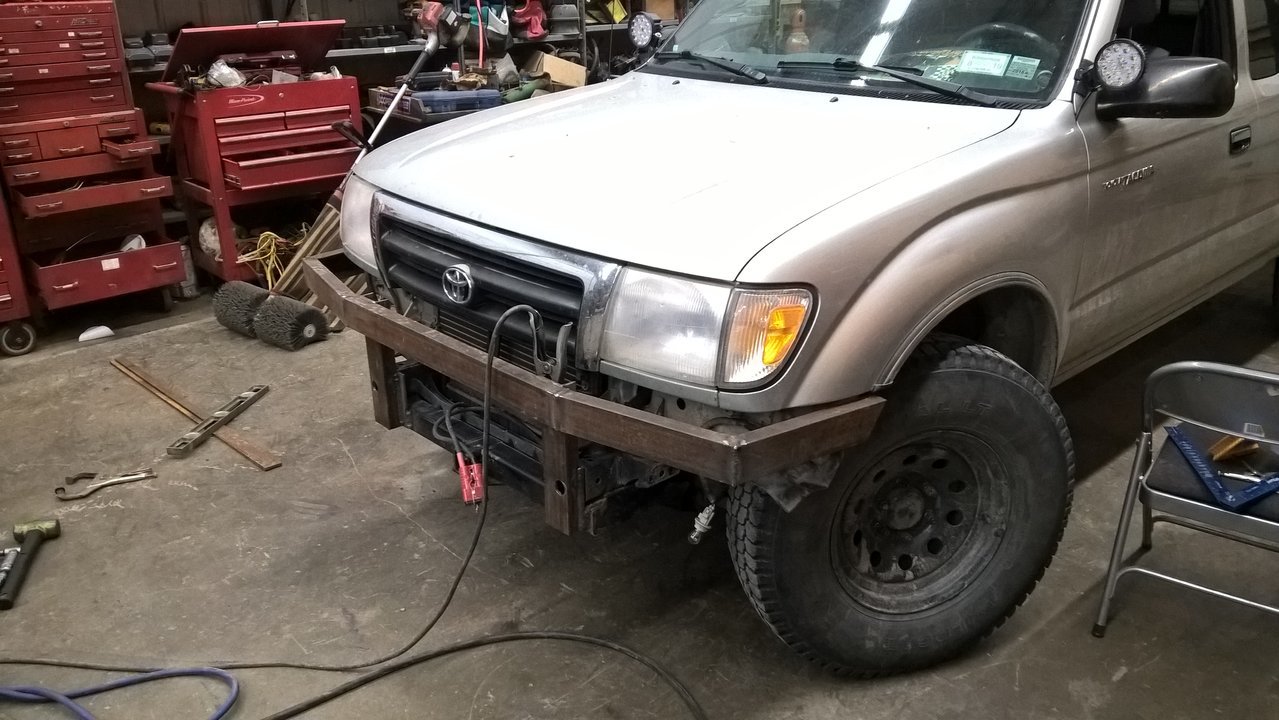

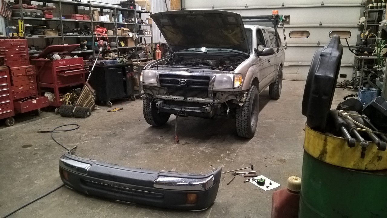

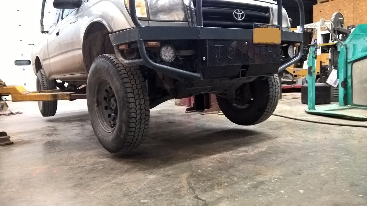

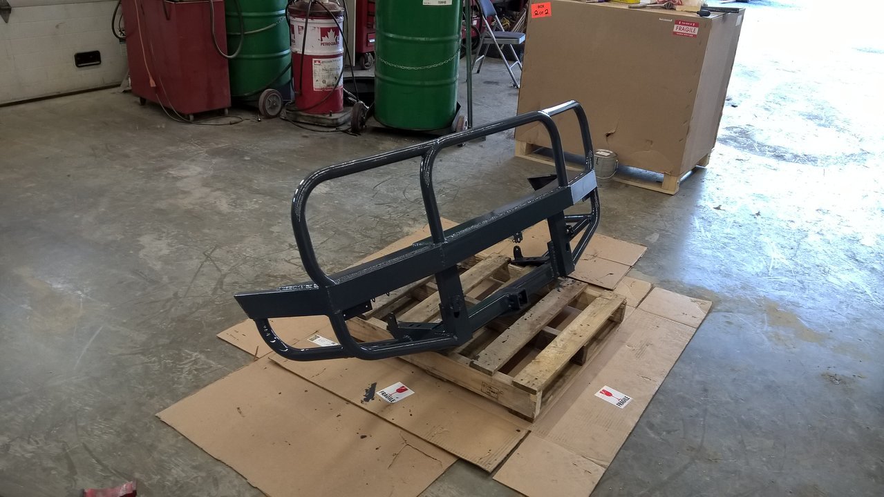

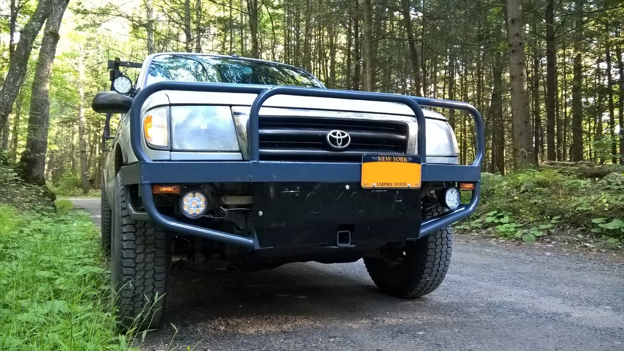

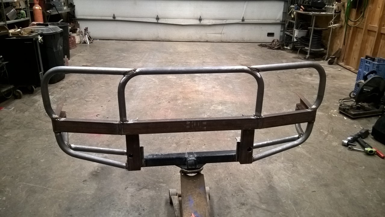

    Made a custom front bumper from some 3" wide channel, 1.5" tubing, some flat stock and 3/16 plate. Finished weight is about 120 lbs.
    Had a loose idea in my head. Started welding to the warn receiver and worked from there.

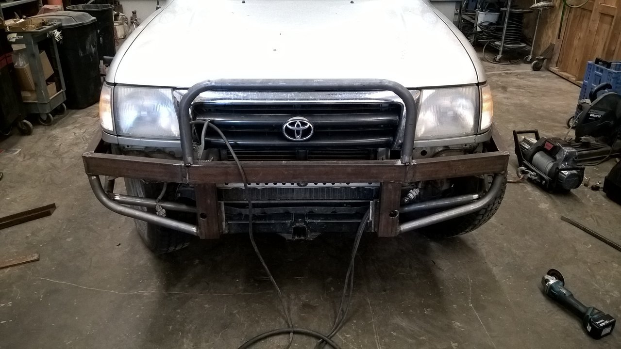

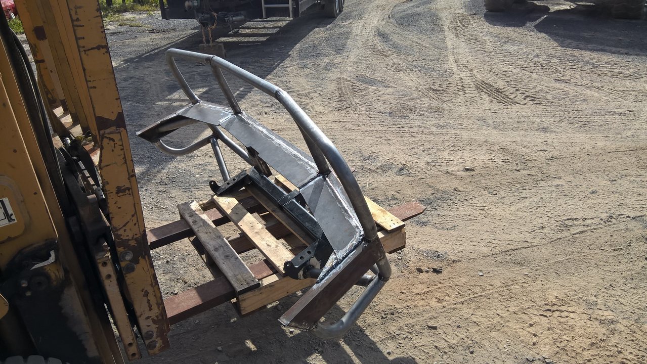

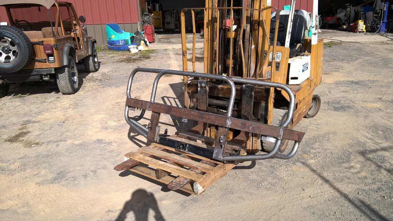

  8. Feb 15, 2018 at 8:17 PM
    MountainN22
    Jan 29, 2018
    #242878
    107
    North East
    Bracing and plating.

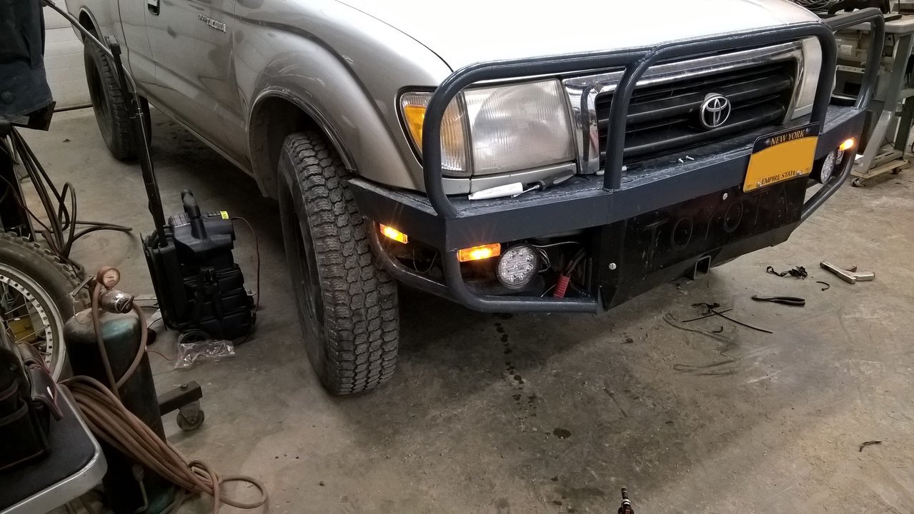

    Mounted!
    Later I added additional turn signals.

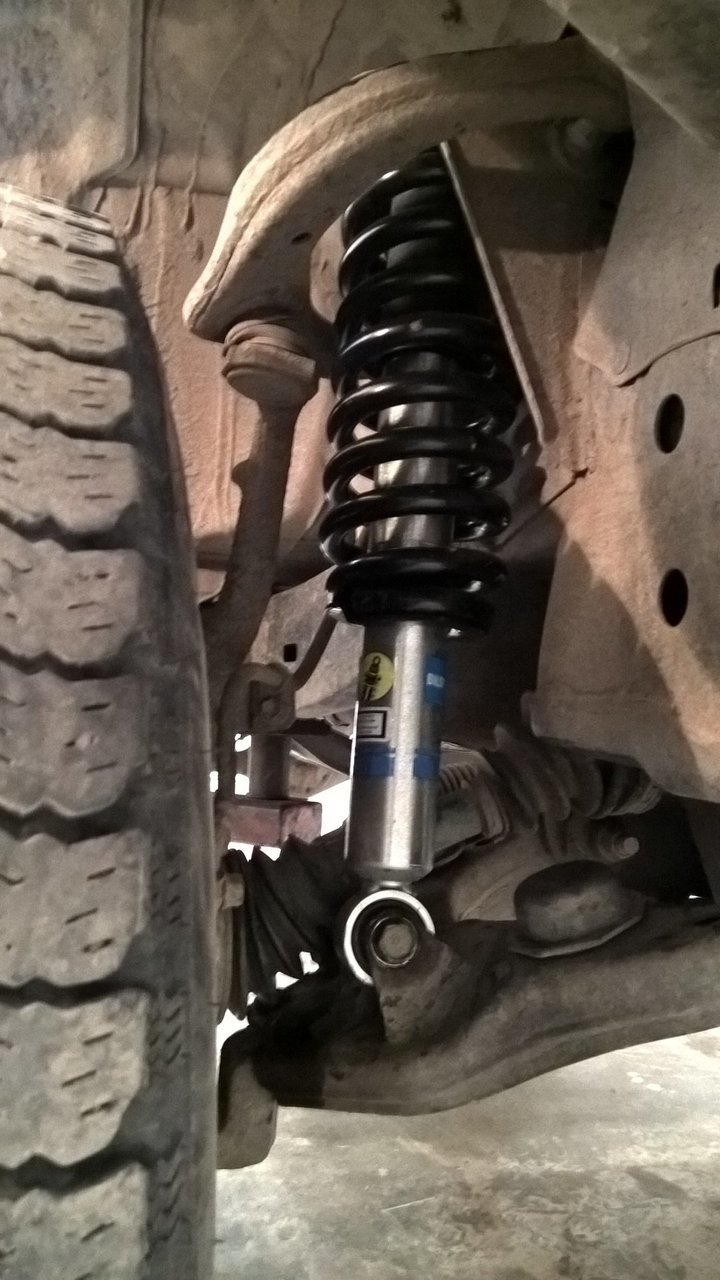

    And the tired front coilovers had trouble with the weight, so Bilsteins 5100's and heavier springs were installed.
    Clips on the bilsteins are set at the .6" lift, but I think it just compensated for the weight of the bumper.

    What springs are you running? 883's?

    Went with Moog 81104 coils.
    Didn't really want the extra lift that the 883's were advertised as giving.
    I have a flatbed in the works and enough leftover tubing to make sliders. After that my tired rear suspension will probably need attention.

  16. Feb 20, 2018 at 2:59 PM
    #16
    CmdrDaniels
    CmdrDaniels Member
    Oct 9, 2016
    #199362
    17
    Edmonton, AB
    2003 Tacoma 4x4 DCSB TRD SR5
    Really like how this bumper turned out. Looks pro .
    And I like the idea of the front-receiver mounted winch (leave it home if you dont need it).
    Mounted!
    MountainN22[OP] likes this.

    Thanks!
    I'm quite pleased with the way it came out.
    So far I'm happy with the winch.It pretty much lives in my bed.
    None of the weight up front on the highway but still there when I get stuck.

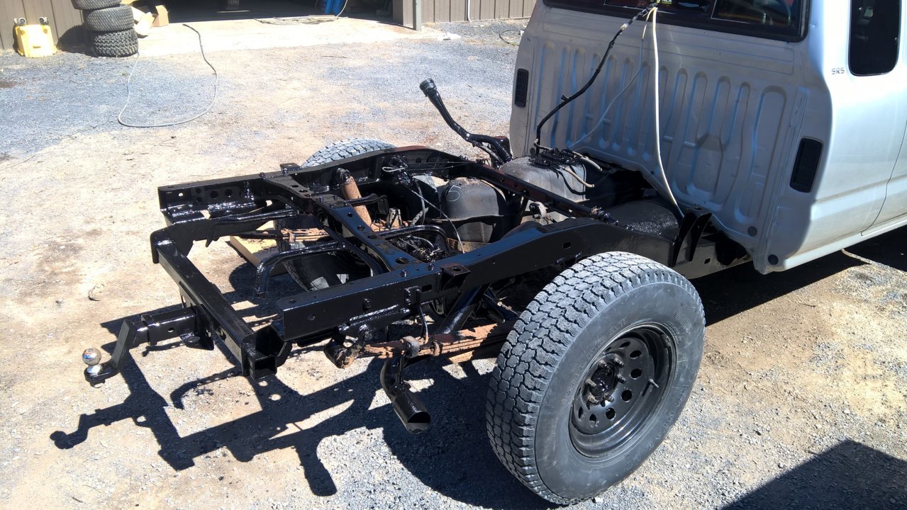

  19. May 10, 2018 at 5:13 PM
    #19
    MountainN22
    Jan 29, 2018
    #242878
    107
    North East

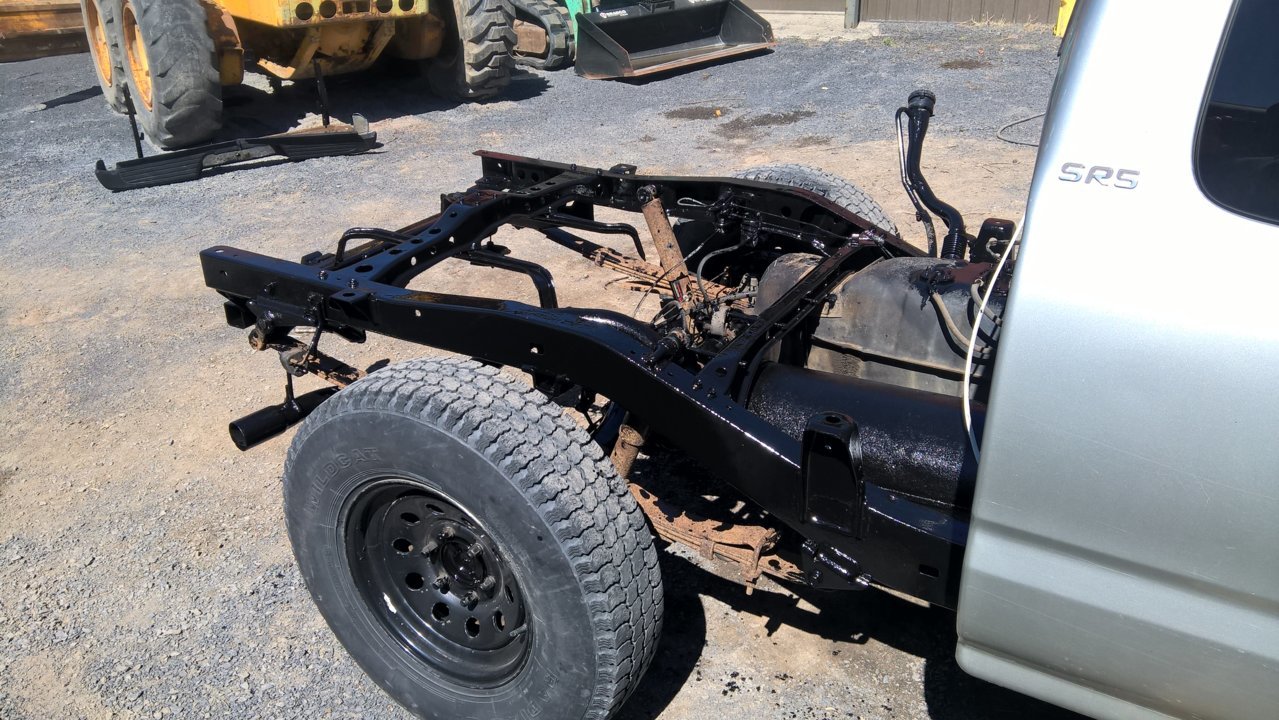

    Pulled the bed, and painted the rear part of the frame with POR15.
    Note: Try not to get paint on the muffler, it certainly gets your attention when you start trailing thick smoke down the highway as it burns off.:eek:
    Have a flatbed in the works for it, more pictures coming of that.

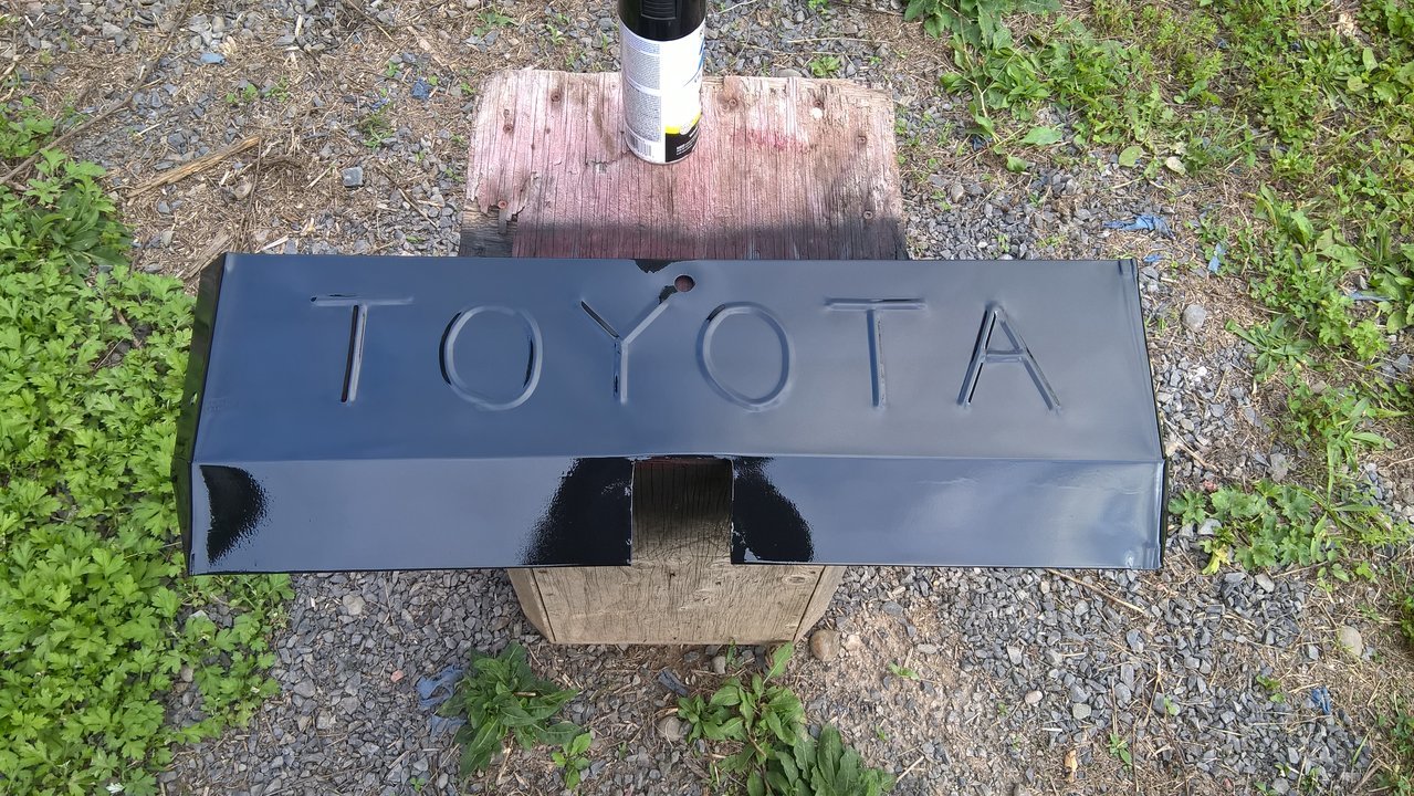

  20. May 11, 2018 at 8:01 PM
    #20
    MountainN22
    Jan 29, 2018
    #242878
    107
    North East

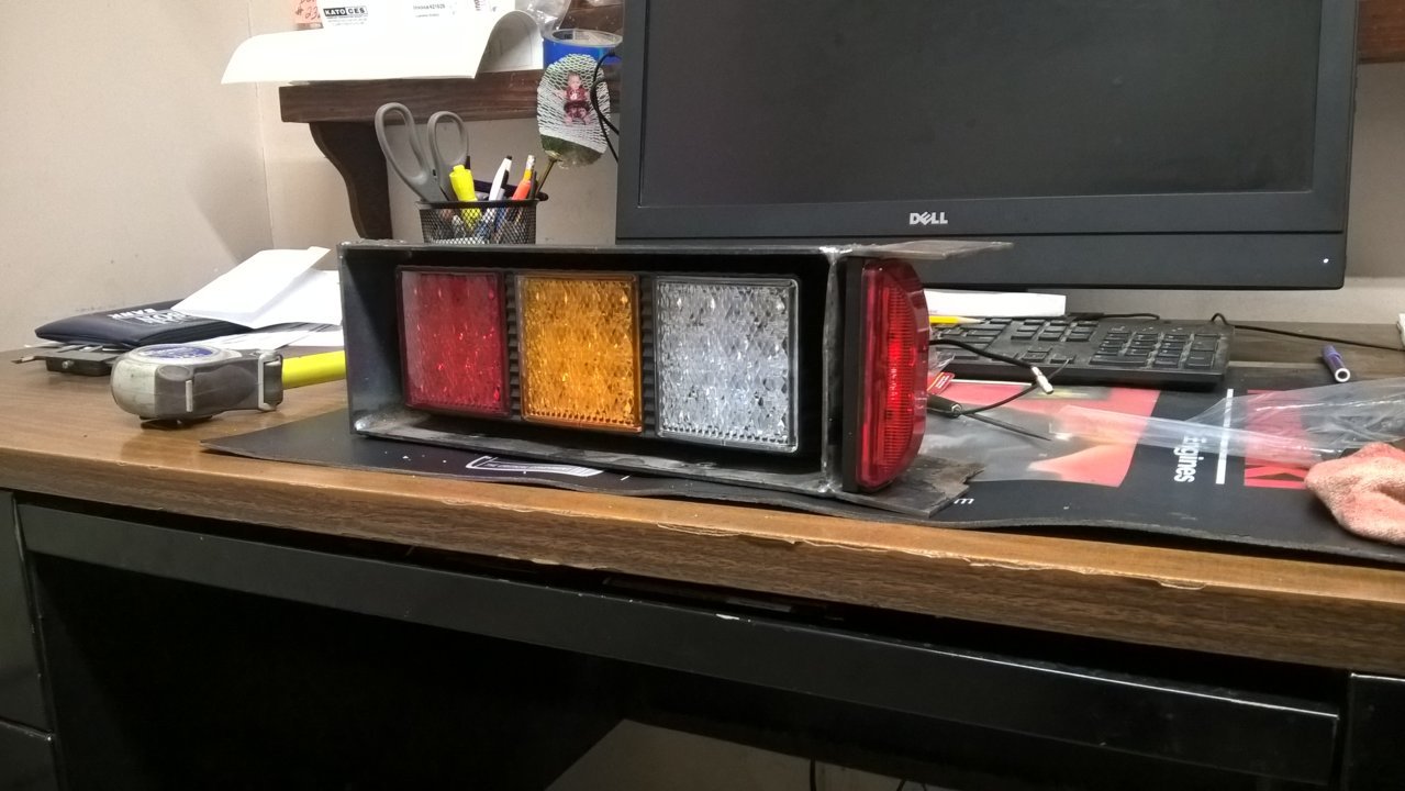

    Taillight boxes for the flatbed are ready for a coat of paint.
