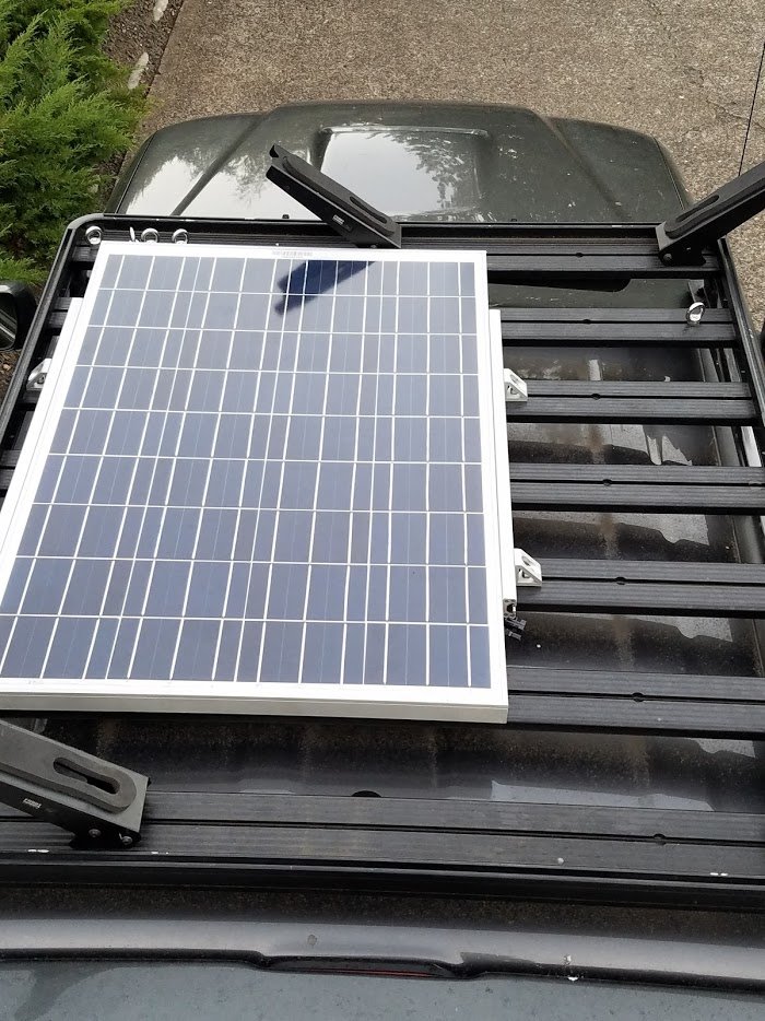

    Bilstein 5100 (front) | OME 885 springs | Bilstein 5160 (rear) | OME Dakar medium leafpack | JBA UCA | Cooper S/T Maxx 265/75 R16 | ARE Z-Series topper | Renogy 100W solar panel | SnoMaster TR42 fridge | sleeping platform | Mobtown sliders | Custom Car Grills grill insert

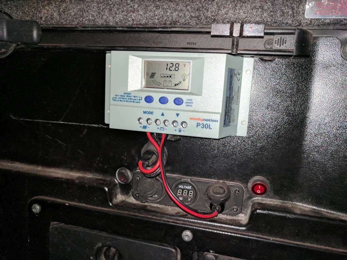

    I have a SnoMaster TR42 installed on a Dometic fridge slide that I found on Walmart.com for about $150. I installed a Renogy 100W solar panel to the OEM roof rack which goes through an MPPT solar controller, then to the factory battery. Single battery setup. Also installed a DC panel in the bed of the truck so I can plug the fridge into that. The fridge runs 24/7 set at 36 degrees. Battery is always charged. It's nice having cold beverages and such without dealing with ice. I'd say it's my favorite investment on my truck. I really need to get to taking some good photos of the install.

    I just bought and installed that panel on my truck. So far I am really happy with the Renogy panel, but I would go with just the panel and get an MPPT charge controller instead of the the one in that kit.
    Here is the one I went with: https://www.amazon.com/gp/product/B00U3MK0CI/ref=oh_aui_detailpage_o01_s02?ie=UTF8&psc=1
    Do some google searches on the difference an MPPT charge controller can make. Especially if you live in a place that doesn't get full sun all the time.
