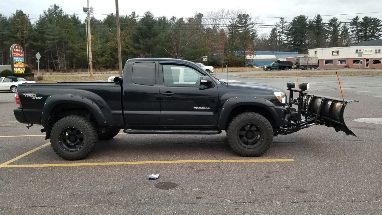

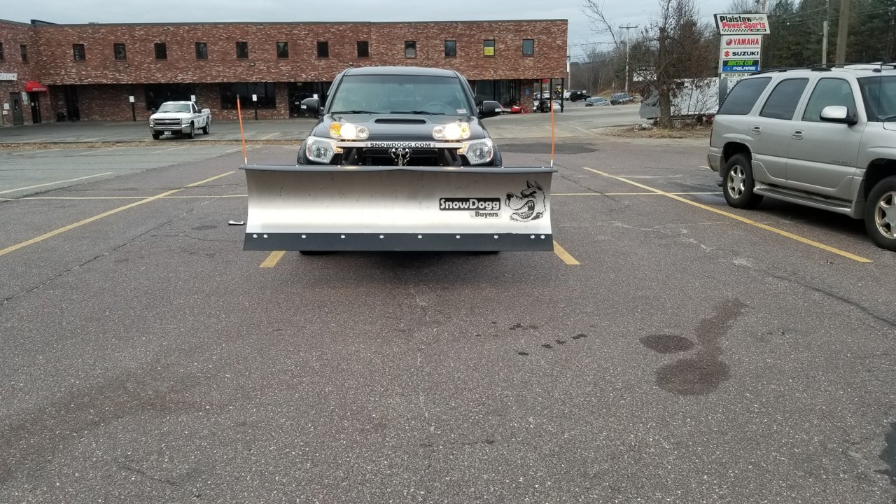

    Had this plow on my Sierra 1500 previously. Snowdogg MD75. 7.5' hydraulic stainless steel blade with electric controller in cab. Truck is 2013 Tacoma TRD sport v6 access cab with tow package. Suspension is SPC UCAs, OME 9000s and 886 springs with OME 60091s in the rear with Dakar 600# leafs. Purchased from Headstrong. 33” Cooper STT pros on 17" Mamba wheels. Bushwacker flares. Flares need more trimming to eliminate rub under load. Wanted to post so others that thought about mounting a plow can see how the front carries the weight. Their is no offsetting ballast weight for this video. Bed is empty.

    Looks like a lot of weight for an empty plow. Wait until you have a load on it and try to push into a pile and lift. I personally would find a narrower plow or narrow this one to drop the weight.
    When I built the plow for my tractor it seemed fine just lifting like you are. Once loaded I was lifting the front wheels off the ground (mounted to 3ph). Then the load slid off and I was slamming the front end back into the ground. I did some heavy mods and cut 30% of the weight and it has been awesome since.

    I'll shoot some video when it's pushing. It does 2 driveways . One is short and fat and the other is long and skinny. I plow with the blade angled on the long driveway making multiple passes to lessen the load. I like that the blade is wider than the truck. Hopefully will avoid packing snow with the tires when angled.
    Also have 500# of tube sand that goes in the back for ballast. It runs with that full time. Wanted to show the worst case drop caused by no rear weight.

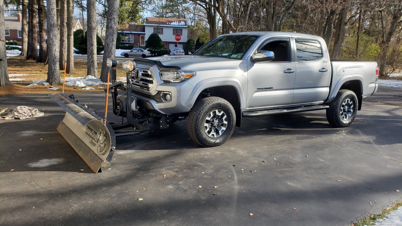

    That's a big plow for that truck. I had six foot plows on my Jeeps and I still took half blade widths in deep snow.I learned from a guy who plowed for years with Willys 4 cylinder Jeeps and never broke anything. I think you will need to plow only in low range since those taller tires will raise the gear ratio. Those Jeeps sometimes had a hard time opening up that first pass in deep or heavy wet snow. My 1970 had a 225 v6 with 4:27 gears if I recall right. My 78 was a 258 straight six with a higher rear. Your front suspension looks like it has no problem with the weight though. I had an old Western and an old Meyers plow and they were very heavy steel. Good luck with your new setup.

    A Tacoma with factory wheels needs to have a 7'0" minimum. If you go shorter than that, it will not clear the wheels. Most plow manufacturers still skip from 6'6" to 7'6". There may also be an issue with OP's setup since his wheels are bigger.
    I have a 7'0" on mine, but looks like 7'6" is the sweet spot for OP.
