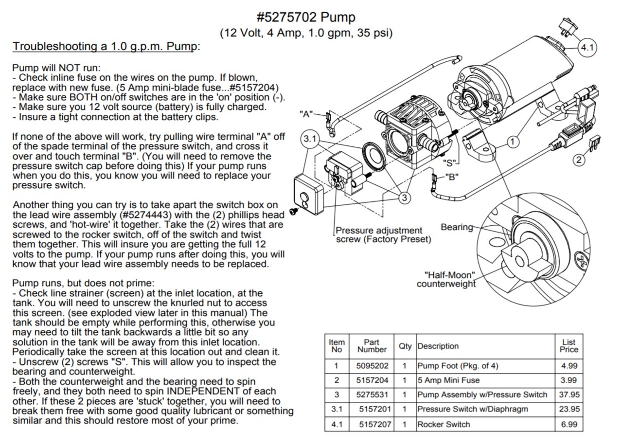

    looking on the tractor & supply tank I found the manual and it list the pump as a replacement part! Actually cheaper than the price of the group buy on demand pump.

    I'm on the FIMCO site and their lowest volume pump is 1GPM, it's pressure activated and looks to be the ticket.
