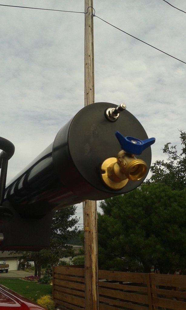

    Yep. Made it today.
    Used a flanged spigot, allowed me to put a rubber gasket on it.

    I just did it for the off chance that it might try to leak past the threads.

    I made mine last night with the same parts you did. I tested it today and I was getting an air leak on the Clean out Plug. Did you use something to make a better seal? I tightened mine down so tight that I had to struggle to get it off and I was still getting an air leak.

    Thread tape will seal it.
