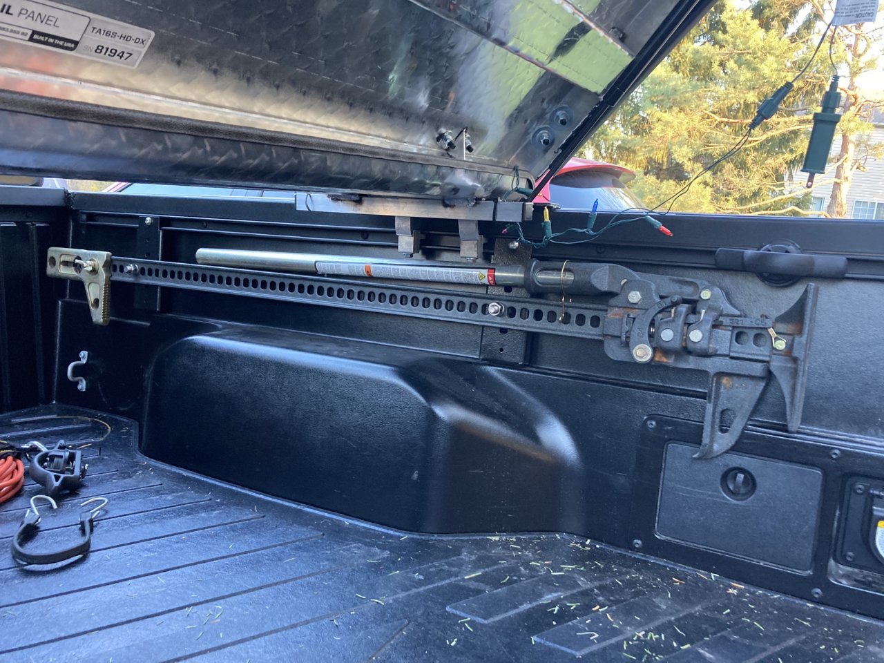

    Just thought I would share what I mounted and how for future reference to others. Nothing here is revolutionary, but it could help answer questions about "will it fit with ____".

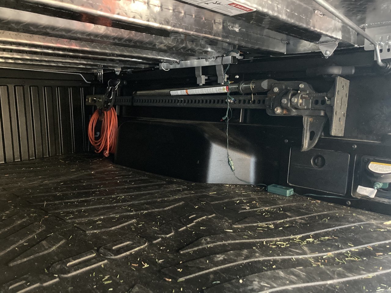

    First off is high lift extreme 60" using BAMF (@JLee) bed rail brackets and stainless steel bolts:

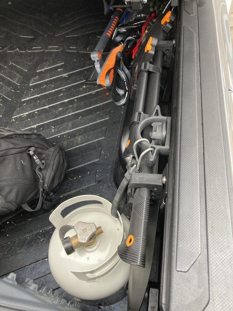

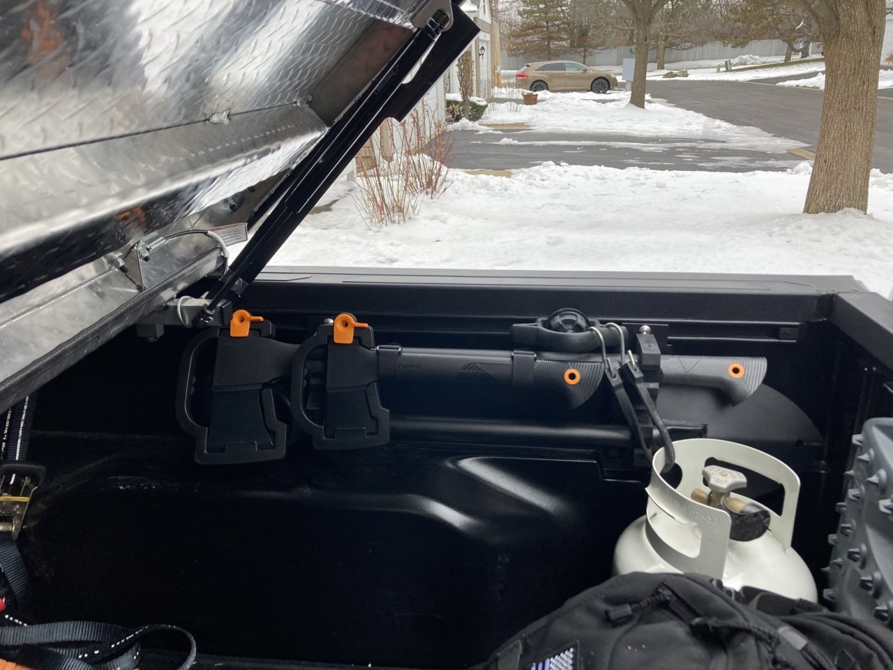

    Next is Fiskars 28" chopping axe, Fiskars 14" hatchet and Bully Tools 92712 trunk shovel using another set of BAMF bed rail brackets and Quick fists:

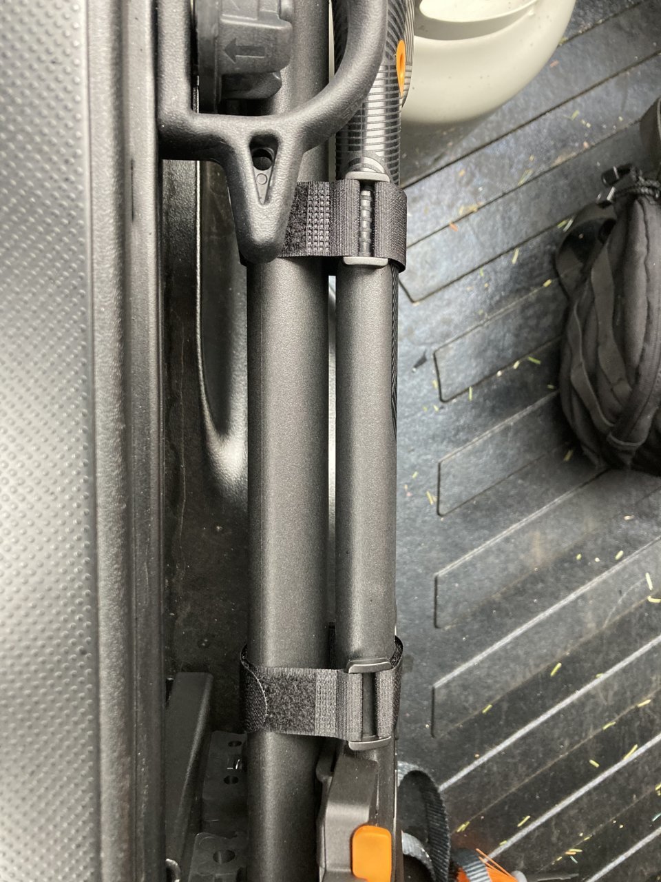

    The 14" hatchet is strapped to the 28" axe using these hook and loop straps: https://smile.amazon.com/gp/product/B0798L21FG/ref=ppx_yo_dt_b_asin_title_o09_s00?ie=UTF8&psc=1

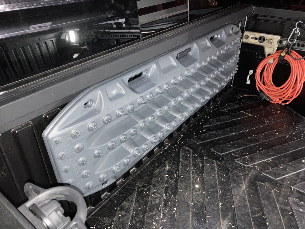

    Lastly, MAXTRAX MKII mounted using @supralee 2x mount:

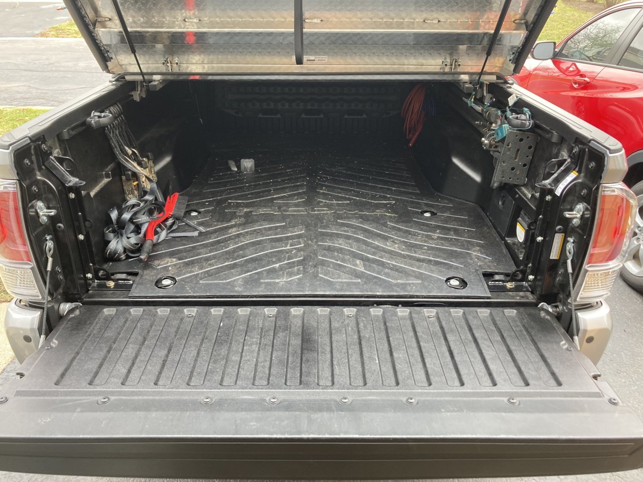

    All of this fits very snugly under a Diamondback HD cover and I'm very happy with it. I use my bed to haul 8' lumber regularly so it was important to me that everything is mounted in such a way as to not interfere. I didn't want anything bulky in the back of the bed near the cab because that would force the lumber to stick out further and I didn't want the stuff along the sides to stick in further than the wheel wells. The Maxtrax adds about 3" to how far the 8' lumber sticks out but I am ok with this as there is only about 5" of the boards sticking out now.
    I guess as long as I'm on the topic of the bed, I also added total chaos bed stiffeners (thanks again @jaydemSR5) and added d rings to the 6 bed bolts for additional tie down points. I cut holes in the oem bed mat around the d rings.
    d rings used: https://smile.amazon.com/gp/product/B01CGXSOG0/ref=ppx_yo_dt_b_asin_title_o01_s00?ie=UTF8&psc=1
    A note on the d rings: The hole needs to be drilled slightly larger as the bed bolts are a larger diameter. It's not really difficult to drill them out but you should know it's necessary in advance. Also, the bed bolts require a T-55 torx bit.

    Everything looks nice and tidy!
    Love it!
