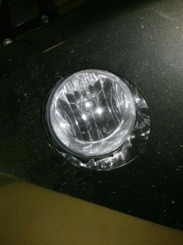

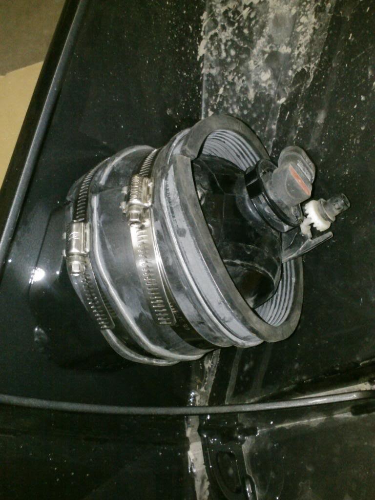

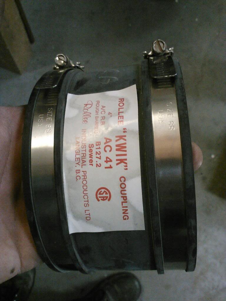

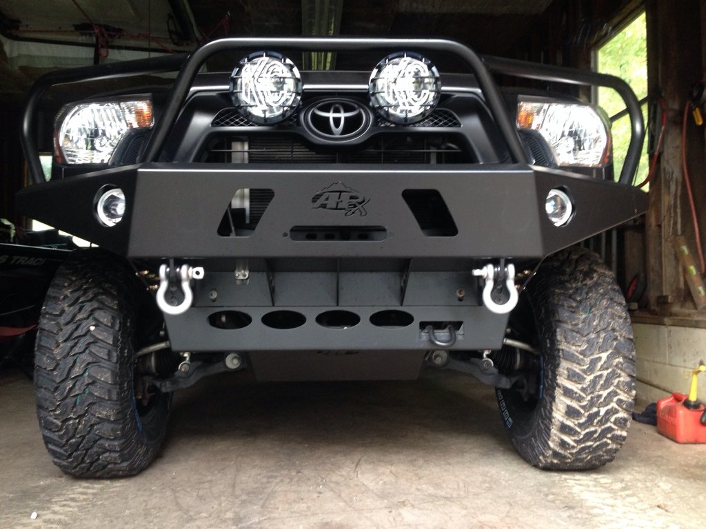

    While looking around on this site I could find very little on how I could continue to use my stock fog lights in an All Pro Apex bumper. So after looking around through a hardware store I came up with this.

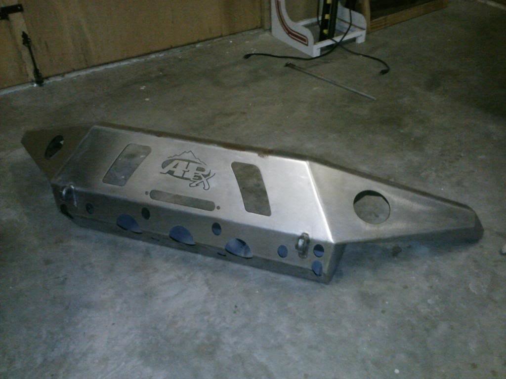

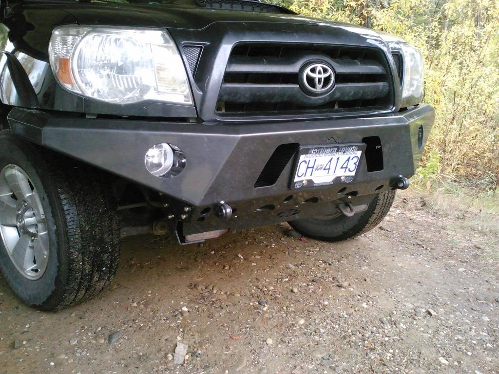

    Welcome to TW and and nice job! Any pics of the whole bumper? Curious because I have the same bumper on its way :D

    I had it powdercoated locally to better match the colour of the truck. Also, our winter roads are pretty rough on finishes so I needed a better quality powdercoating job than what would be done in California. My only mistake while installing it is I should have sprayed all of the existing bolts with some liquid wrench a few days before I began as the threads were all badly corroded. In one case I actually broke the weld on a nut that was welded to the frame while trying to get the bolt out.

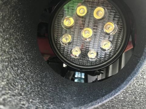

    So I have an Allpro steel bumper and wanted to put my OEM fogs in the cutouts but no dice. Bought the 4" Tuff LED from Amazon 1/2" to big Now What?

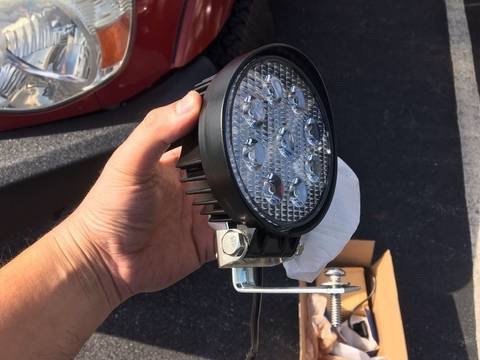

    Here is how I mounted my Amazon LED fog lights in my eBay bumper! Hope this help!
