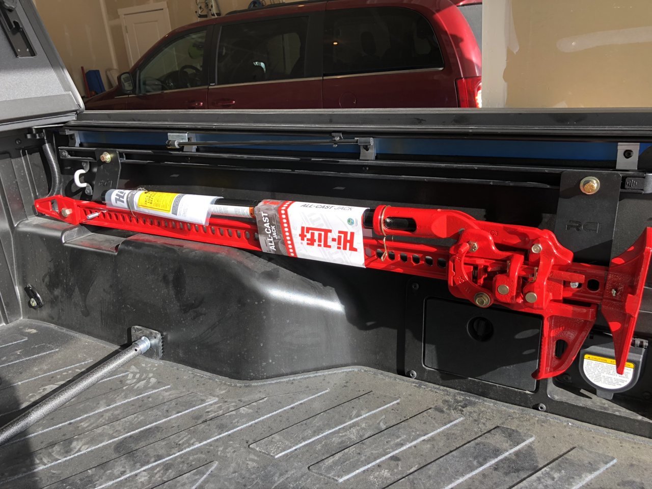

    Yeah actually. The RCI bed rails work fine as long as you position them in the slots in the wheel wells (the ones that fit 2x4s). Here is a pic.

    awesome! what length hi lift is that? 48"?

    Yes. I have a short bed, so the 48" rests perfectly within the bed. I really like that it rests on the wheel well. Feels like it has extra support that way.
    As you can probably see this doesn't actually have the wing nuts on because I was just test fitting. I haven't actually attempted this again yet, but I believe to make it work you'll have to slide the jack handle towards the top of the jack to give it some clearance for the wing nut. It will still be tight since the "bottom" bolt is only in the second hole and rather close to the base. Worst case, I think you could just replace the wing nut with some other type of nut, or grind the wings down a bit. If I get a chance I'll do a proper test fit.

    Sweet man. I was thinking of ordering the 60” and cutting it a little bit I ended up ordering a 48” and am gonna attempt to build my own mounts.
    hoping it comes out clean and nests nicely under the bakflip.

    Do the mounts fit flush against the bed?, I am curious if it sits solid against the bedside or vibrates off of it.

    It feels flush. But honestly I haven’t taken it out because of COVID.
