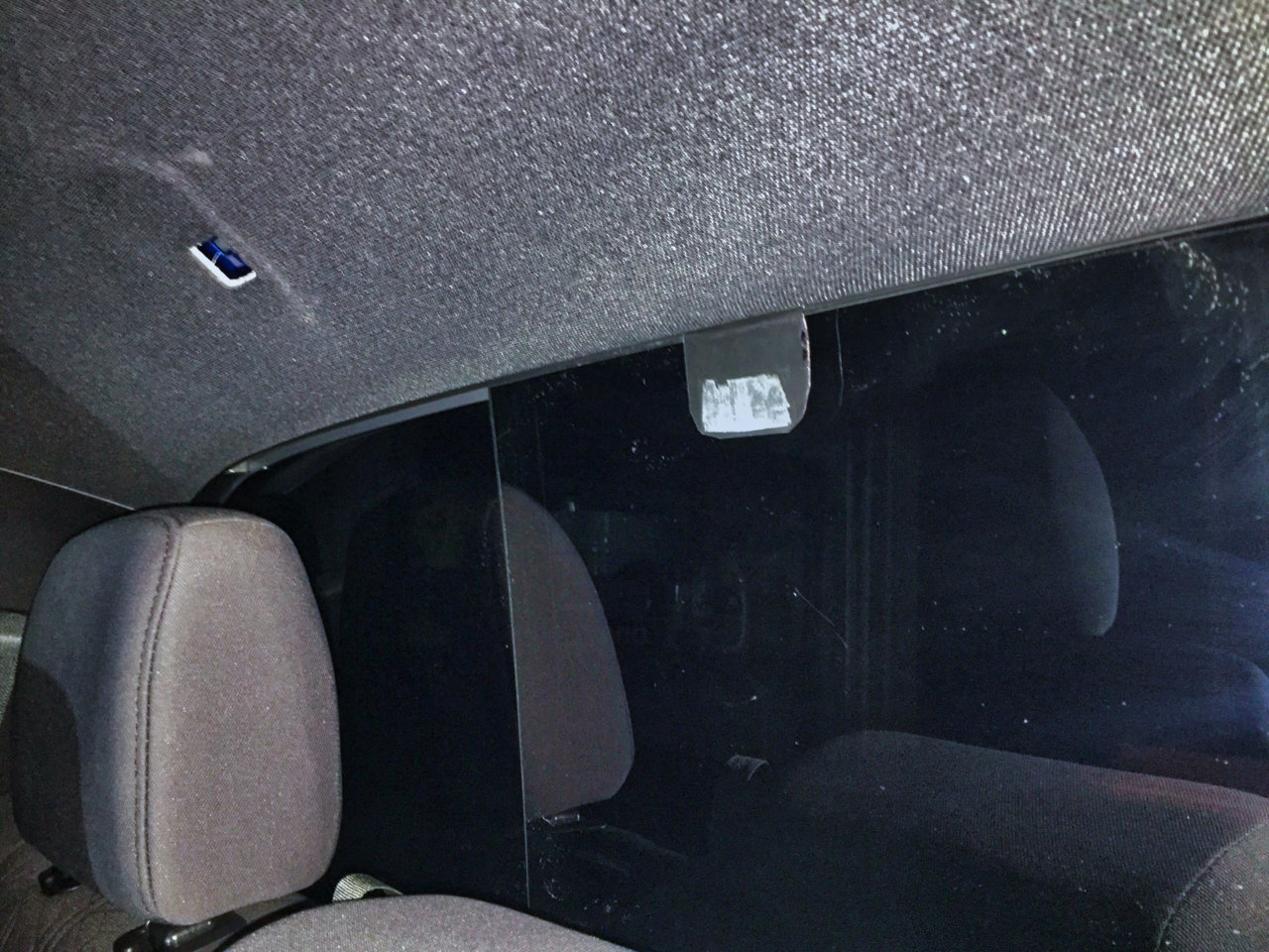

    Get a small/thin piece of roof flange from Home Depot ( roofing material ), cut it down to a size you need, kinda sorta shape it to fit the contour of your roof, put some automotive double sided tape on it, squeeze it between the headliner and the roof, then stick the tape to the roof as best you can. When you re-attach the headliner, it will help jam the flange into place, keeping it secure.
    A few notes on my experience...
    1) Do several test fits with the bracket ( without the tape attached ) to get as close to the roof contour as you can. I pulled the headliner down a bit to be able to feel what contour I needed.
    2) Make sure that when you cut the flange down to size as a usable bracket, you leave enough sticking out below the headliner to be able to attach the rear camera.
    3) Paint the bracket flat black so that it kinda/sorta blends into the rear, but leave the spot that will attach to your camera unpainted so the camera can attach better.
    Here's a photo of mine without the camera attached.

    My rear sliding glass is tinted too, which is why made a DIY bracket.

    Oh, and another recommendation. Whenever you're working on that bracket ( test fitting, etc. ), make sure to have that center glass slid open. That way, you reduce a risk of scratching the tint.

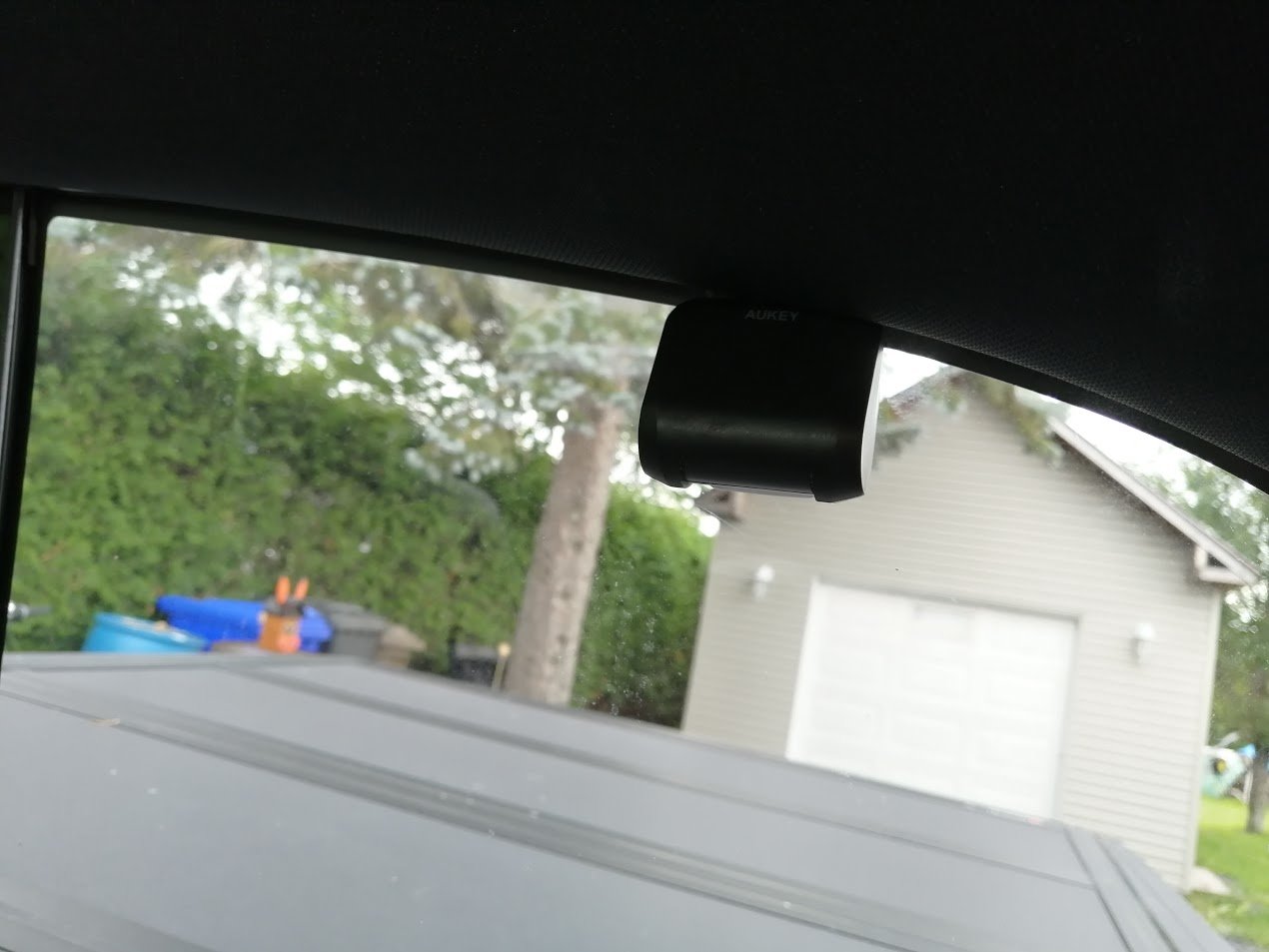

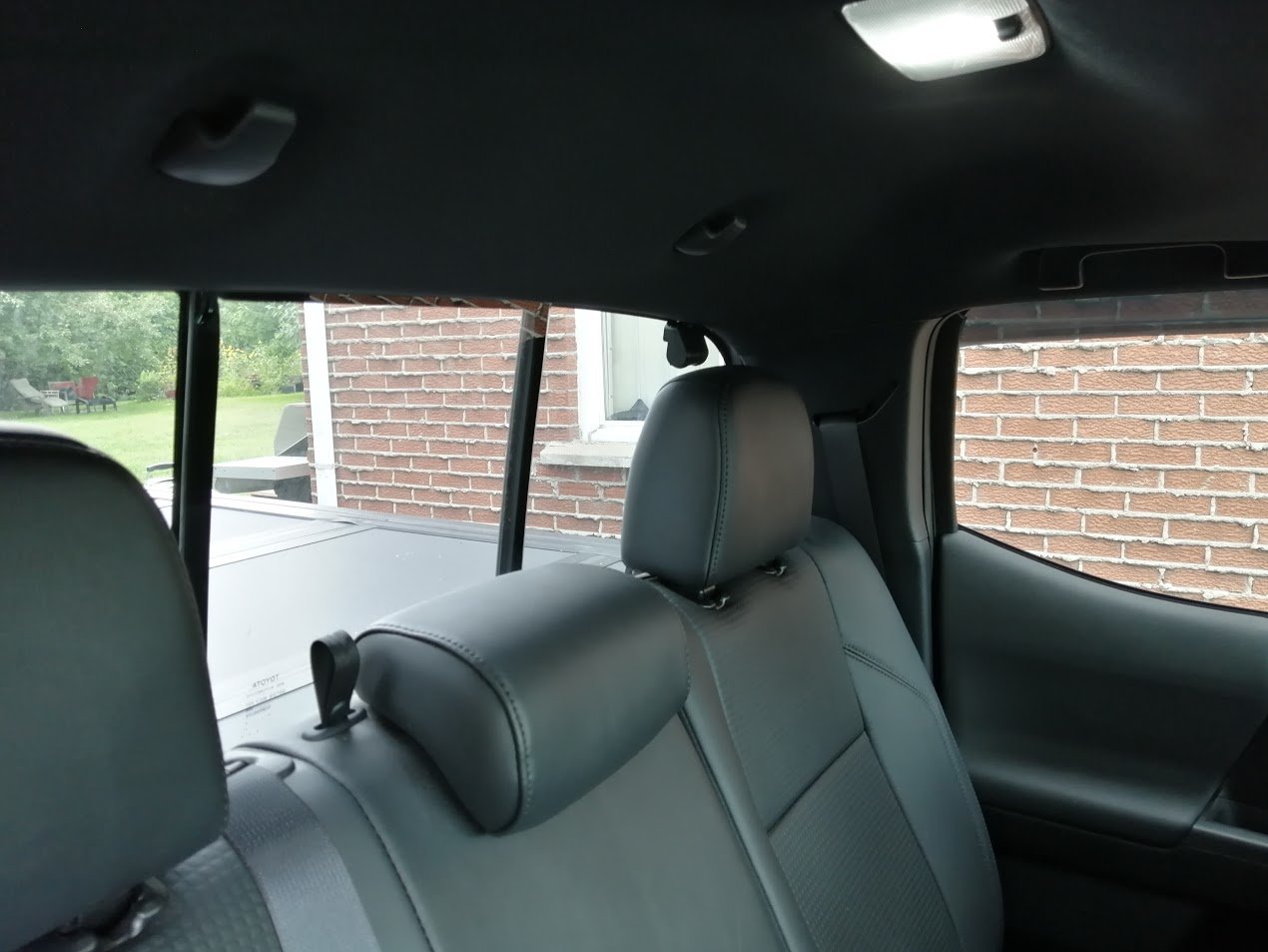

    Here's mine, it's not centered but I didn't want to see it when I'm driving. Camera is a Aukey DR02D.
