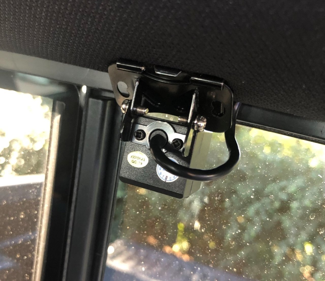

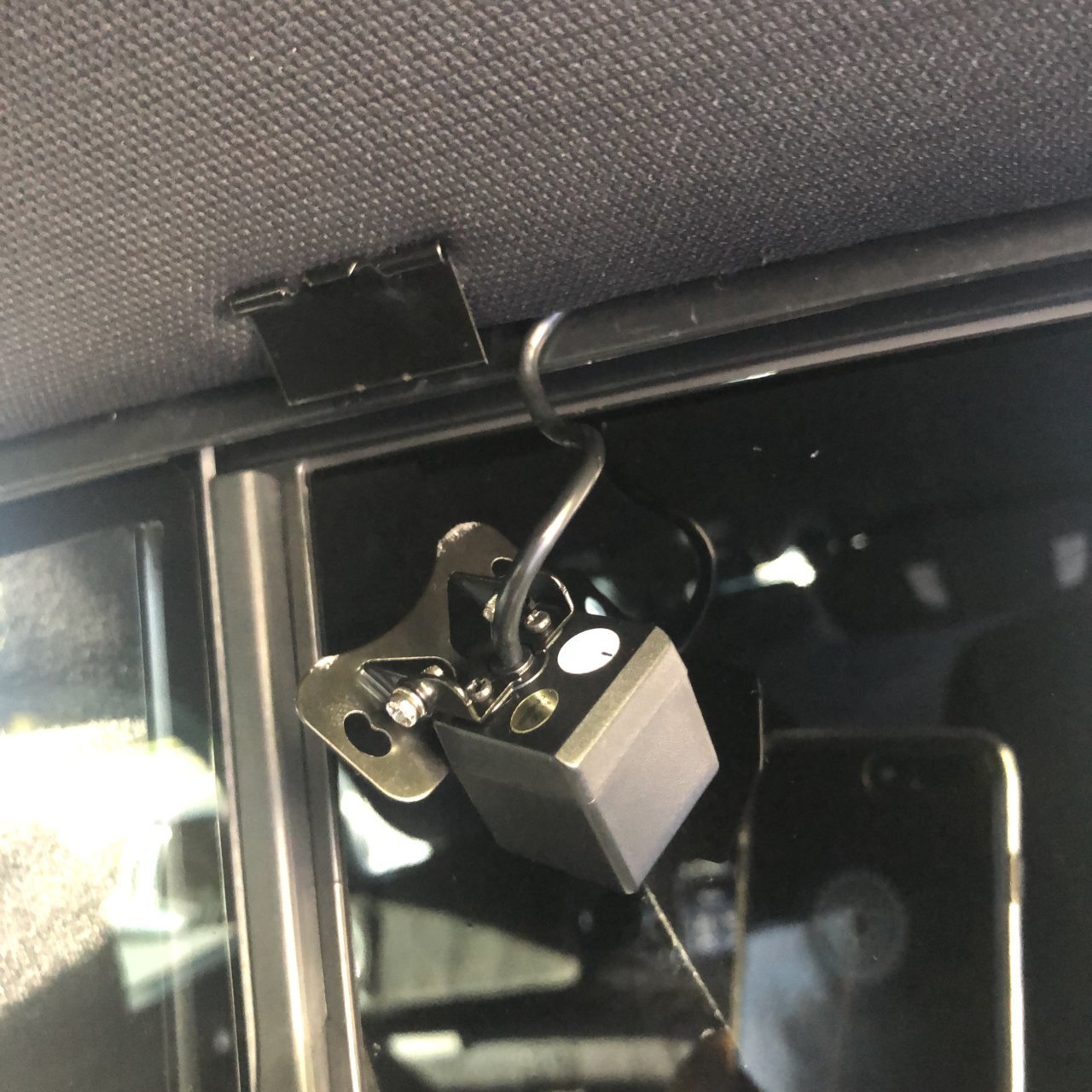

    Here's how i mounted mine with a binder clip... It's just to the right of the sliding glass window on my Access Cab.
    The mounting plate for the tiny camera fits snugly into the area that is curled around and the lens is up against the glass.
    I could glue it to make it even more secure but it seems to be pretty bombproof just the way it is.
    If you find yours is loose, just pinch it a bit with some plyers or just use double sided tape, hot glue, epoxy, etc...
    I like it because if I want to change the camera location I can do it on the fly or even take it through the window if I want and point it in any direction.
    I also imagine, depending on the size of the clip, you could mount something much bigger if you need to.
