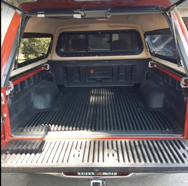

    Here’s how mine attached. The guy who bought it from me put it on his 2nd gen and all we needed to do was buy longer bolts for the clamps. It looked like shit but he seemed happy

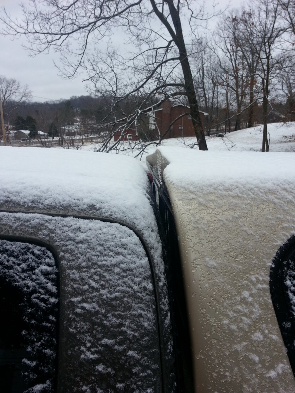

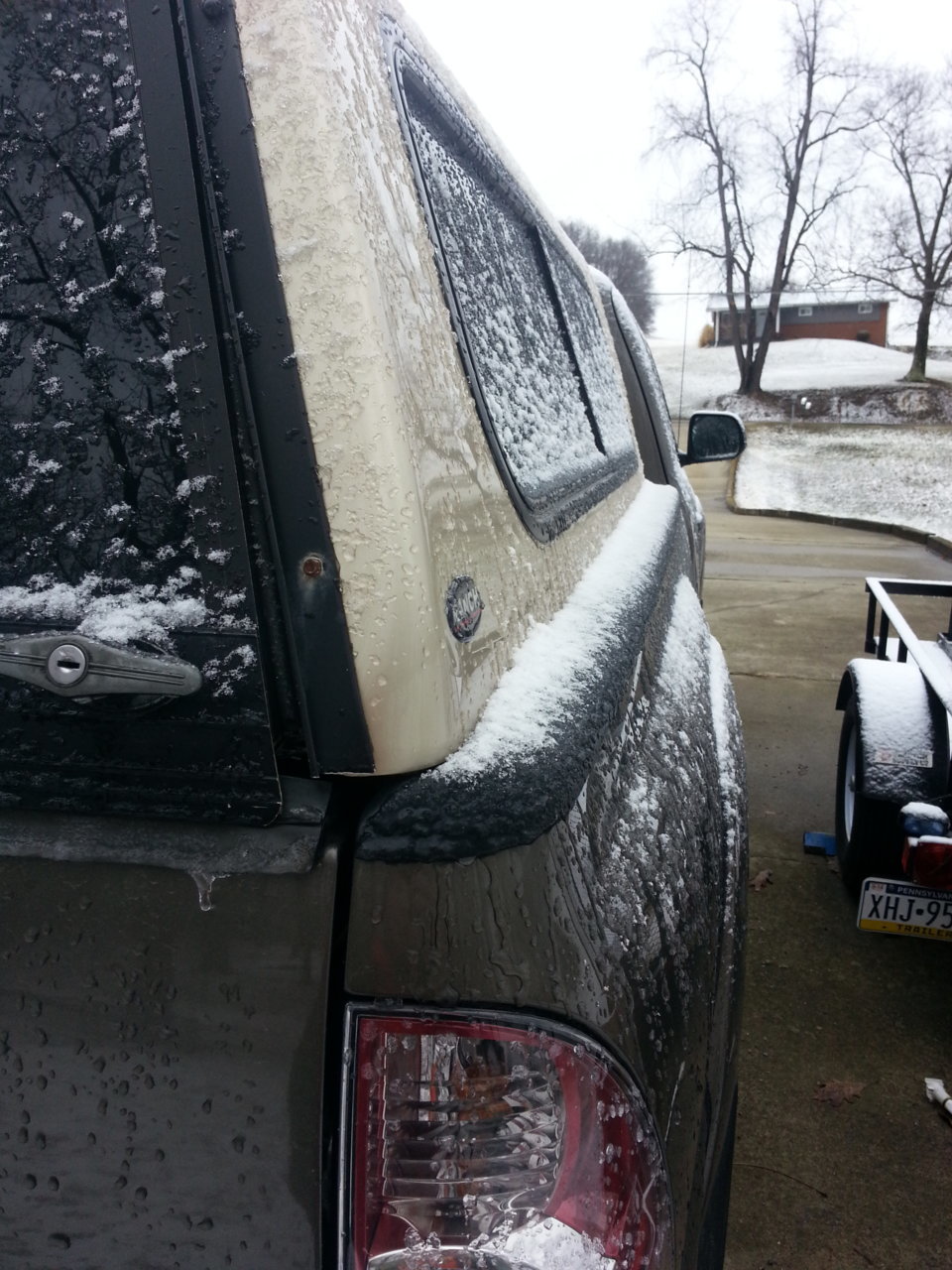

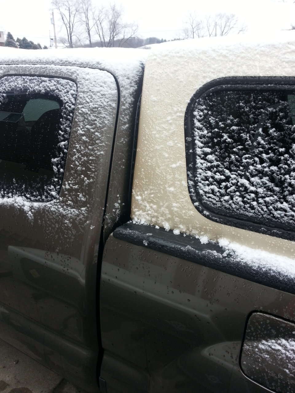

    here a few pics of first on 2nd Gen to see some difference
