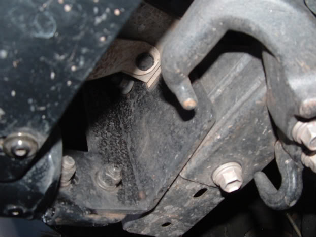

    This is the best I could do. This is the right side looking up. The two bolts on the bottom of the photo connect the bull bar to the bracket. Notice that the bolt in the middle/right of the photo that is black. That is an original bolt from the frame and is used in the installation. Good Luck, Don2010_1115Bullbar0017_7832921efa3b652ccd652ae03142adc83551a3f4.jpg

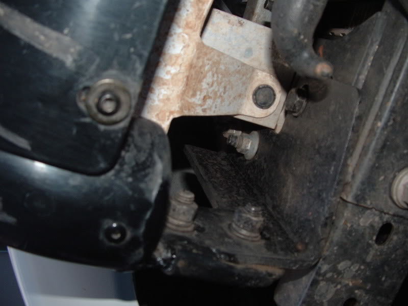

    Here's another shot. To get the bracket in place and bolted is no easy task. However, once the one side is done then you know what you're doing and the other side is easier. Don2010_1115Bullbar0016-1_d4944b171fe1241b2ad1f45ae724e620a749d179.jpg

    Thanks so much, that helps a lot... I thought I had the wrong brackets but now I see I do have the right ones and how to bolt them on. Thanks again!
