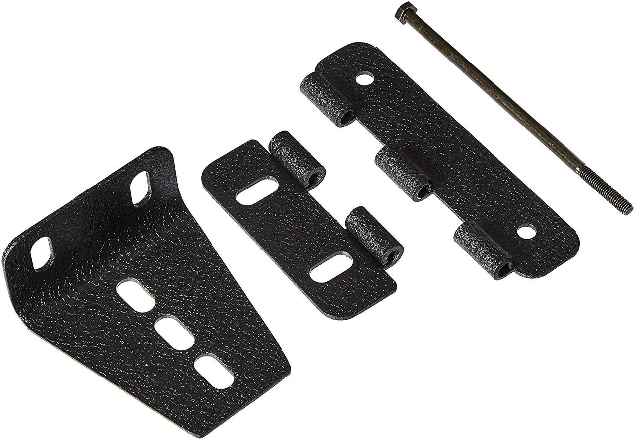

    In this post I will cover a mounting foot alternative for the TopRac. Why would I want different legs you ask? Because I wasn't comfortable with this and the guidance just to stack washers to correct:
    This seemed both hokey (for a rack this nice) and dangerous (for any rack supporting a lot of weight). The issue is the supplied Prinsu feet do not take into account the sloping roofs on a cap. My solution - the Smittybilt AM-4 Adjust-A-Mount Mounting Brackets:
    https://www.amazon.com/Smittybilt-AM-4-Mounting-Bracket/dp/B00AQFE8BG/ref=cm_wl_huc_item
    These feet are fully adjustable for the slop of the roof and give you the exact angle you need and work PERFECT. The height comes within 1/4" of the CabRac and with a small modification can be made to come within 1/8". Below are some pictures of them installed:
    Here is where you'd want to make a cut to allow you to get the height to within 1/8" of the CabRac. Mask off the line you want to cut, use a cutting wheel to make the cut and then hit it with some Rustolium Bedliner spray paint. This is exactly what I did. It should be noted that the Prinsu legs were also not perfectly even with the CabRac and the TopRac on my SnugTop. The naked eye won't even see either the 1/4" or 1/8" difference:

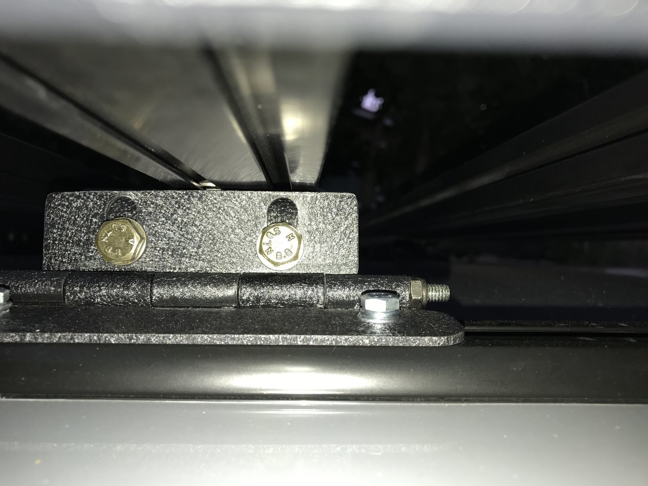

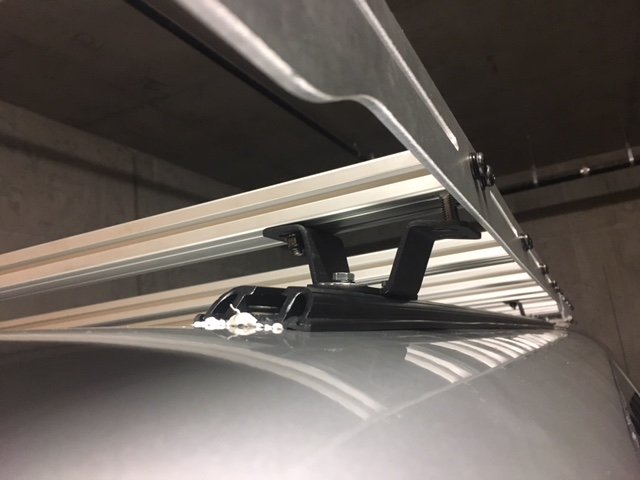

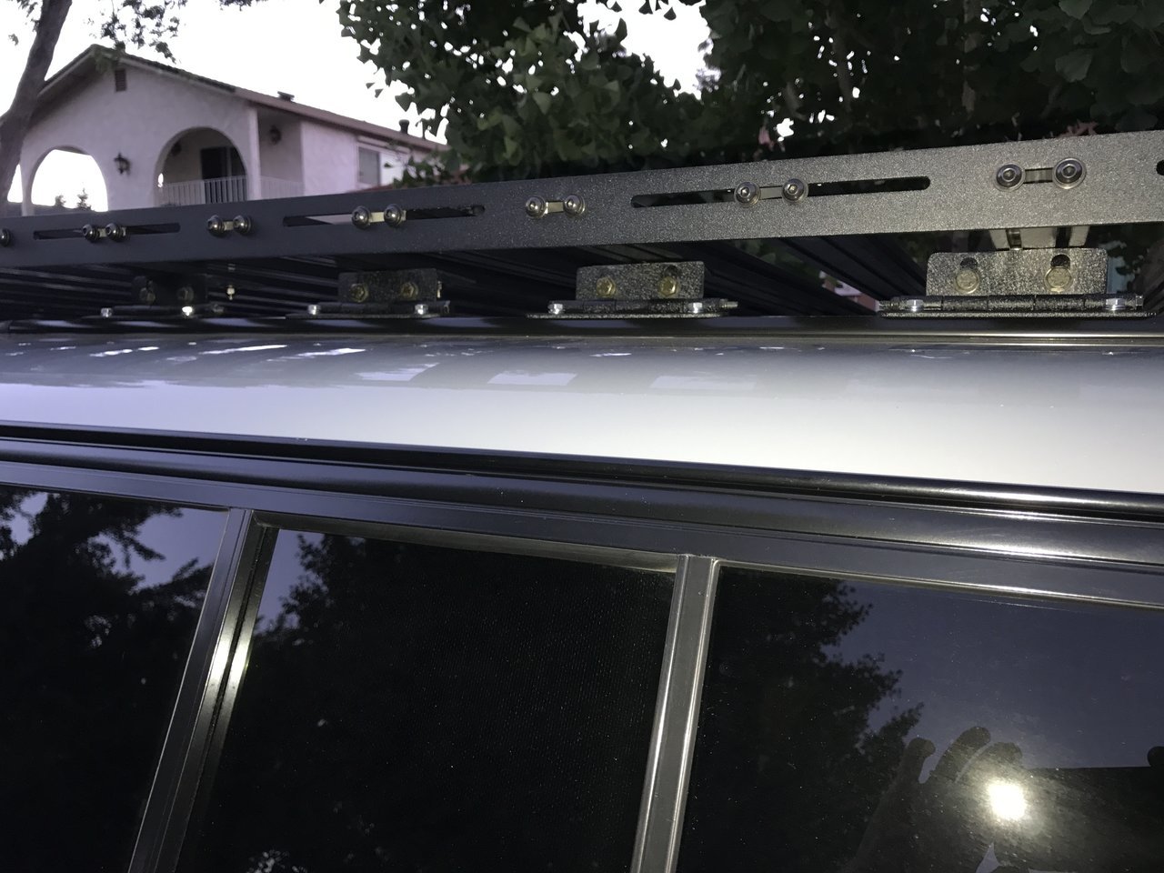

    Here are some additional pictures showing the post cut to the mount mentioned above as well as showing the ability to mount four feet per side for extra rack strength:
    And you see here I put 4 on each side:

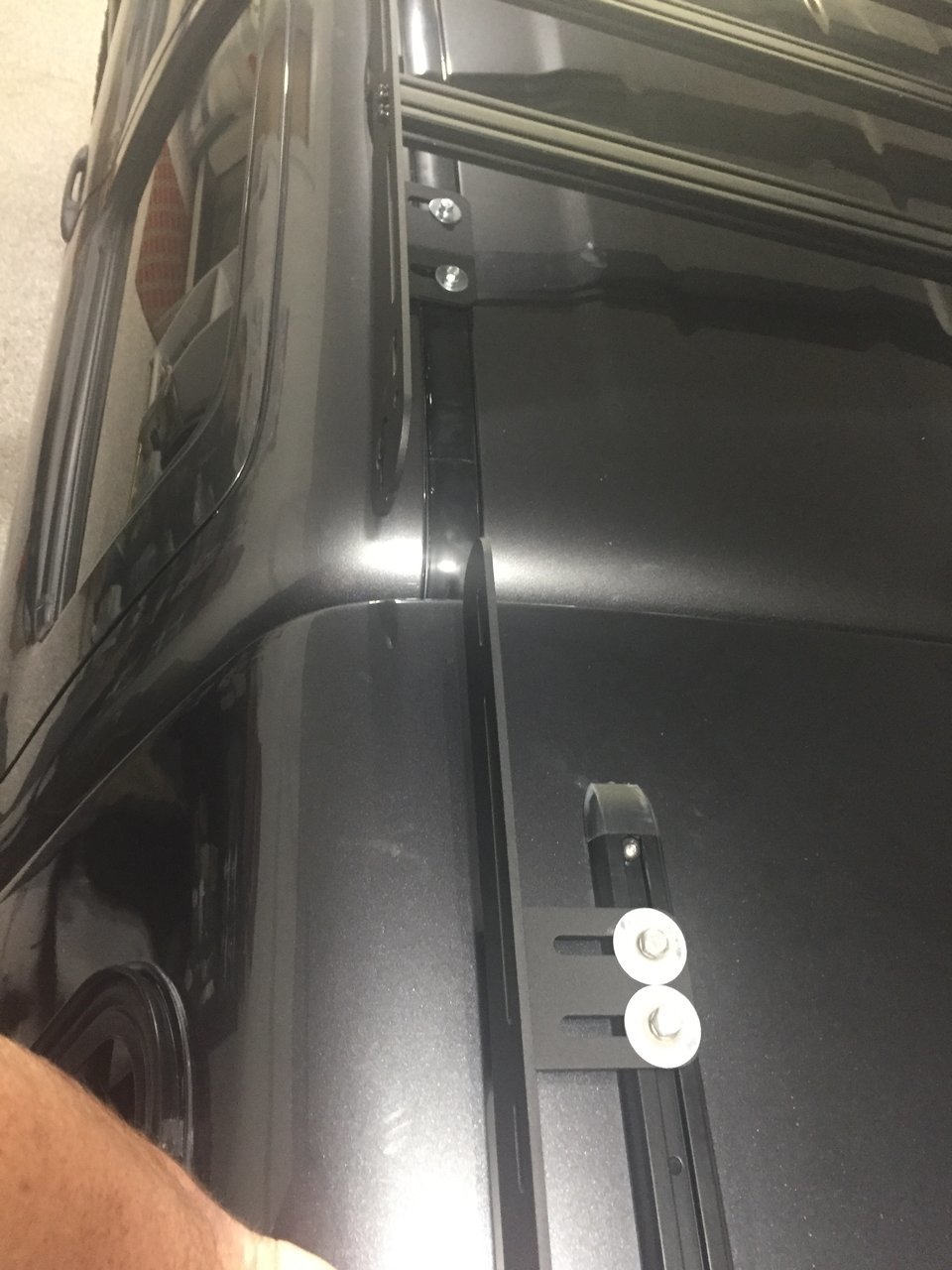

    Thanks for making this! Long story short i bought a used old style toprac two years old that mounts using the side rails see pic. Wont work with my sungtop going to cut them off and order these basicly the same cost order new feet from prinsu, but if these mount better on the snug top ill give them a shot!

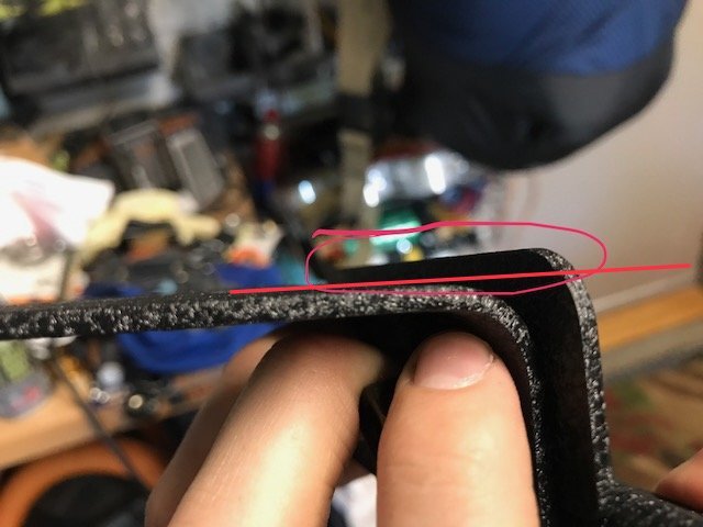

    See the Amazon link in my OP above. That kit comes with 4, but Smittybilt also offers kits with 6, 8, 10, and 12. Model # is AM-x where “x” is the number of brackets.
    You do not “need” to cut the bracket, only if you see a noticeable difference between the TopRac and the CabRac. I’d personal mount first without cutting and only cut if necessary. The cut is about 1/8 to 3/16” of an inch from the bracket piece with the red oval I highlighted.
    For hardware you will use some of the included HW with the brackets to put all the bracket pieces together. However to attach to the prinsu and cap tracks you will need the following:
    1/4-20 at 1/2” length Carriage bolts with washers and nuts. You will need 8. I used stainless steel.
    M6 at 14mm bolt with lock washer and regular washer. Again 8 needed and I use SS.
    Finally you will need these for your cap trackk, the M6 bolts will go into these: https://www.etrailer.com/s.aspx?qry=8810074
    Below the new red straight line is basically where you will want to cut so everything above the line is removed:
