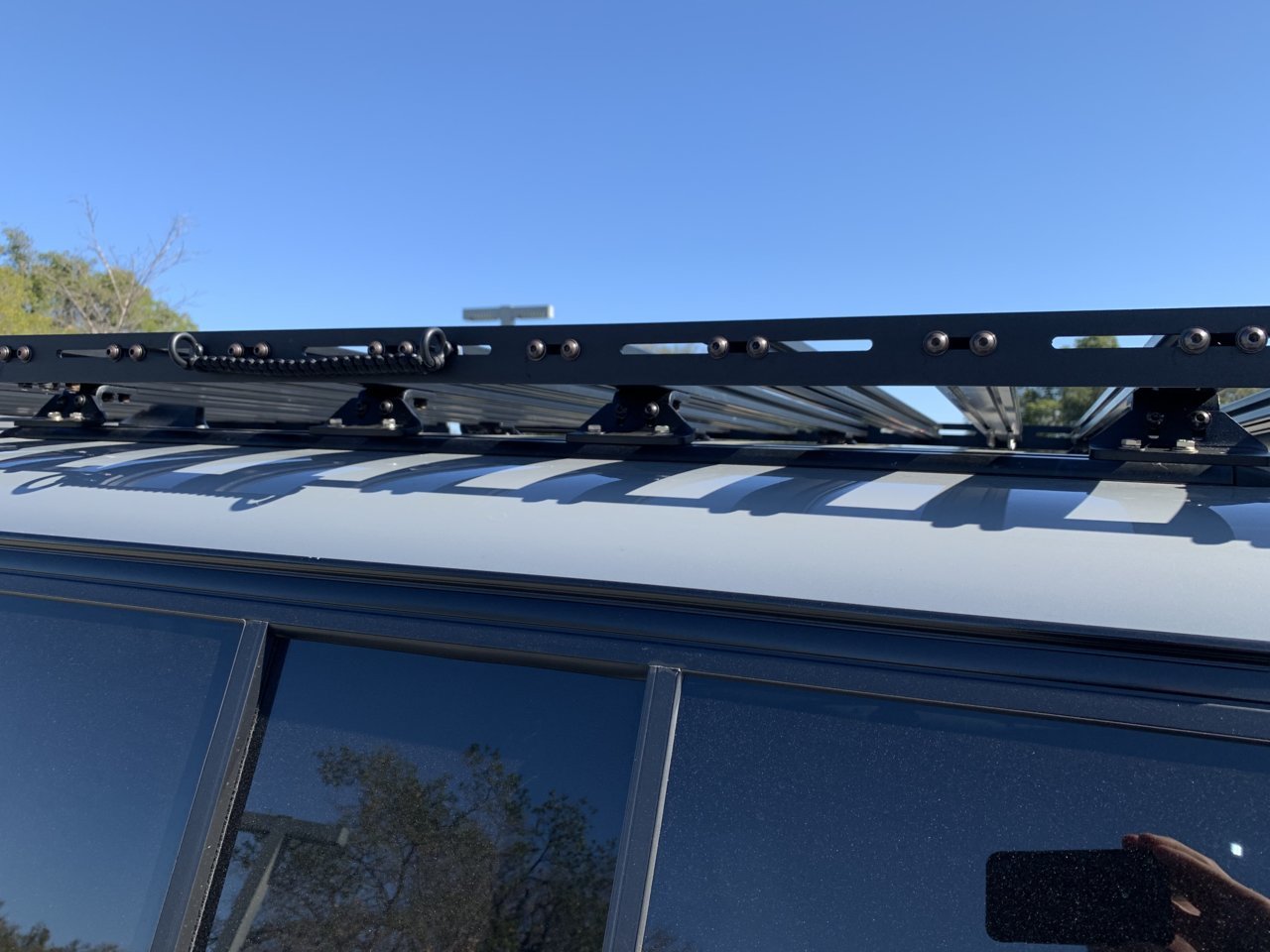

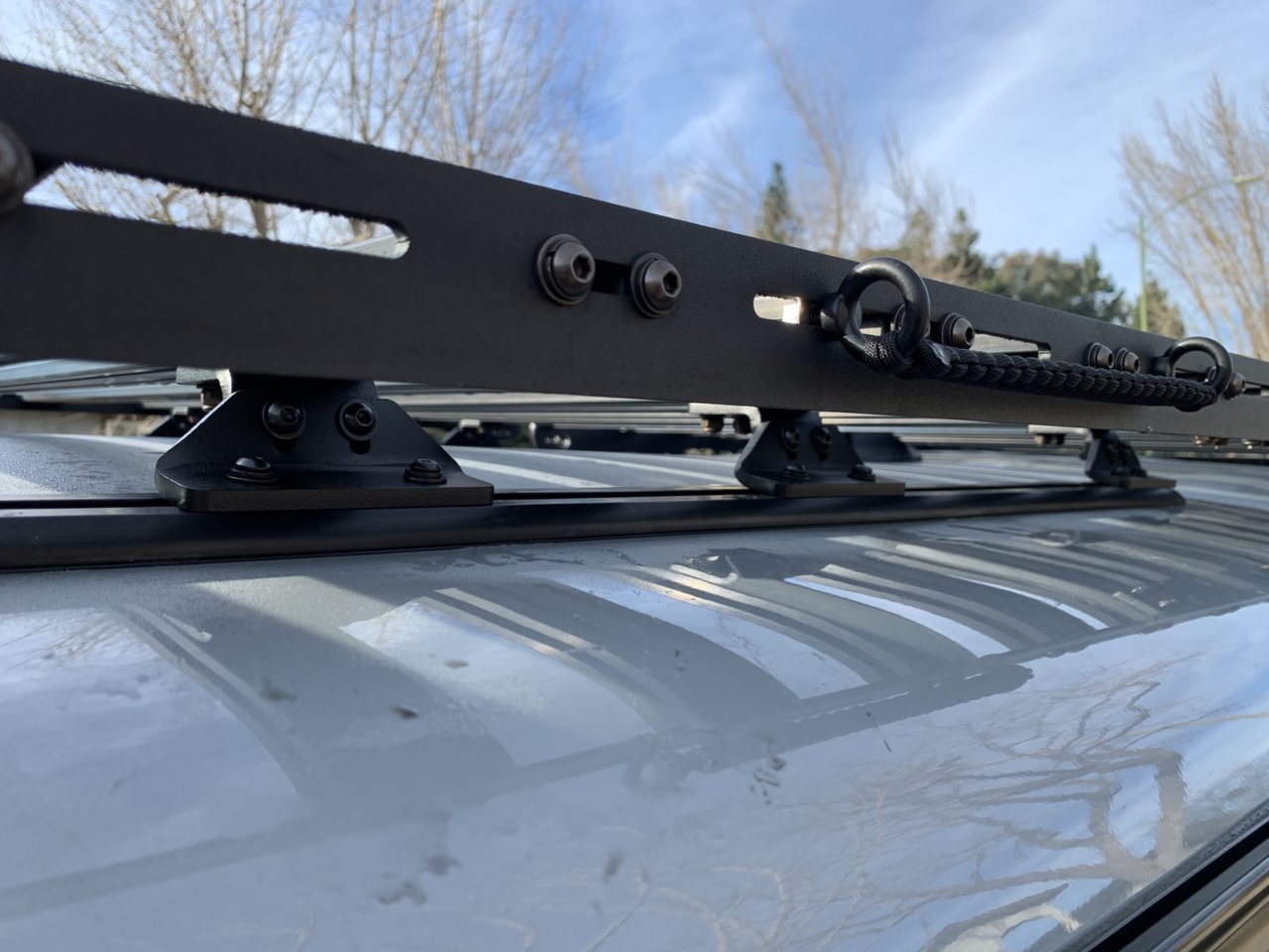

    Added the 8 new contoured Sherpa feet on my SnugTop Rebel and they are an absolutely perfect fit. Note the spacing in the feet as this is the best configuration to really shore up the ends of the rack from flexing...note it does require additional crossbars. I also added black oxide SS bolts that hold the two piece design together vs the raw SS that Sherpa sent me. I have black oxide SS M6 16mm bolts and washers coming from McMaster to replace the raw ones in the picture attaching the feet to the shell tracks :

    Looks good man!

    Now with the black SS bolts going into the tracks:

    @Gat_ Running a Rebel and used the contoured. They fit perfect!
    Though do note your question was already answered in the previous posted of mine that you quoted "Added the 8 new contoured Sherpa feet on my SnugTop Rebel and they are an absolutely perfect fit." o_O
