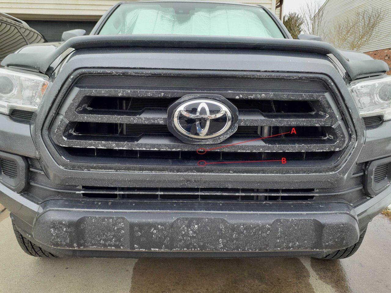

    Asking for advice on mounting location....front camera in the grill of my truck
    from anyone who has done a similar mount to this specific type of grill.
    I already have the anytime camera kit installed, i just need to get the front camera mounted
    in the correct location/oriented correctly. This is the 'Natika' camera from the 'anytime' kit.
    I have seen other related threads...but not for this specific grill.
    I believe there is a (radar?) sensor behind the toyota emblem on the grill so obviously
    I don't want to screw that up with this camera mount.
    I attached 2 pics. 1 of the grill..with positions A and B and

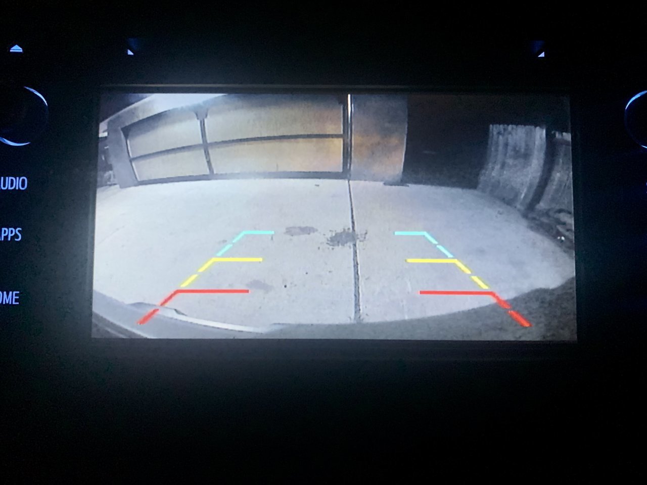

    one of the camera
    My guess is to mount it at "A" by drilling a hole(from under the hood) in the grill. and pushing the camera wire/threads up through it and securing it with bolts etc. basically so that
    its oriented just like in the 'camera' picture.

    I have a feeling if you mounted it in location B, based on the angle of the camera, it'd be predominantly facing up, and you'd get a view of mostly sky. I think position A give you a much better view. Also, the models that do come with a camera installed, there's are also mounted from the top (like position A)

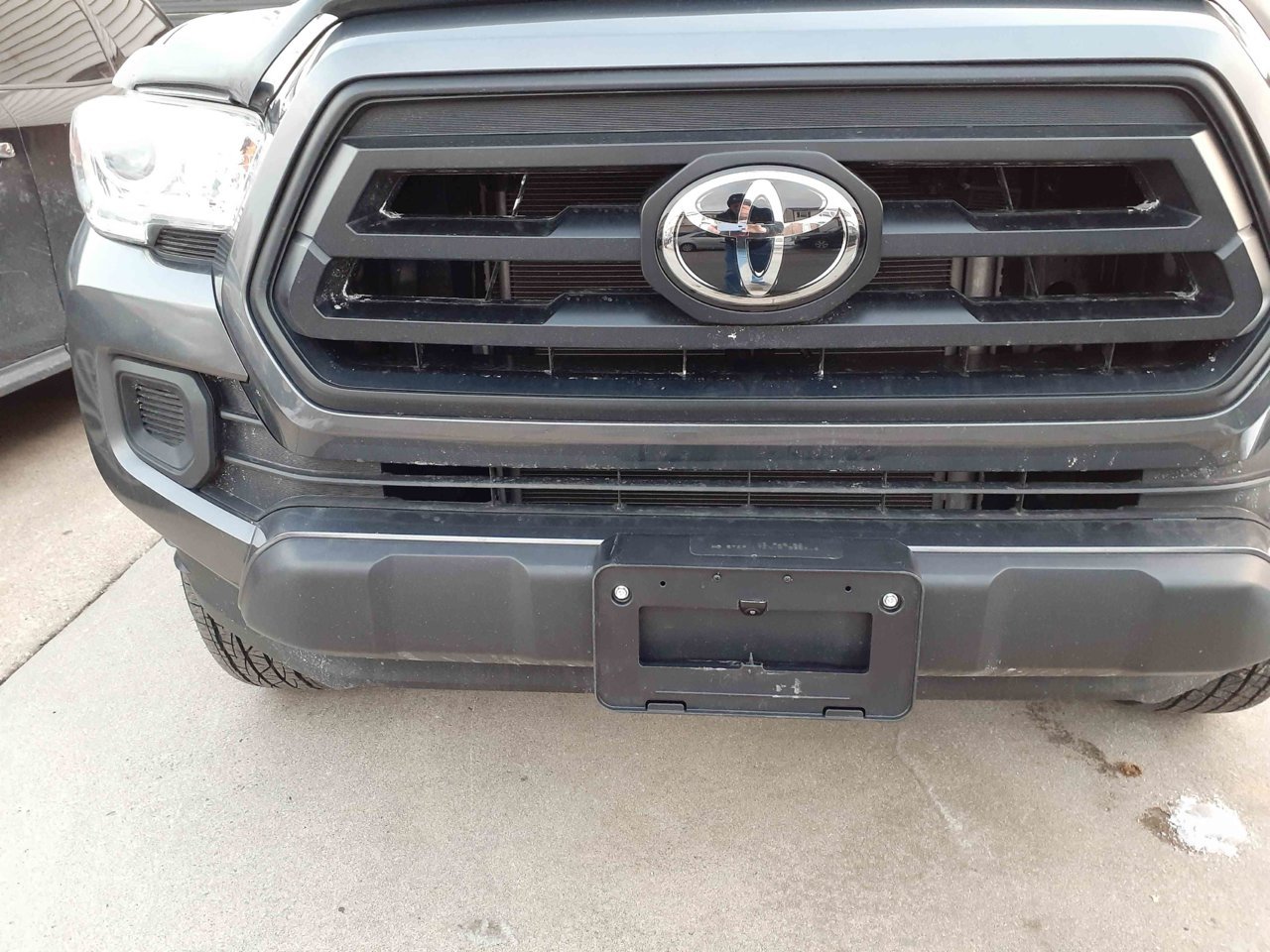

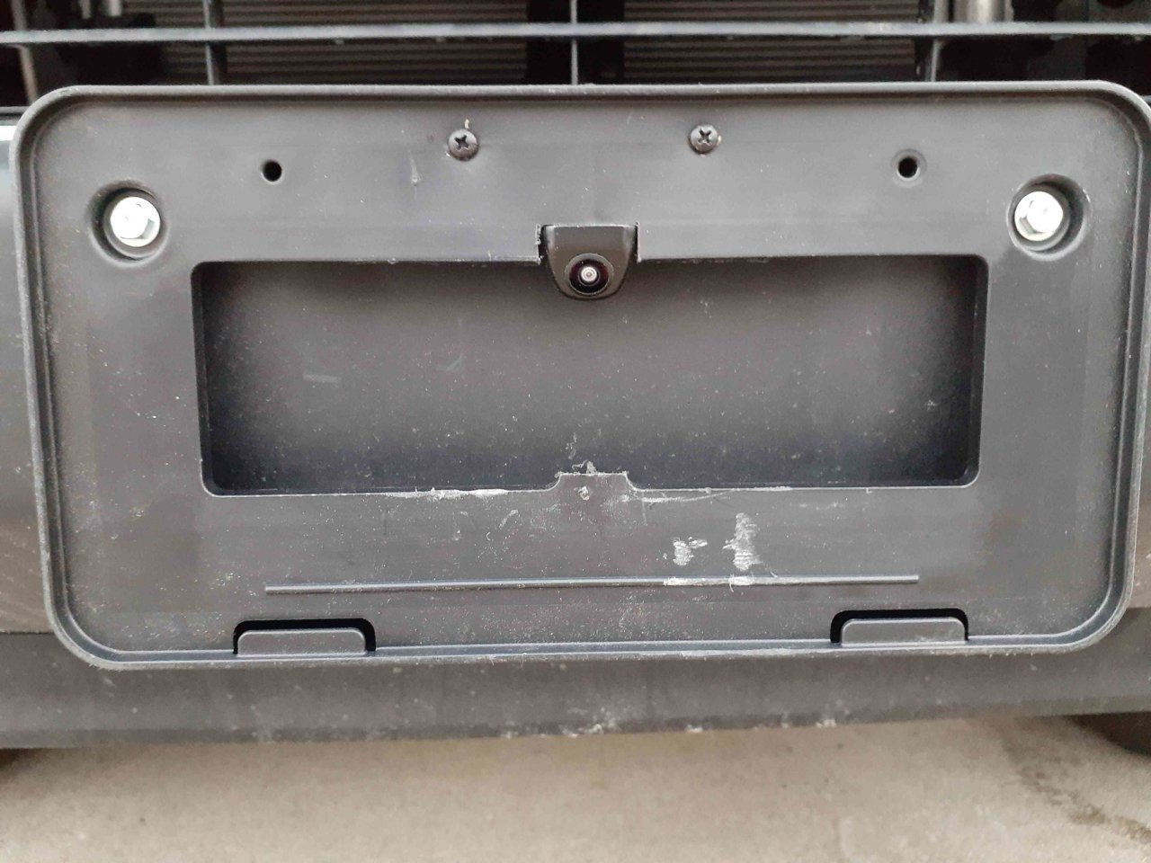

    I decided to put on the front license plate bracket...that came with the truck.....
    and mount the camera inside said bracket. I used the lag screws that came with the license plate bracket.
    Eventually I'll replace those with bolts when i get my act together and put some kind of decorative plate
    in the license plate bracket......

    Looks good. You could have drilled a hole in that plastic flap below the emblem and put it there. The screw and/or some jbweld could secure it.

    possibly.....except i don't know sheit about that radar sensor and i didn't want to muck with
    taking that grill off...and had no idea if 'that' could be done with the grill on.
    I figured this was a safer bet......on my part.

    I put mine in your location "A." Used a hand drill to drill a hole in the grill. Works great.

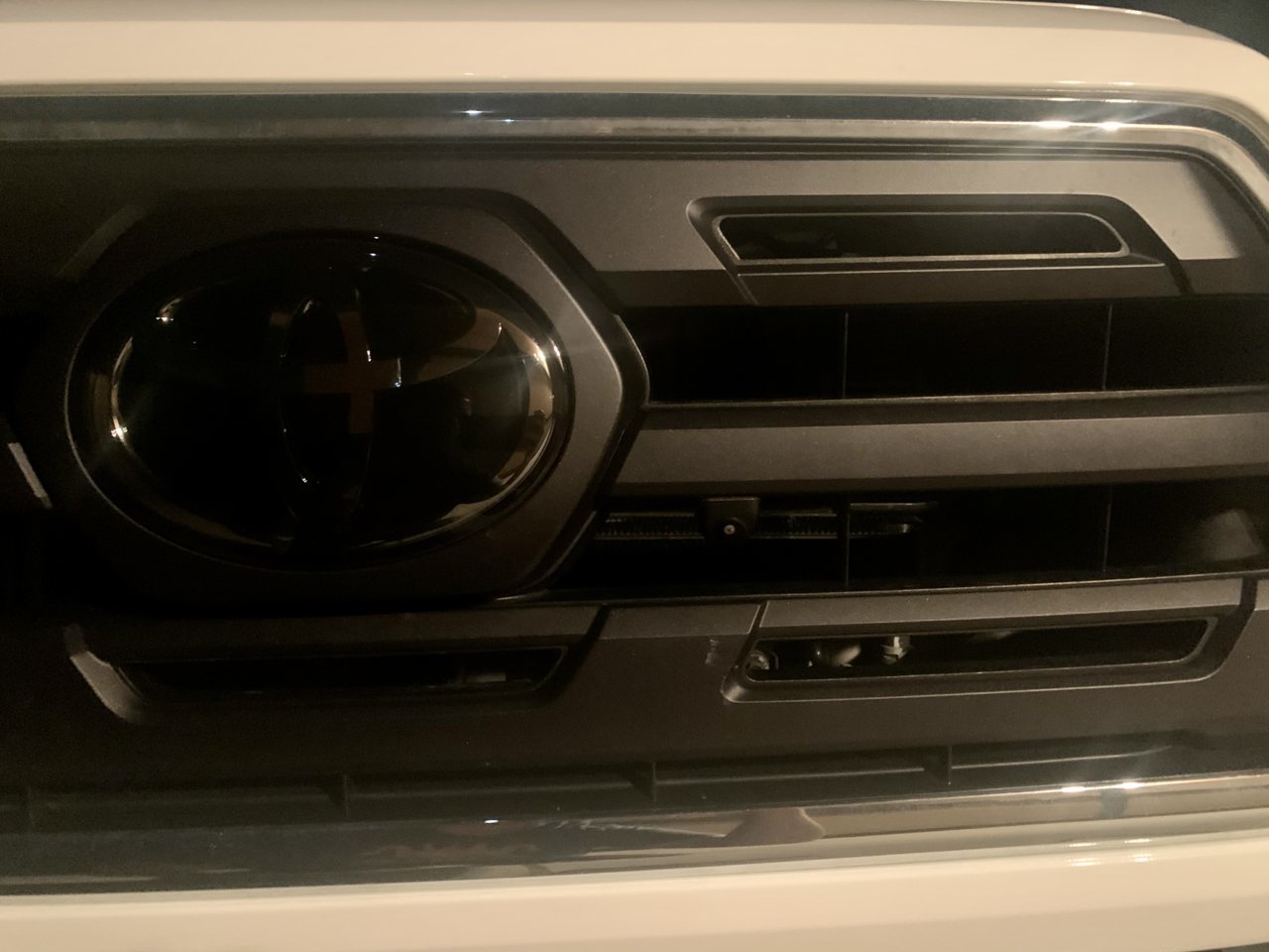

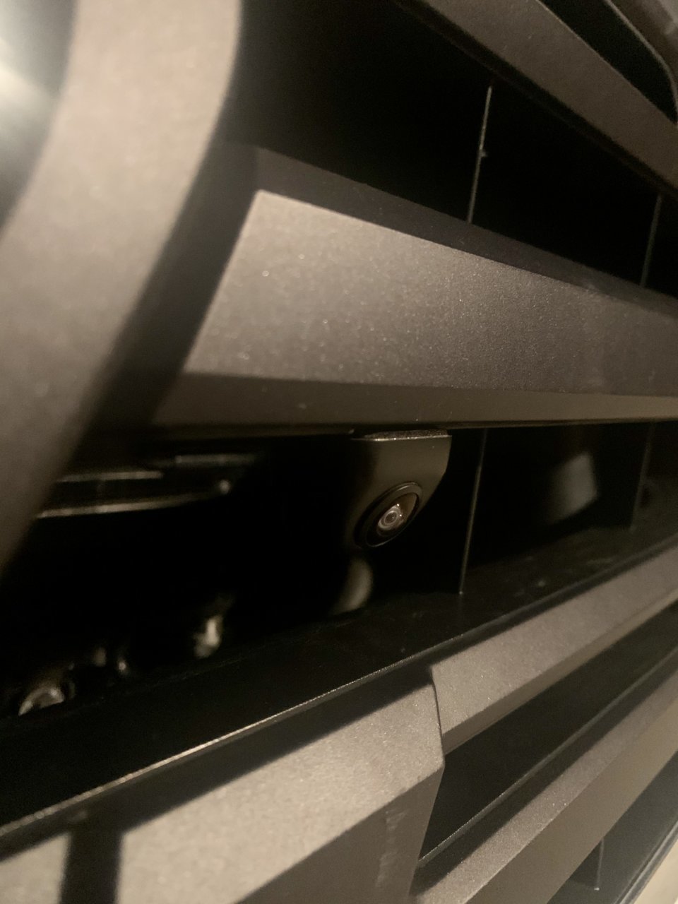

    Mine is an SR5 grill but verify similar. I mounted my camera off center towards driver side and as you can see I have more space between the grill crossbars than below the emblem and even mounted flush with the front of the grill I still pickup some of the crossbar underneath on my camera. Mounting from underneath with camera oriented like the picture you posted you will definitely see the crossbars below. I seen another SR5 with the premium camera mounted horizontally directly underneath the tss. Hope this helps!
    843CD252-B8A3-4E8F-9428-1CB1BF0AE2BD.jpg 68A1DF0E-8273-4CDE-9899-E480207D332F.jpg D3F74169-F77C-4298-A536-11F425BBF789.jpg

    I ended up attaching a clear 'bubble' cover (from Amazon) onto the front license plate mount
    ...mostly to 'help' protect the front camera from any sheit on the road..and in theory rain etc.....at least a little.
    I had to alter it (shave down parts of it) to fit the stock plate mount.
    So far so good., Its been at least 2 months.

    I ended up using the license plate bracket mounting.
    It was close quarters to attempt to drill that hole without removing the grill and i didn't want chance.
    And i didn't want to remove the grill of chance mucking with that sensor.
    With that said...the install seems to be working without issue.
