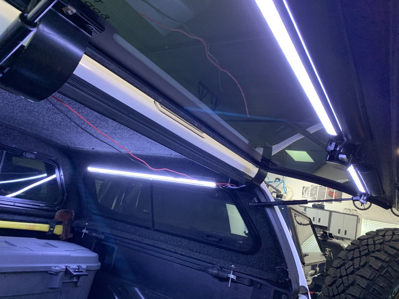

    I just did this in mine. I didn't want to use any type of glue since I know it will fail over time.
    https://www.tacomaworld.com/threads/tiffany-the-taco.374490/page-13#post-22033396
    I installed nutserts in the reinforced section of the roof (part that drops down). I attached the light bar clips to these with low profile machine screws, that way I can always remove it if I need to.

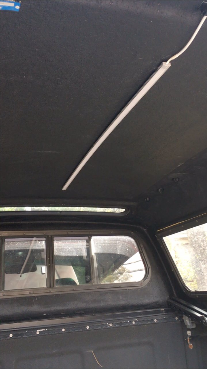

    Instead of putting them on the roof, use 3M trim tape to attach them to the top of the window frame.
    That is what I did with mine. Ignore the wires, they got bundled and routed later.

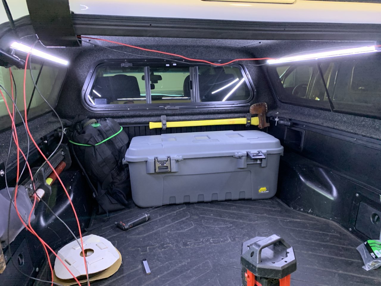

    Window frames.
