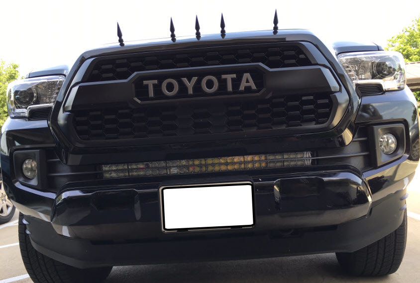

    My Dual Row Fit
    fökai671 likes this.

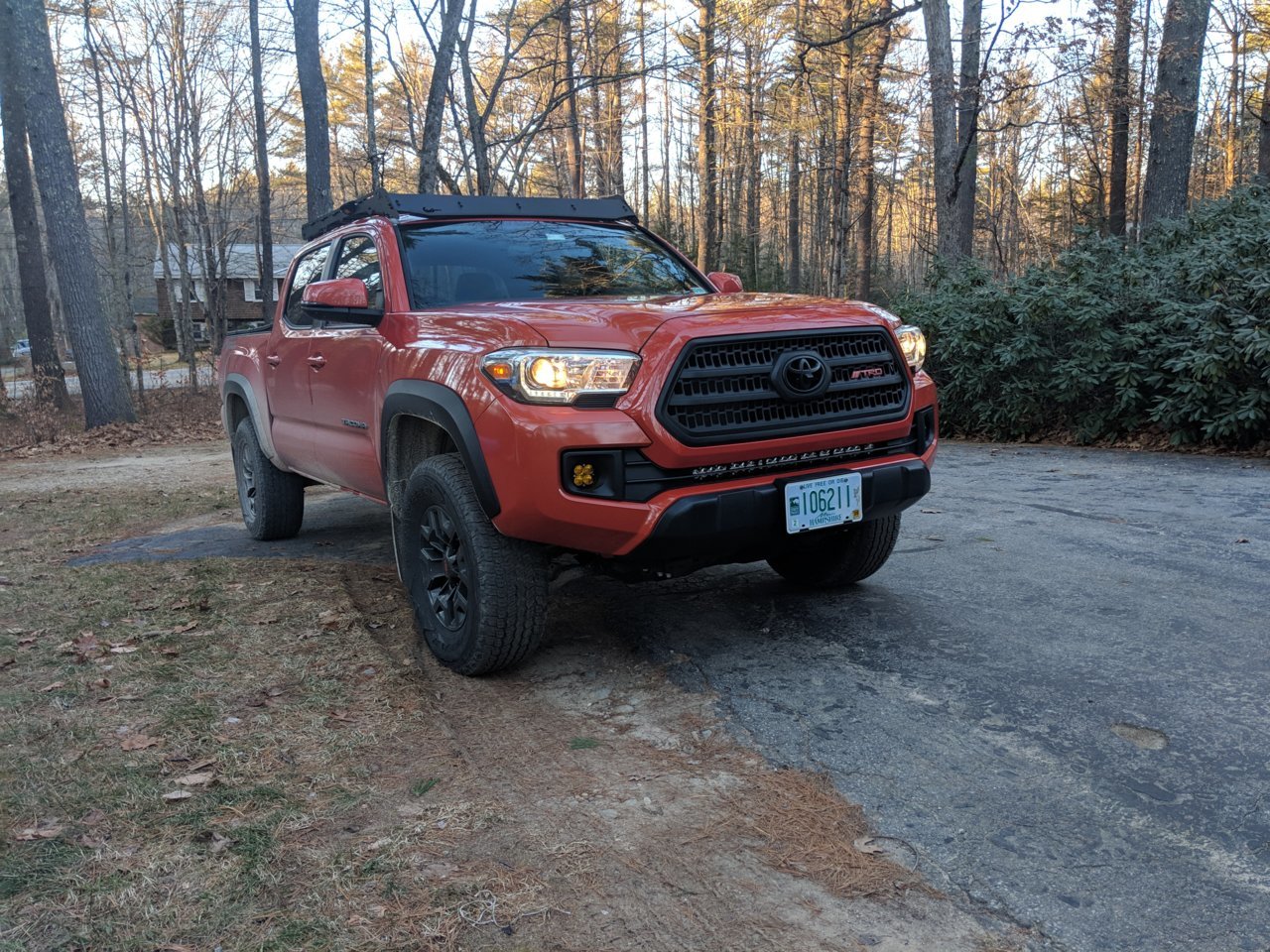

    A few vendors sell mounts for that lower section. Caliraised and rago fabrication are two that come to mind.
    I have the caliraised mounts, and you use existing bolts to install the mounts. No drilling. They sell a couple of kinds, one you cut out the black plastic grill pieces (might be called flush mount?) and one you put it behind (this is what I did... but I ordered the wrong ones at first).
