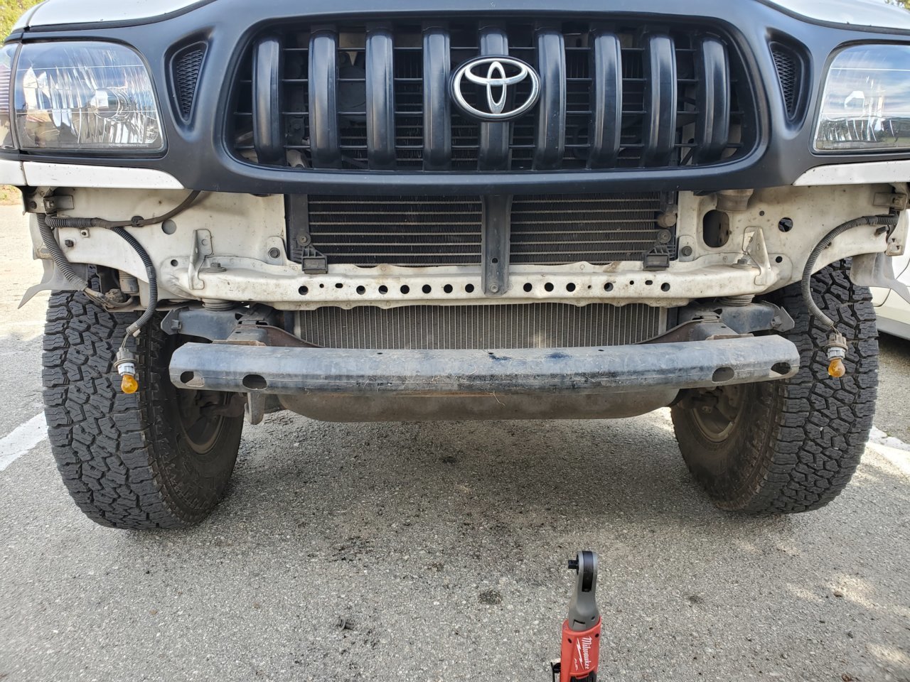

    @Cryptozoiccreekchub
    Removing the bumper is quite literally a 5 minute job; deep socket 14mm will set you free.
    Here's a pic to show you what's behind that bumper -
