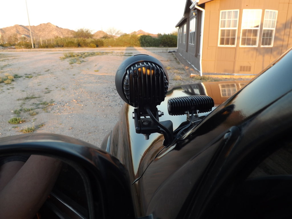

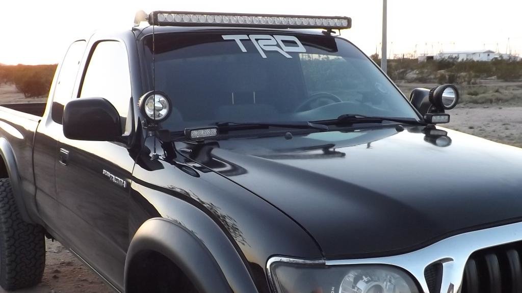

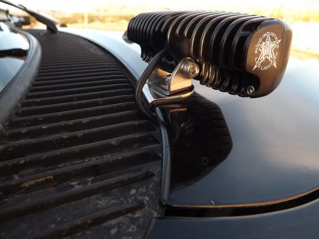

    Here's mine (not really pods but) from the back using antenna mounts. Like $6 each. Can't find the ones I bought before. But just ordered some other mounts just like them. You have to get matching countersunk bolts as they have to be inserted upside down in the mount and the head of the bolt will be almost touching the hood.
    And here's my cannons on cbi brackets.
