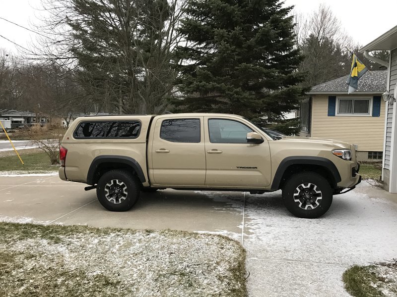

    First off, I know that there is the *THE RTT Owners Thread(With BS)*, but there are so many posts in there at this point it's hard to find specific answers.
    I'm moving my ARB Simpson III from a KB VooDoo bedrack to a Leer 100XR, so what I would like advice and recommendations on is how do people that have fiberglass toppers mount their RTTs? I have Thule tracks but I don't know if it's best to just put on Thule feet/bars or go Rhino HD feet/bars or go the Prinsu (or some other brand) rack system route? What have people done and had success (or failures) with?
    Thanks for any and all help!

    I'm going to run Rhino Racks HD bars on this to hold the tent to start, just not sure if I should be looking into reinforcing the inside somehow? Didn't want to go with a contractor style top, so this obviously doesn't have as big of a load capacity.

    I'll be taking the risk, if it seems to be too much for the topper, looks like I'll just have to get a Prinsu cab rack and it'll get mounted up there.
