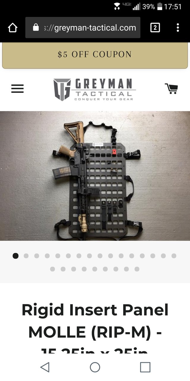

    Has anyone on here with an ARE Overland shell put a metal or plastic molle system for storage inside? The screenshot I have uploaded is an example of what I am referring to. Was thinking inside on the bottom of the roof of the shell since I also keep my dogs in the bed of the truck and they stick their heads out of the windows.
    Haven't purchased a generic panel and just screwed it in because I don't think there's much space between the headliner and the exterior top of the shell. Dont want screw tips or bolts punching through and poking up. If anyone has done something along the lines of what I'm describing or has found a different solution that works for conveniently accessible storage (since the open part of the window for the dogs is closer to the tailgate), I would like to hear of it.

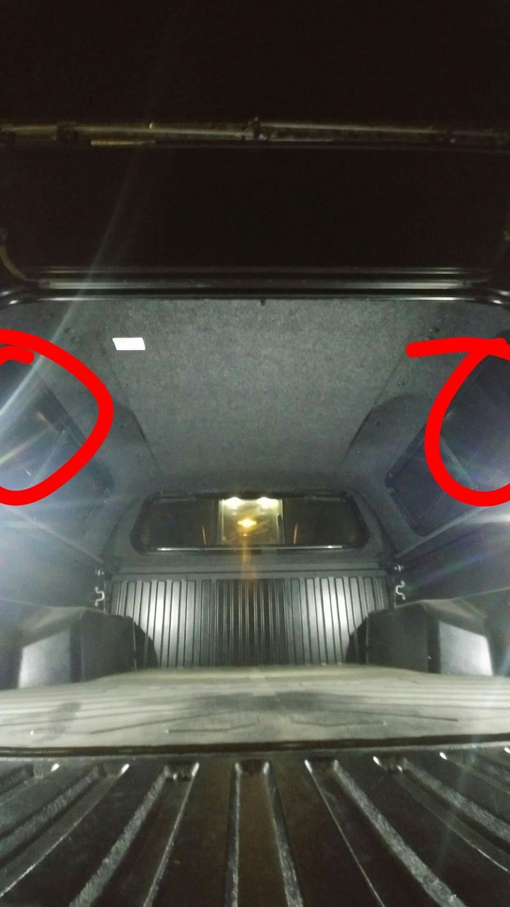

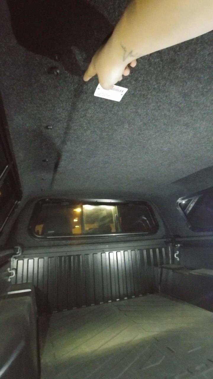

    I've uploaded some photos for reference. One has the windows circled, which open for the dogs to stick their heads out, so covering that up isn't an option I want to go with, but it also means that conveniently reaching in to grab something right there isn't really possible. Which is why I was thinking the roof. In the picture of the roof, I'm pointing at the line that shows the border of the section that looks thicker than the rest of the roof. This section drops down approximately a quarter inch lower than the rest/sides of the roof. Don't think it comes down a full half-inch.

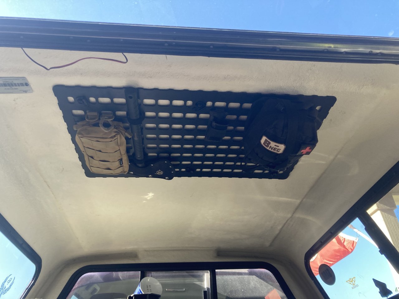

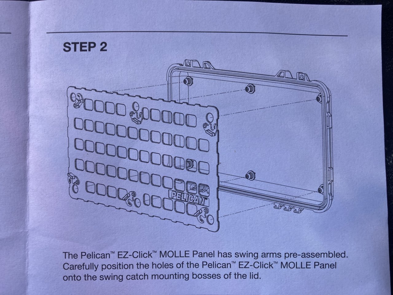

    Resurrecting an old thread I know, but I think this merits discussion and I’ve been searching all over. Since I put a pull out drawer on one side of my bed I can’t use the molle bed side panels but I want to mount something on the ceiling. The Leer Locker is sweet but expensive. So Pelican makes a removable molle panel for their cases with the hardware. I ordered 2 so I can change it out with the quick release.(https://www.amazon.com/dp/B08GP5FMH6/ref=cm_sw_em_r_mt_dp_cGFHFbJ579TWR)
    From the research I did, Leer puts Tricel Honecomb in for reinforcement...it’s just cardboard though so nothing to screw into.
    So I think all I’ll need to do is attach some fur strips to the ceiling (someone mentioned Liquid Nails or I may try the 3M double sided tape) and then the screws. I’m going to try this first before putting holes in my shell. Not sure but that’s part of the fun with these projects! I’ll share here and maybe start a new thread when I’m finished.

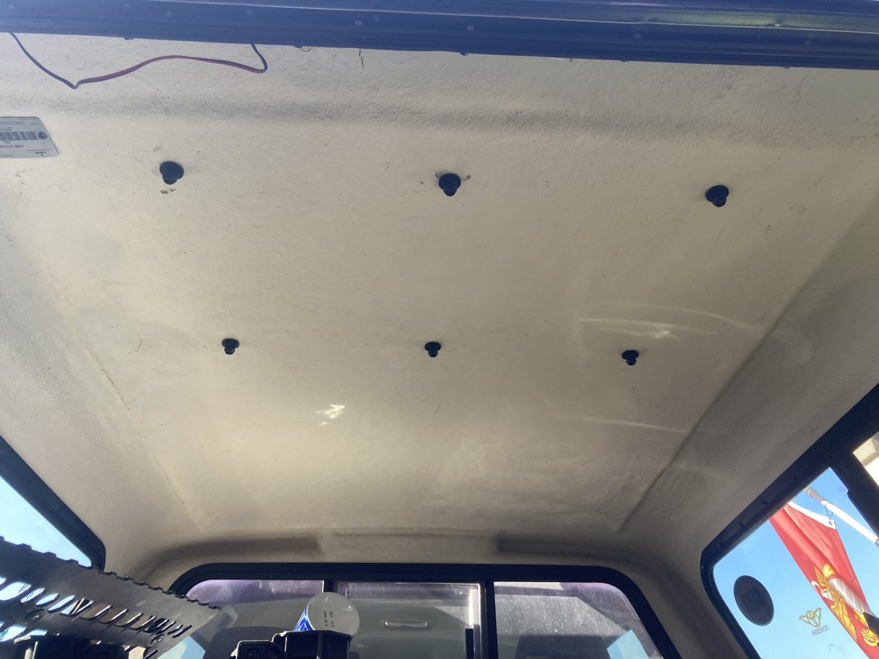

    I think I cracked the code on this. I used Sika adhesive (which is stronger than concrete) in the holes I drilled along with regular plastic drywall anchors. The MOLLE panel is then mounted with the included hardware and voila!
