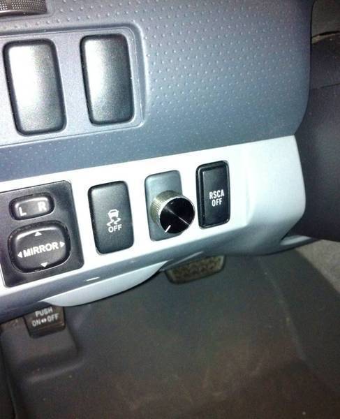

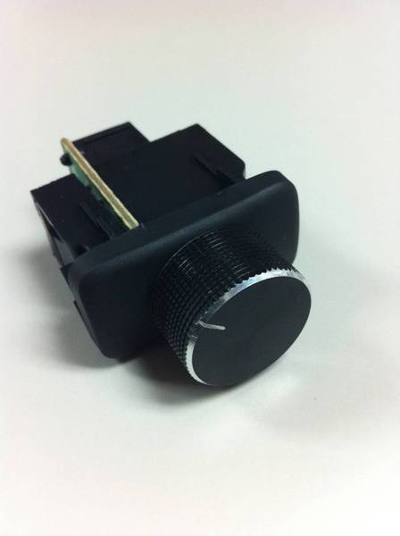

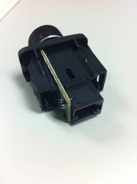

    I'll post some this weekend when I complete the install. I mounted the sub gain knob today in a blank.. it's looks pretty sweet..
    Had to take out the "guts" of the original plastic housing and fit them into the factory tacoma blank (borrowed that lovely idea from another member here). I also ground off the back of the knob a couple rows of the knobs with a belt sander to make it shorter so it wouldn't hit on the blank. fits like a glove and turns nice and smooth. good times. :D
    sorry for the terrible pic, but you get the idea:
