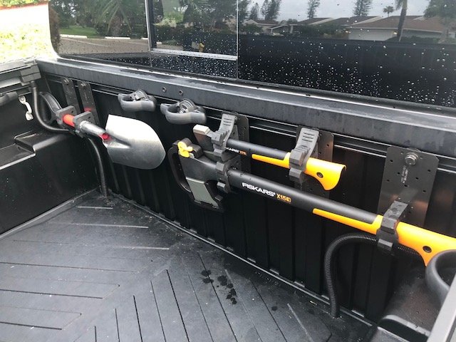

    What are those little boxes you have at the front corners of the bed running to the drain spots?

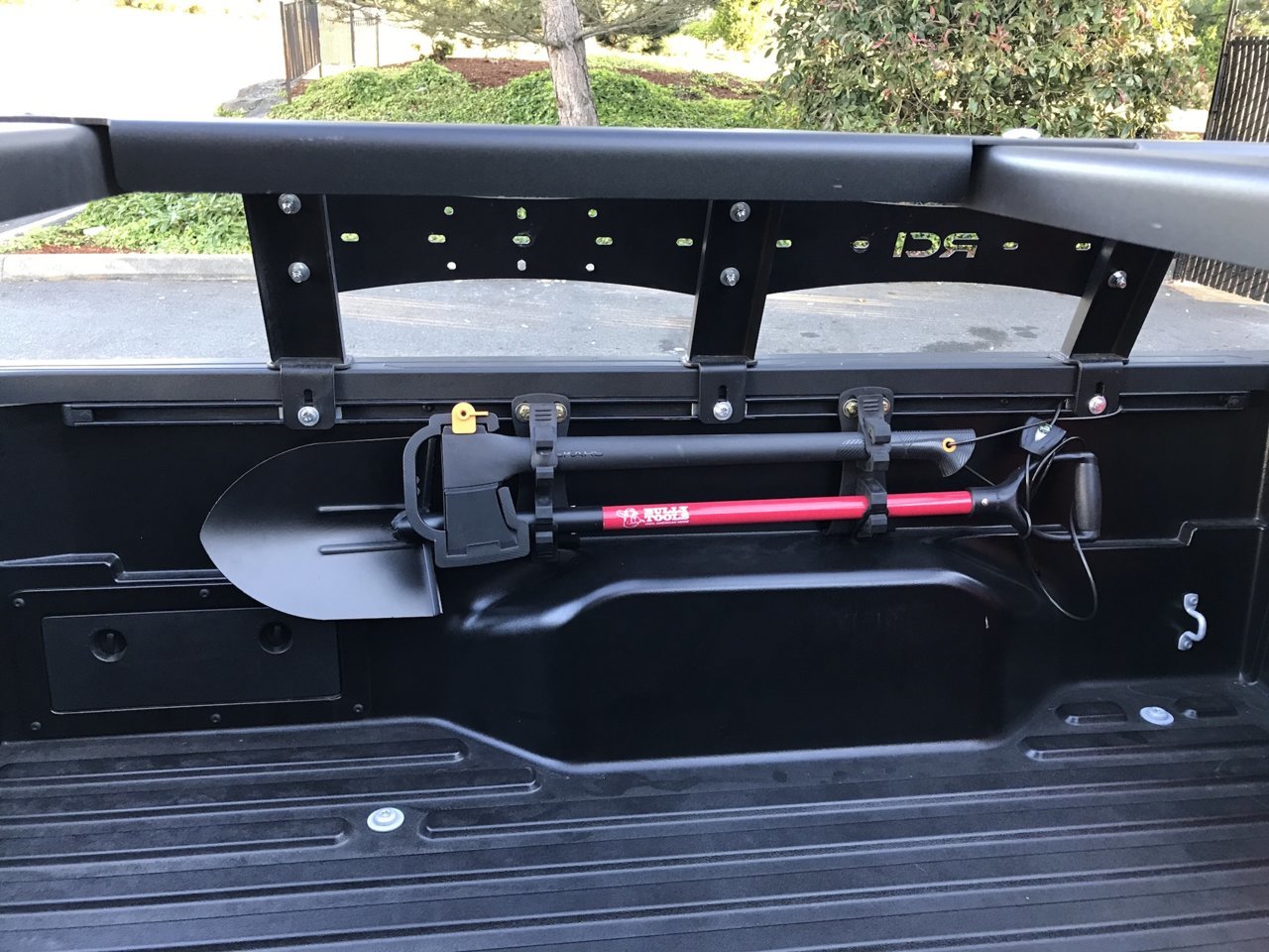

    What's the security cable you got running through your set up?

    It’s a master lock python

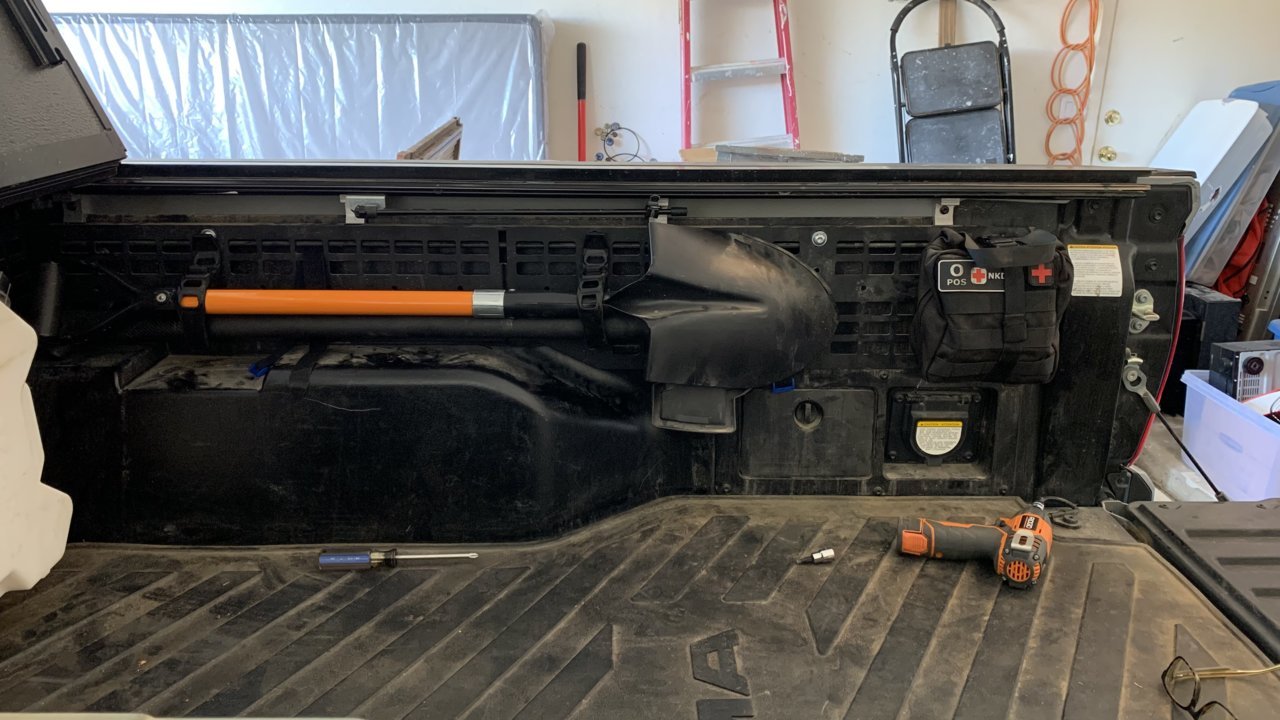

    Cali Raised full bed MOLLE, (2) Kolpin Rhino Grip Flex 3” mounts, axe/shovel both stacked in the mounts. Super tidy, much better spacing & efficiency w/ the Kolpin mounts, plus they are MUCH higher quality mounts than the Quick Fist garbage. 3E425336-A151-4E38-B7B5-2BD43E389BE3.jpg

    How does the MOLLE attach? To existing holes or do you have to drill new ones?

    The MOLLE panels attach to existing hardpoints. The side panel here attaches to the side bedrail and the bolts surrounding the 110v outlet/storage bin.

    Thanks, is that a Fiskars shovel?

    Shovel is not a Fiskars, but the axe is. I just happened to have an orange spade shovel from Home Depot or wherever.

    The unused holes to which you refer in the video, those are used in Tacomas prior to 2019 before the driver’s side storage cubby was deleted. Those holes would attach to 2 of the hardpoints of the cubby, same as they do on the existing passenger side cubby/110v outlet.
    My ride is a 2019 w/o the driver cubby so those holes sit unused and the lower part of the MOLLE panel is not secured, although it is bolted to 3 upper hardpoints via the bedrail. ‘Not secured’ is a bit of a misnomer though, because the panel is very much secure, does not rattle, etc. One could drill & install two nutserts in the bed to occupy the lower hardpoint mounts though. I’ll likely do this eventually even though it’s really only necessary to satisfy my sense of symmetry.

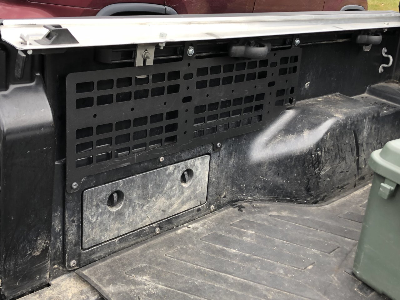

    I ended up getting the full driver's side kit for Xmas and installed it over the weekend. I love how it came out I am just upset the forward most section won't work because of my roll up cover bracketry. (I posted that section up in Classifieds). It almost lines up perfectly with where the Cali Raised system would mount. I plan on getting the rear panel for the passenger side. Most time consuming part was remembering how to remove the stock Toyota mounting points.
    Gonna check out the Kolpin stuff as I find the quick fists a PITA.IMG-2213.jpg
