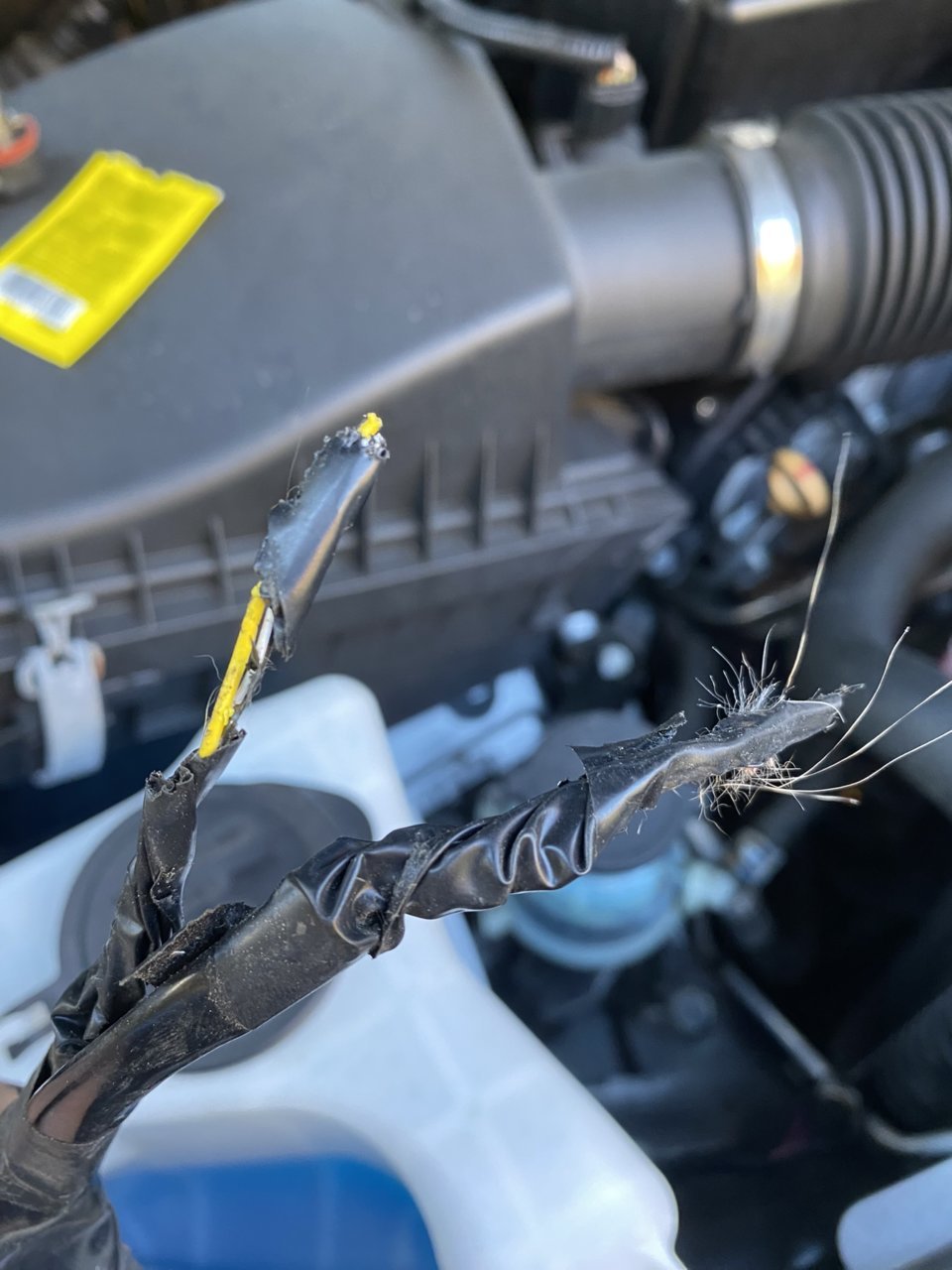

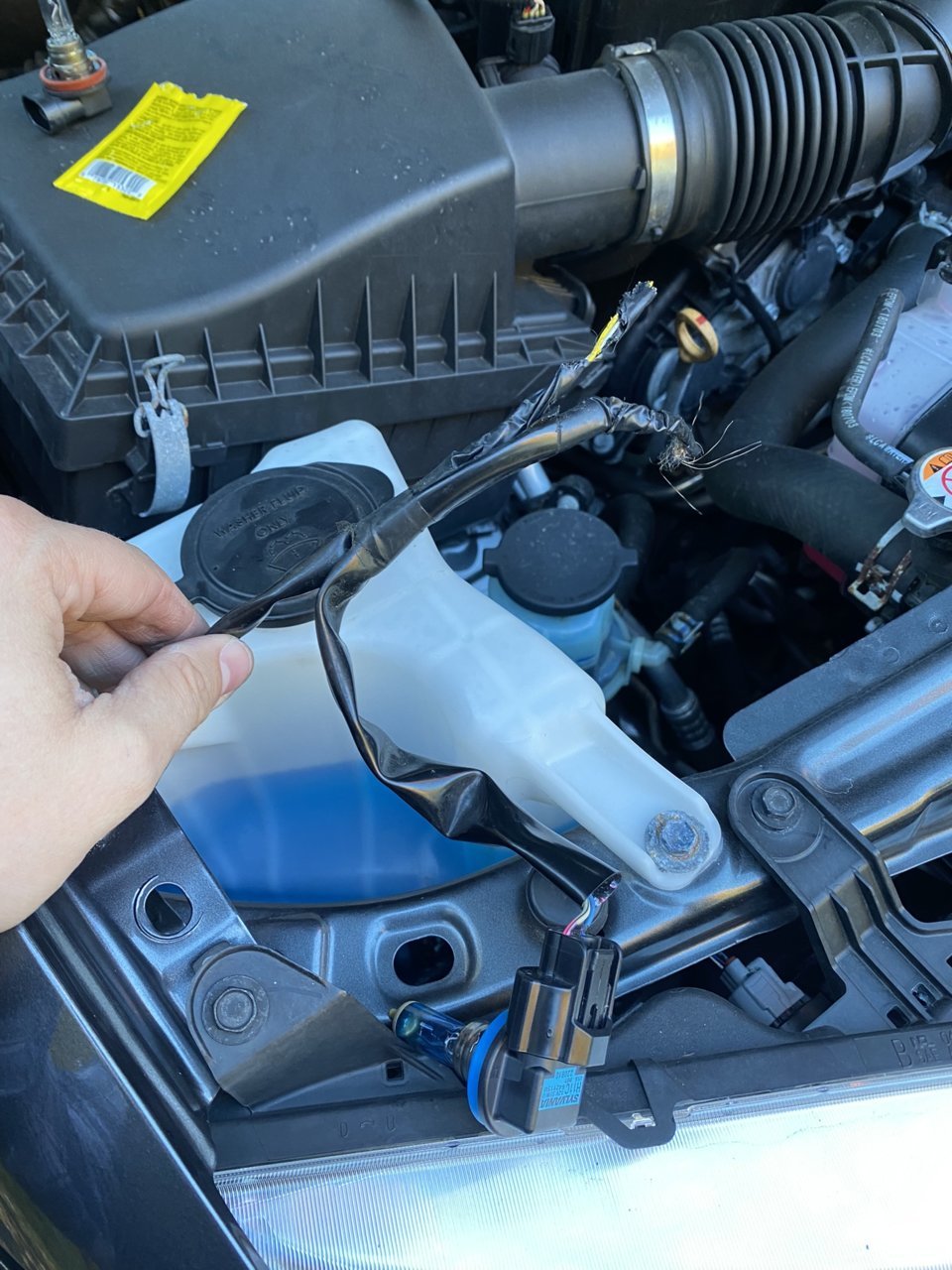

    I noticed 1 of my headlights was out, so I bought a replacement lamp. When I went to go put it in I noticed the wire was cut.
    Long story short, I bring it to the dealer, and they tell me it’s the main cable wiring harness that’s been cut. And mice are probably the culprits. Only thing I noticed not working was my low beam passenger and washer fluid spray. Anyway, dealer says it will cost $6,000 to fix, take about a week to repair. And it’s not covered under my warranty but insurance will try to cover most/all of the cost. Any of you had this issue? I park my truck outside because I have to. But I’ll look into any and all solutions to try to keep them from coming back. I Had the truck only 3 months and this shit happens.

    6k just for the headlight wiring, or did the mice chew more than what's in the photo? That seems real steep

    the headlight wiring is all I can see, but the mechanic said it’s the main engine wiring harness and the whole thing has to be replaced. And he’s surprised I haven’t Had any more issues. So maybe theirs more
    Chewed up that I didint see

    I just had this issue… Brand new TRD Pro with 8,000kms on it. Part is back ordered, sitting at dealer for 5 weeks now. Was told weeks or months. Dealer quoted repair at $6,000CAD, insurance will pay and settled it to $5,000CAD.
    Mine showed up as a check engine light (code was for knock sensor). They had to remove the air intake manifold to get to the main power harness part that was chewed on. It would have been impossible for me to see that happening. Oh well…
