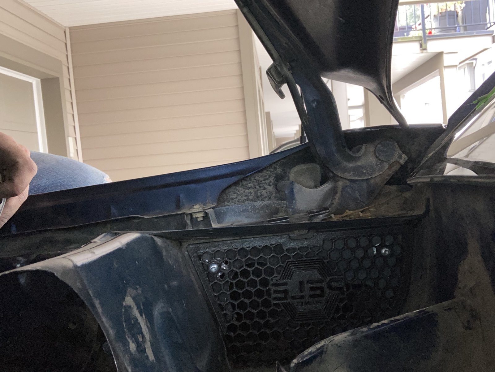

    I use @dpele screen that came in a kit.
    You may not see it in this photo, but there is a screen below that angled piece.
    And there is a screen blocking both passenger and driver side cowl holes.

  6. Feb 29, 2024 at 11:43 AM
    outlawpapa
    outlawpapa [OP] New Member
    Feb 29, 2024
    #444928
    4
    Geno
    07 tacama four door full size bed
    thanks for your picture, that helps. I was able to pop off the plastic cover and found the main opening to cover up, I'll check the other side to see if that well goes anywhere or is just and empty space. That second picture looks like it was taken from inside the engine compartment, you said you had to do both sides of fender well? thanks for your time.

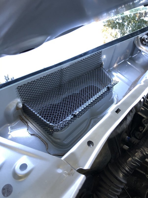

    I put my phone inside the cowl tray, roughly where the HVAC intake would be.
    I was only able to do the passenger side, the driver side I needed a 90degree drill to install, so for now I just used VHB tape.
    Some other examples for inspiration would be to google “Cowl Air intake”, others installed some kind of screen while they were under there.

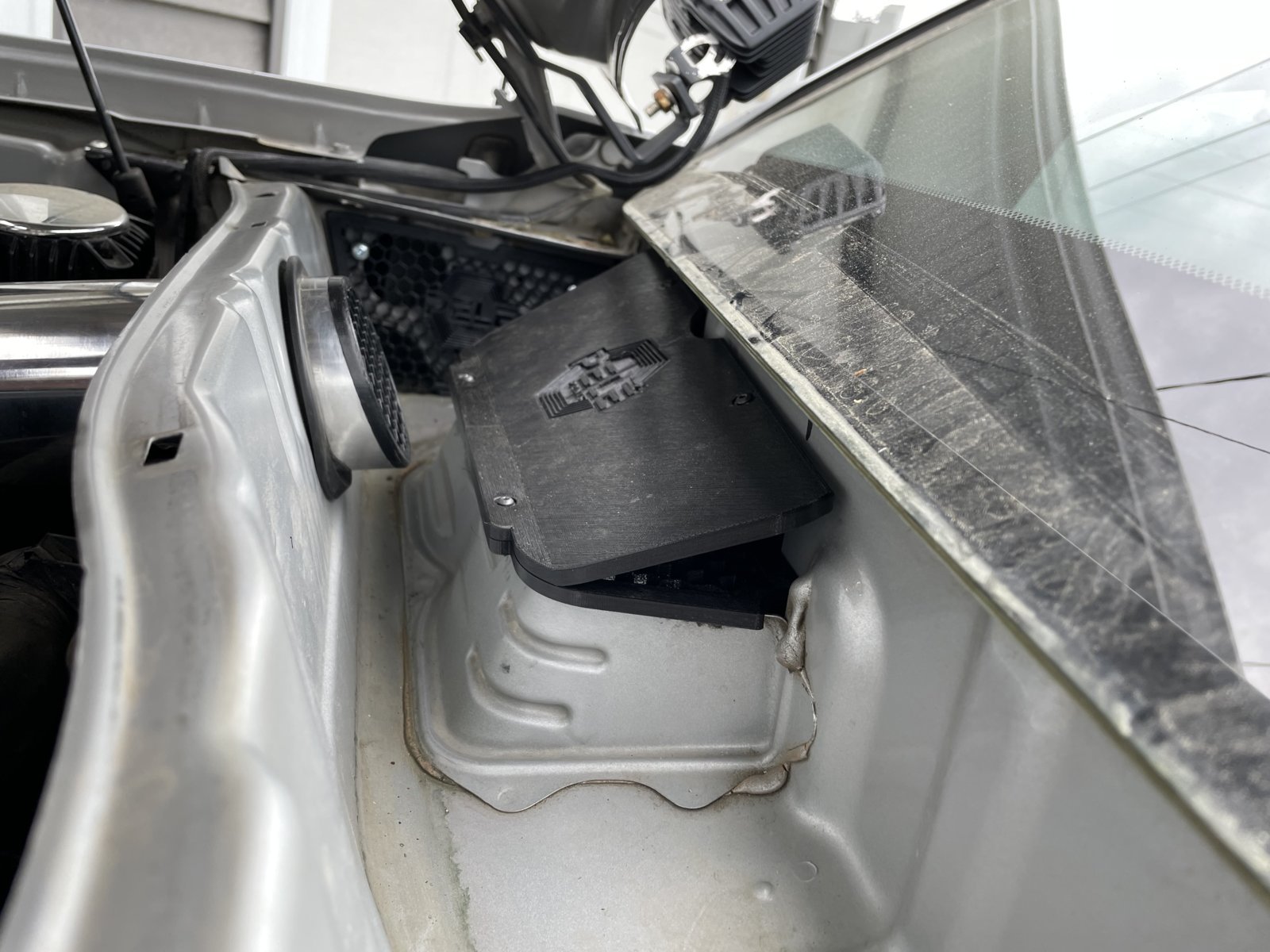

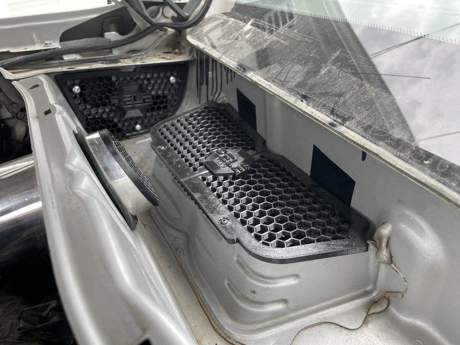

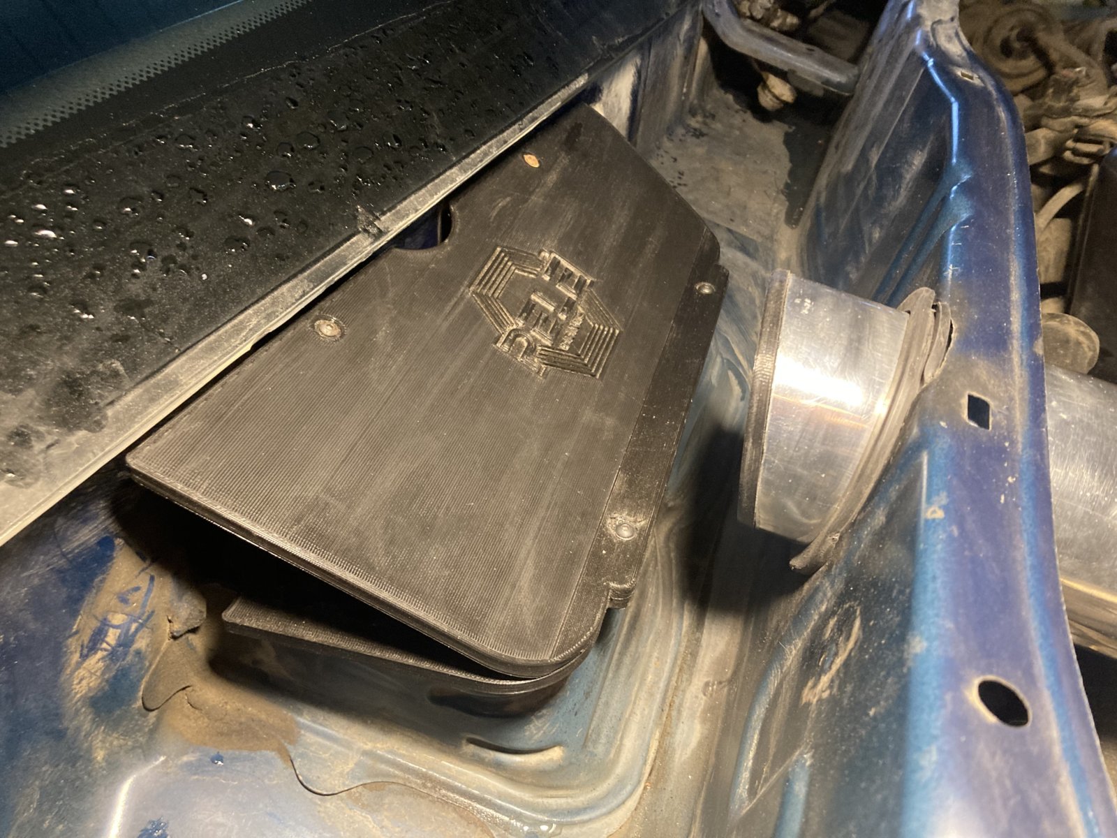

    Thanks @BluberryBCtaco for the tag!
    Here's a picture of my KIT2 (intake not included):
    Here is KIT1 (with intake) or KIT4 (no intake):
