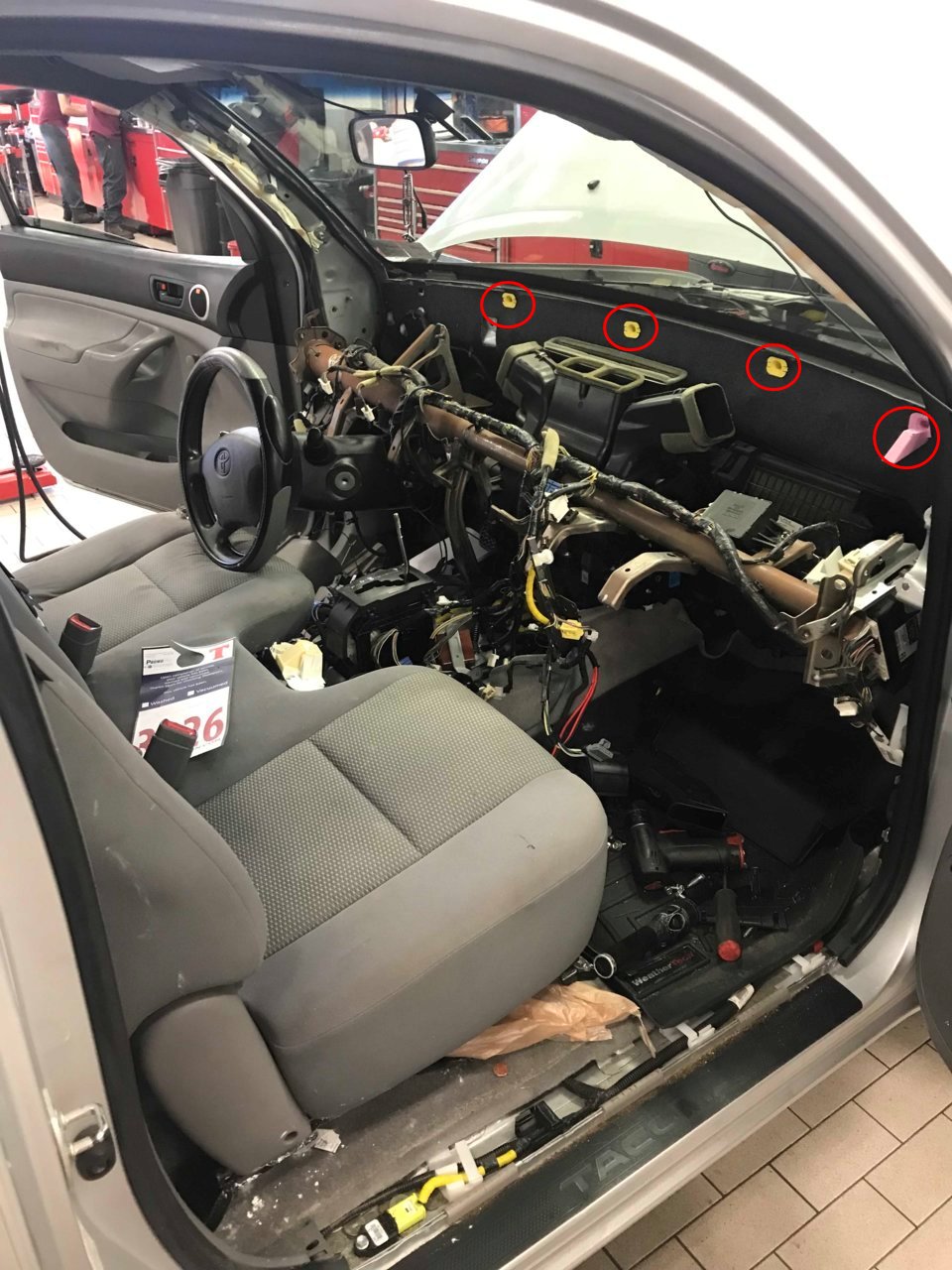

    I notice a picture (@PennSilverTaco ) that I think will show what I was trying to describe as might be the cause of your noise behind the dash. If it is unrelated to heater, comes and goes with cold vs hot temps, and only happens when the vehicle is in motion, and can be eliminated by pushing on the dash near the glass, good chance it is one or more of the clips. The instrument panel (dash) has clips that go into these when it is installed. Keeps the outer layer of the IP level/prevents sagging with heat and age. The big pink on engages first and guides the IP in and up so everything else aligns correctly.
    If you ever have your IP out like PennSilverTaco does, it is a good idea to add some felt to them to prevent rubbing.

    As the owner of the truck seen with its dashboard dismantled in the photo, let me tell you...
