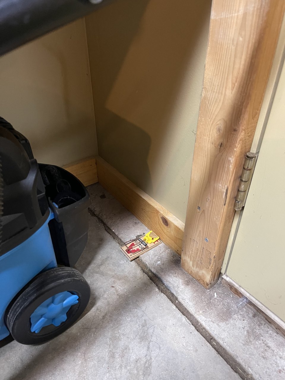

    hawk.jpg I can't keep mice out of my garage no matter what I try. So I just trap them using old fashioned snap traps with peanut butter and send them to Mickey heaven. I put the bodies out at the end of my drive. Fox & coyotes come at night to retrieve the carcasses, but this Northern Goshawk will take one in the day. He (she?) in unusual as the bird walks around for a while before picking up the mouse.

    How would you do that while camping/sleeping?
    It seems hard to just wake up randomly at 2am, grab a .22, find one near the engine, then fire hoping it doesn't miss and hit the engine

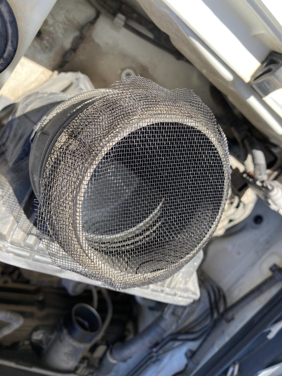

    I had rodents get into my engine's air filter box. I screened the input.

    I had a family of red squirrels nesting on my cabin air filter and acorns, leaves, in my air filter.
    I used 1/2" square screen to cover both and haven't had a problem since. The cowl is easy to remove. There inner fender well, not so much... Remove the air intake from the engine bay to cover the intake. I used tyraps. Insert from the outside so that you can roll the locks into the intake. It'll be easier to reinstall.

    Yes, that would be difficult which is why any shooting is done during the day. Around here, we prefer to see what we are shooting at.

    If that is fiberglas screening, mice will chew through it.

    Aluminum

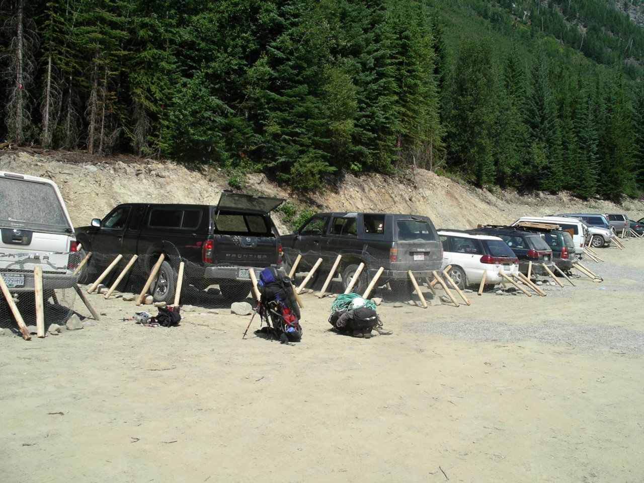

    Keep hood up when camping.
    Wrap truck in chickenwire and hope for the best if porcupines are nearby.

    Yep. This is why cats ended up being domesticated.

    where'd they get all those sticks?
    hopefully they didn't have to carry/bring all that
    would take up a lot of space

    The park supplies the wood, rocks and chicken wire rolls at the trailhead parking lot.

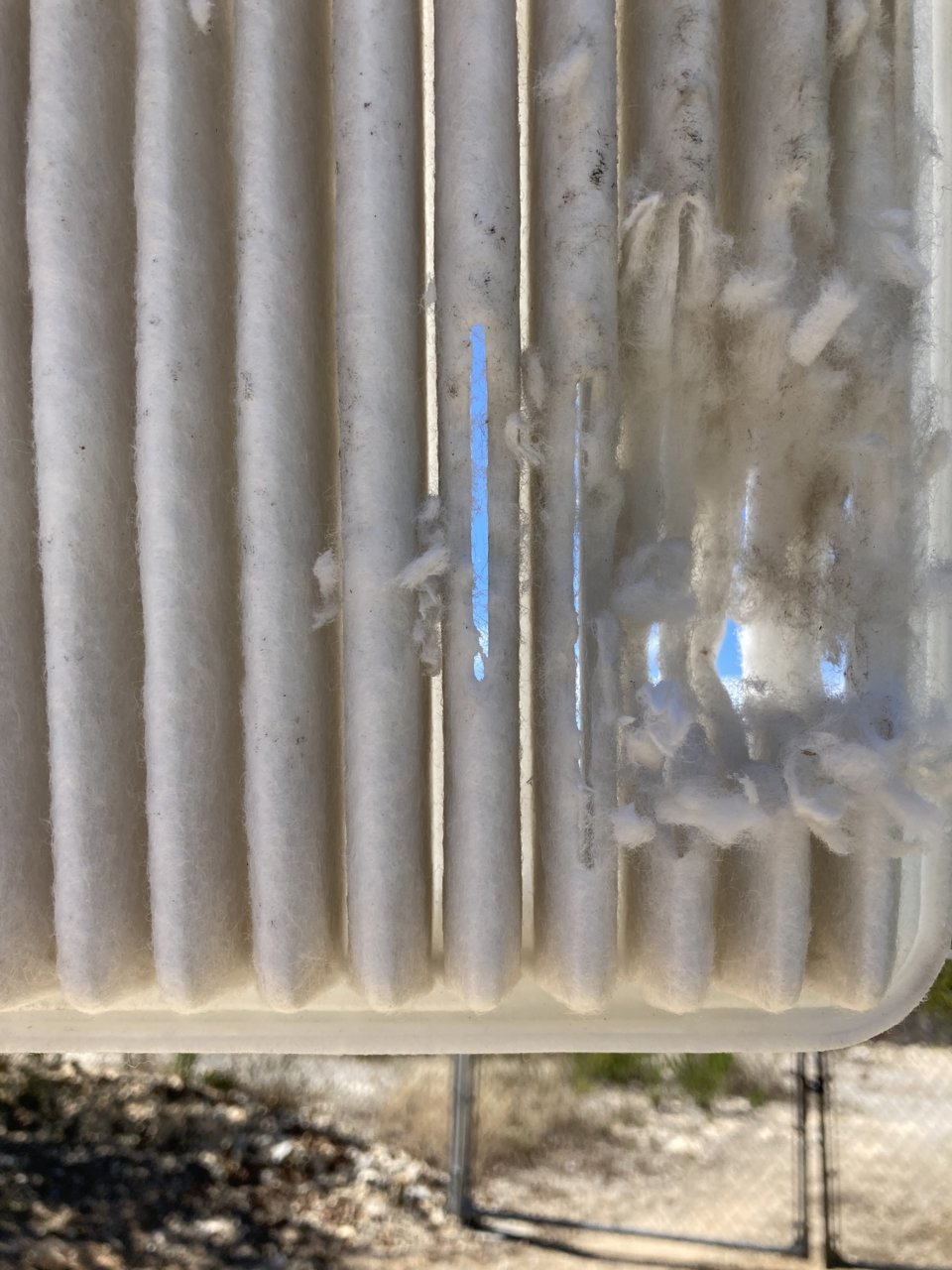

    I need to do this. When I replaced the cabin air filter I found a mouse had chewed up the plastic and shredded the baffles. Never found the mouse. :(
