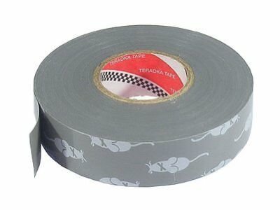

    Honda actually makes a spicy electrical tape to try & prevent this issue. It's coated with capsaicin. Stuff ain't cheap though & it looks unsightly. I suppose you could just cover it with a layer of regular black electrical if one wanted to use it. No idea if it works well though.

    A guy on one of fhe other forums I frequent works for American Honda and he reports warranty claims for rodent damage went way down when Honda first started using this almost twenty years ago, on O2 sensor harnesses IIRC. They’ve started using more of it in more places over the years. It works.
    Half the price on eBay compared to my local Honda dealer.
