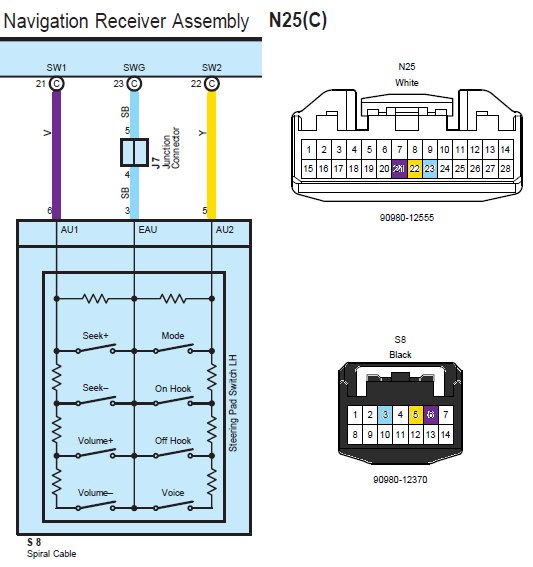

  19. Mar 7, 2021 at 1:24 PM
    #19
    caribe makaira
    caribe makaira Well-Known Member
    Feb 13, 2011
    #51121
    11,758
    Caribbean, Puerto Rico
    05 PreRunner TRD Offroad AutoTrans
    Hood Struts, My version Fogs always ON, Map & Overhead Light Mod,
    These are the connectors to the OEM Radio for the steering controls.

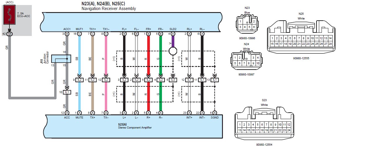

  20. Mar 7, 2021 at 1:39 PM
    #20
    caribe makaira
    Feb 13, 2011
    #51121
    11,758
    Connections (signals_Gray is shared Fused Power) between Head Unit and Amp.
