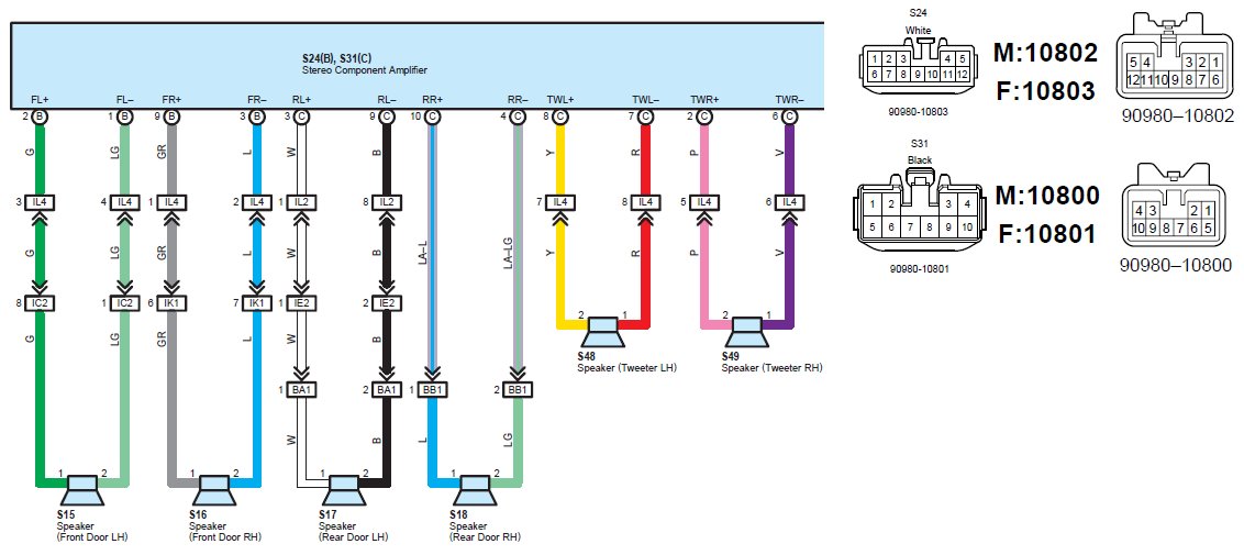

    Ok so i have to hook the power sport amp up to to the factory head/radio and this would allow steering wheel controls for the aftermarket amp......?

    Bruhhhhh..... no.
    Also, no.
    And nope again no no no no no no no. The final answer is no.
    You have two options. Remove the sub, relocate the factory amp.
    Remove the JBL system entirely, install an aftermarket stereo with SW interface and run new speaker wire.
    Also FYI you cannot hook a steering wheel control interface to an amplifier.

    Thanks, I’ll keep that for reference. I said run new speaker wire because he is wanting to gut the area where the current speaker wire connection is.

    Maybe it’s not worth it. Just my opinion but is the Space you gain from this really worth the loss of the components?
