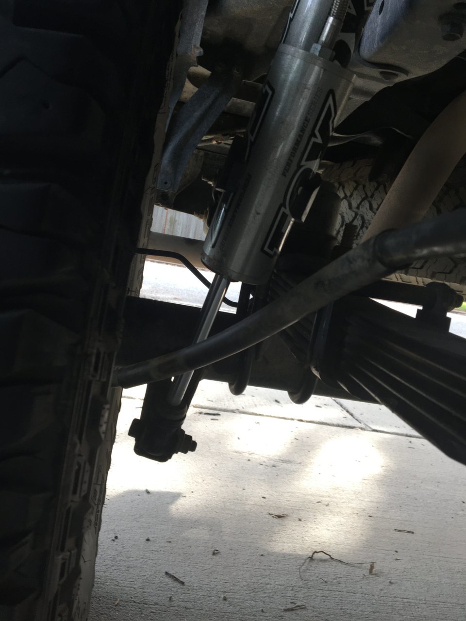

    Happy Sunday. Lately I’ve been hearing a small jingling noise over bumps and assumed it was the chain holding my spare tire. I got under the truck today and found a clamp on the passenger side parking brake cable has been contacting the remote resi on my Fox 2.0s.

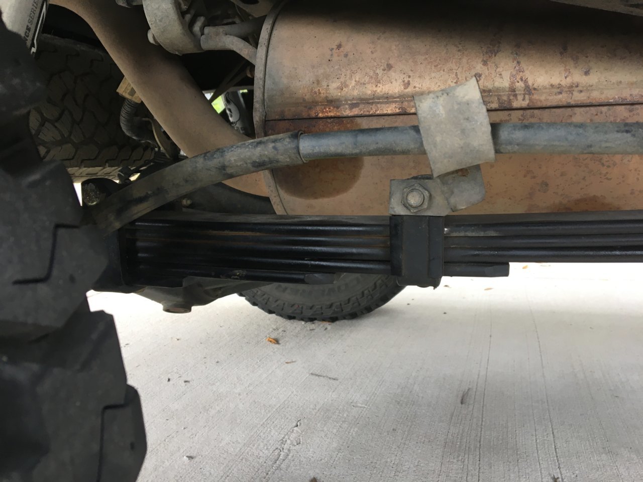

    Here I was able to reuse the old brackets on the Icon RXT leafs. I just used a step bit to open the mounting hole in the bracket large enough to fit on the retaining clip bolt.

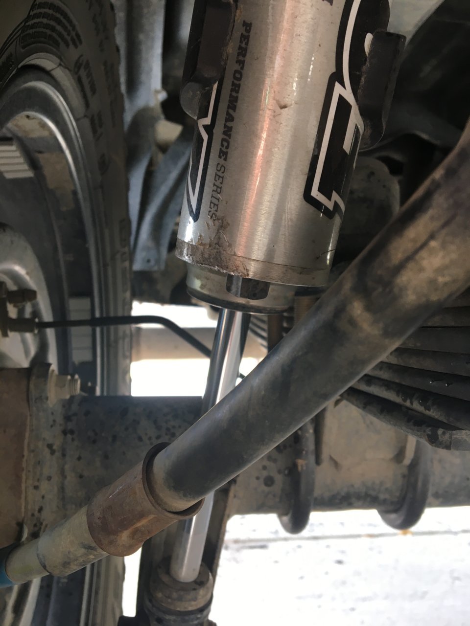

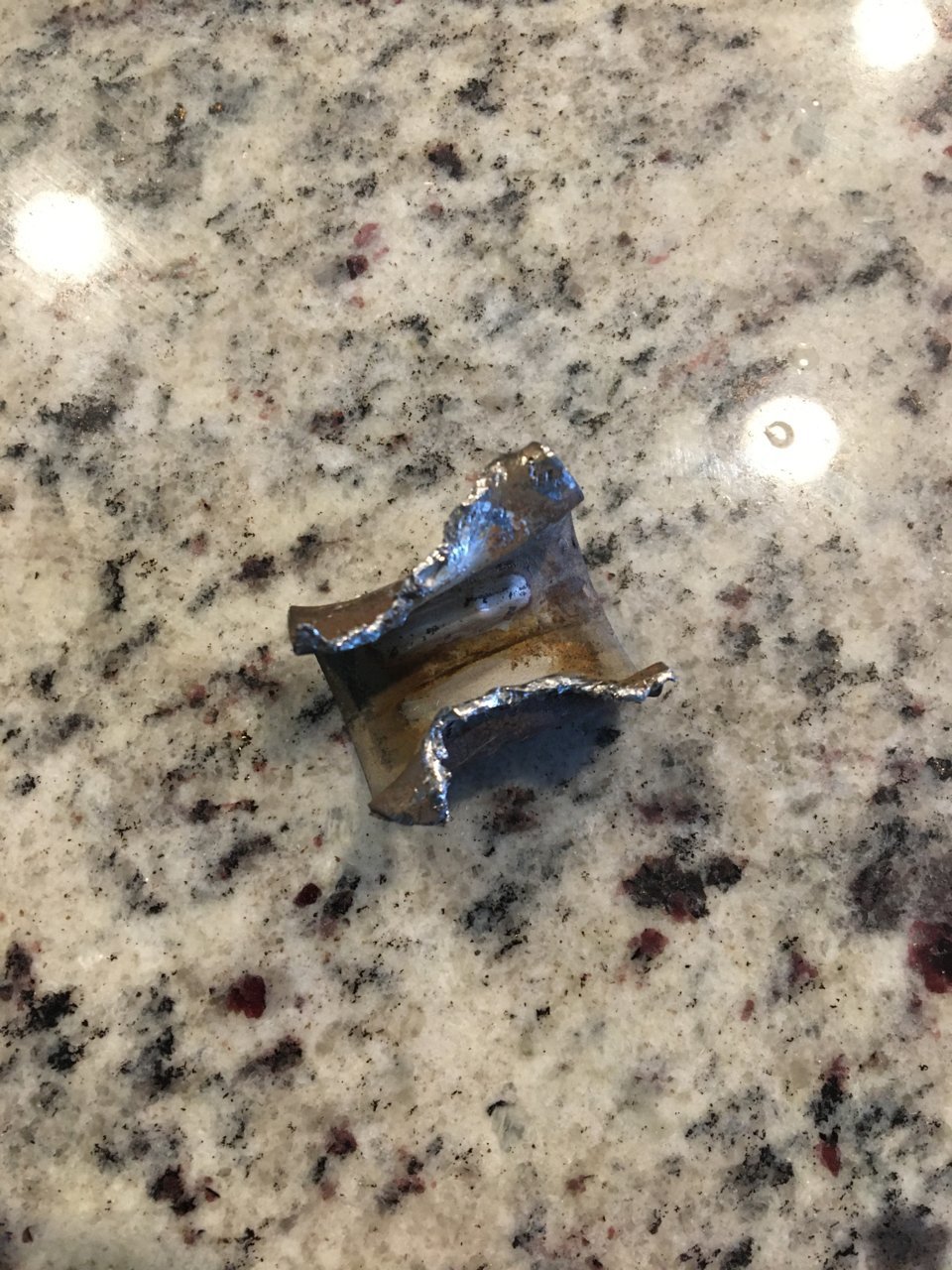

    Alright, I think I made it 24 hours before impatience got the best of me. I tried channel locks, vice grips, and lube inside the abrasion guard and moved it a further few inches. To make this work it would probably have to slide a literal 6-9 inches forward. I didn’t feel like yanking on the cable all night.
    So after about an hour with tin snips and pliers I got it off.
    Now the guard is slightly loose, but still in place towards the back of the rear drum where it will save the cable from rocks and debris.
    I know another option would have been to mount the remote resi on the frame (which I’ll still do in the near further for other reasons) but now I have no worries about this cable slapping my expensive parts.
