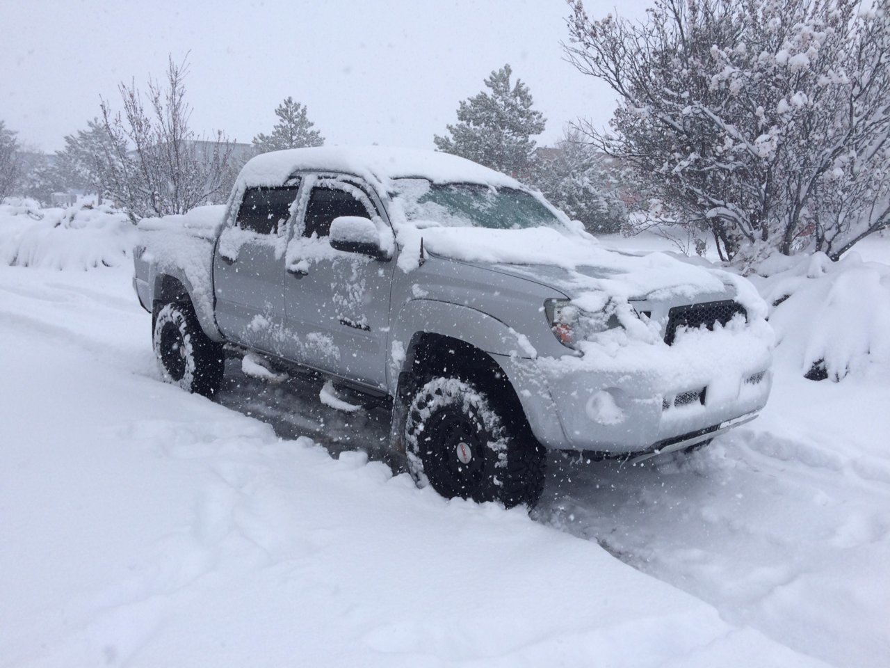

    A few additions to make me feel cool.
    DuraTrac's are great in the snow but they cup, wear like crap and have a two ply sidewall. I would look at the Nitto Ridge Grappler.

    If you have that much snow (must be summit county), might look into Nokian tires.

    The 2nd set of wheels with a set of dedicated winter tires is the way to go for those conditions.
    The wheel diameter doesn't matter.(16 vs 17). But yes, you'll find that narrower and taller is the common recommendation. Like most things, there are conditional exceptions. But this is one of those times that going with the odds is in your favor.
    Look at a place like Tire Rack to learn about winter tire types and function. Blizzaks, Nokian and a couple others are excellent.
    Keep in mind that when you say 5', you aren't going to drive in that. The more severe driving will be on iced roads, or ice pack on top of snow.

    Let me add, you have a Tacoma. A good set of all terrain tires will do fine. This is coming from a man that lived in Montana for 19 years, and Colorado about the same amount of time. I have never owned a set of snow tires until this month, but these are on my Lexus IS350 rear wheel drive commuter car.

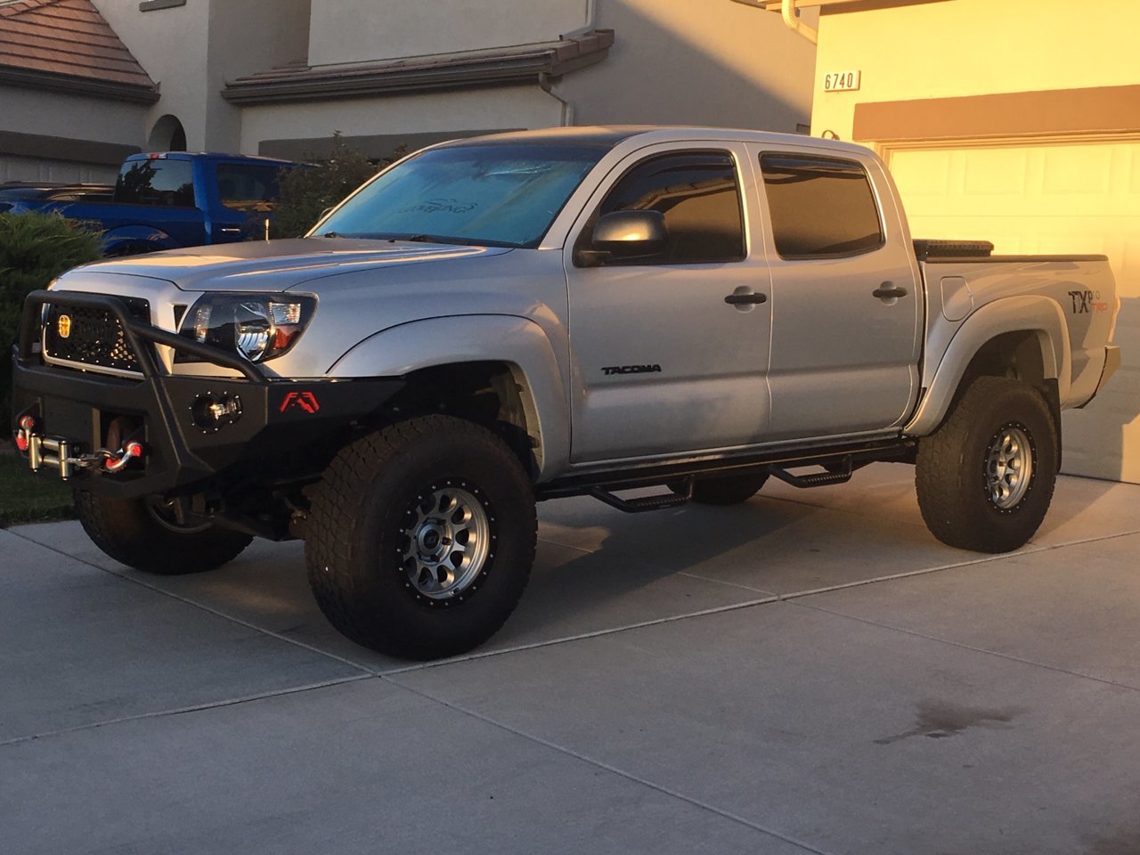

    No worries man. My opinion is the Nitto is the best quality tire on the market. They wear great and balance better than any other tire I have found. I think you will be happy with that choice. This is my truck with the Terra's. I did not go with the Ridge though it looks much better because it is hot here in the summer and you can hear the tread sticking to the road eating up your tires so I wanted as much rubber as I could get. LOL... You can also get most of the Nitto tires in an 8 ply which is the sweet spot for these truck if you ask me. Saves some weight but can handle some abuse. 285/75/16 on mine.

    NICE! Did you have to do anything special to get the 285/75/16's to fit correctly? I've heard that they rub in certain spots if you don't have enough extra lift on the truck

    Yeah I have a 3" OME lift with dakar leafs in the back and SPC UCA's and the plate bumper allows for a little more room. I did not have to do a CMC but I would not try for 285's if you do not have a lift. I ran 265/75/16 for years and should have stayed with that but I have an ego issue and an average penis.
    I have heard that the 3rd gen has a little more room to add bigger tires over the 2nd gen but you might want to research that. Every truck is a little different so I would be sceptical in thinking you would get 285's to work well on a stock setup without a lot of cutting. I would think you could do 265/75/16 pretty easy setup the way you are.

    No all terrain will be even close to matching the performance of a winter set.
    My suggestion would be get a set of summer/wheeling tires, and a dedicated set of studless snow tires if you want the best performance.

    I used a full OME kit with OME shocks all around, 886 coils for the added weight up front plus the OME HD rear leaf pack and SPC UCA's. I have used this setup on two Tacomas and am happy with the results.
    I would recommend talking to Marie @HeadStrong Off-Road or @Wheeler's Off-Road Inc . They will be able to get you the best setup for what you want to achieve for the best price.
    It is also okay to use the 3 leaf progressive aal, it will give you the lift you want and save you a little coin over replacing the rear packs.
    UCA's are not a must but for me I like to upgrade it all and correctly, to get the geometry you want you will want aftermarket UCAs in my opinion but it is highly debated.
