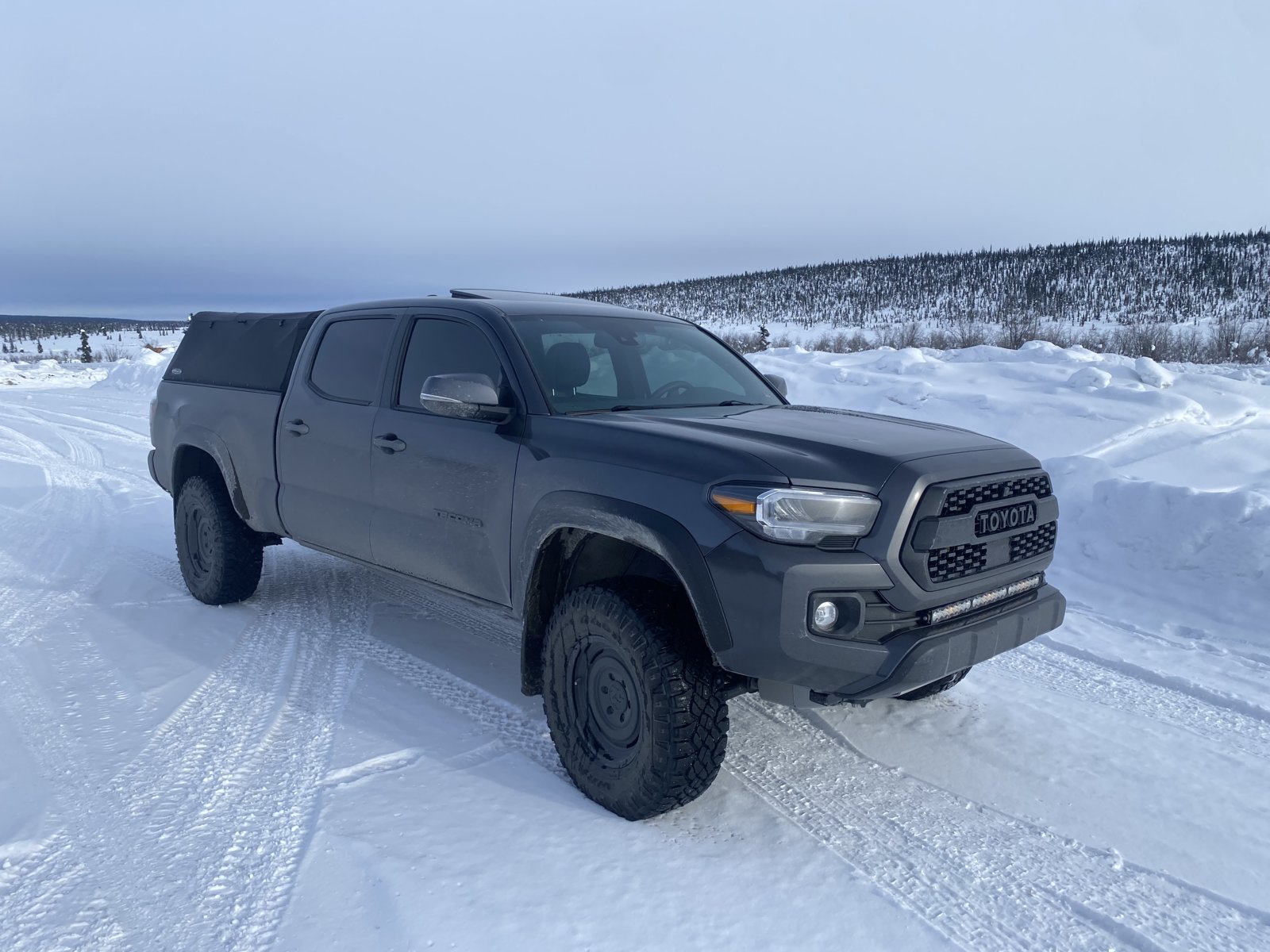

    Welcome back, when you get back & you might post in the Alaska page & see if anybody chimes in i run Softopper year round. & i get way more snow than the Banks. I also have summer wheels & tires & winter wheels & tires. & if gonna be running around outside city, i recommend some Moose lights.

    You can run a shell, tonneau or soft topper year round here, it doesn’t snow enough to even come close to collapsing one. You’ll want a battery heat blanket, pad or trickle charger, an oil pan heater pad and a block heater. Test your coolant to see if it’s good to -40°F and replace if not. Winter/studded tires are dependent on where around town you live and what you want to do in the winter. If you live in town and just drive back and forth to work all seasons and 4hi will be fine. Live on the hills or want to get out a lot you will want studs or snows.

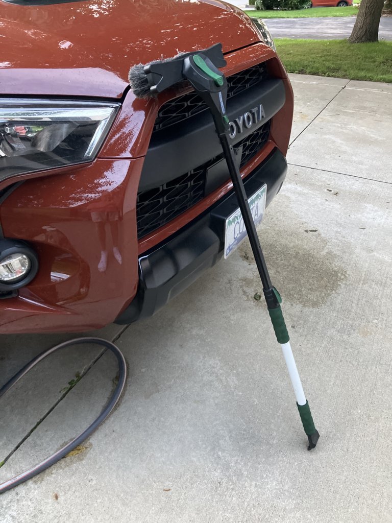

    If you don't have one, get a sturdy snow scraper/brush with a long handle or one that telescopes. Might have to buy it in rural BC or AK.
