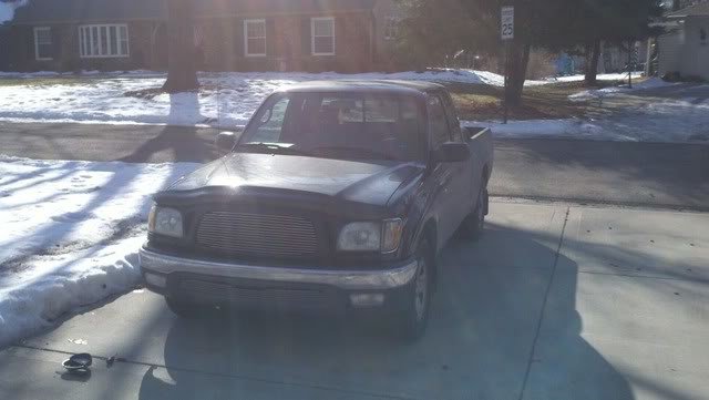

    It sure isn't much of a "build" yet per se, but it's getting started. I figured I had enough little stuff done that someone might be interested. Hopefully it will really be taking shape by the end of winter.
    This is my truck the week i brought it home
    It's a 2004 5 lug 4X2 with the 2.4 L engine and a 5-speed transmission

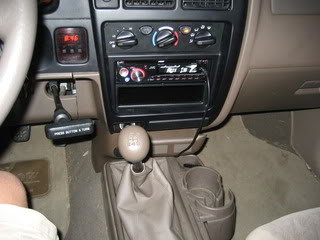

    I started out by putting in a new JVC head unit. I mostly wanted something to plug my ipod into, and I got it with the dash kit for like $70 from a friend that works at Best Buy.

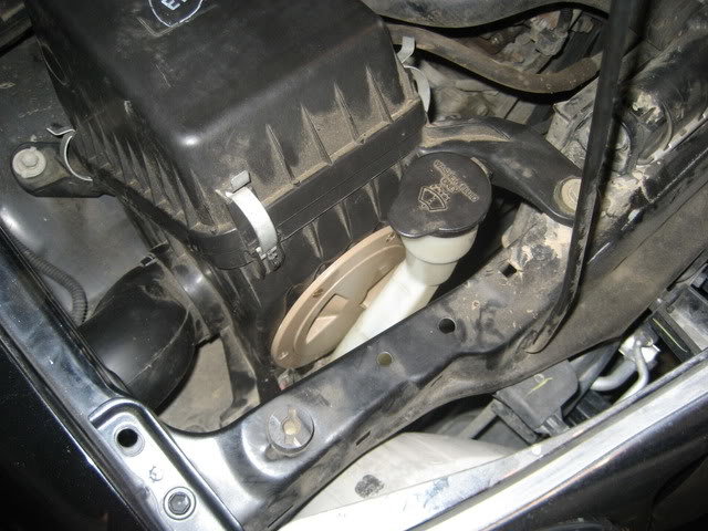

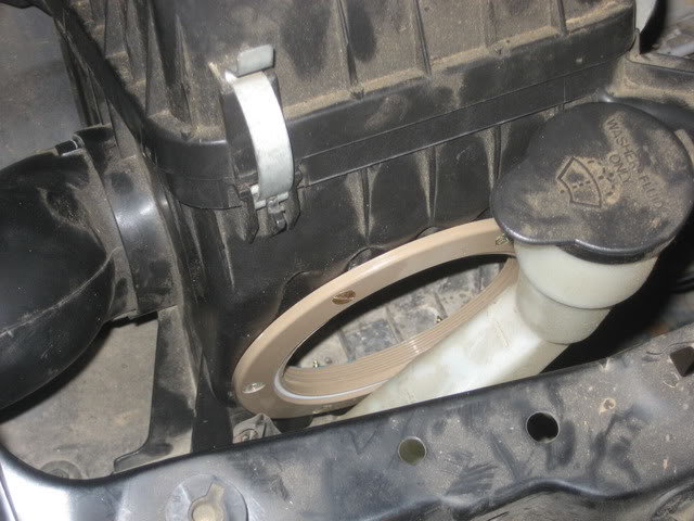

    Next came the 1st gen specialty, the deck plate mod. It was pretty easy and I've noticed a good growl when it's under a heavy load and I gas it. It has also improved the MPGs ( but that could also be due to the fill up the tires mod). It also makes an annoying whistle right around 40 mph, which I am assuming is just the air moving around the hole.
    Closed
    Open
    This is another thing I thought was cool when I had it ripped apart.
    I guess the air filter works...

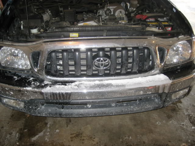

    This is my latest mod. I bought a Carriage Works grille off Craigslist and put it in. I think it looks kind of weird, like I did the wrong mod first. I want to either add black lenses to the headlights and corner lights, or get clear corner lenses. I am questioning the legality and the dimming effects of the black lenses. (They're the ones that are on "THE LIST".)
    This it what it looked like before. That's just snow and ice on the bumper, for some reason I decided to do this on the coldest day of the year so far. I think it was like -5 with -20 wind chill :eek:
    All torn apart
    Cut the old one out (definitely tape your surround off if you are cutting out the old grille. Mine was wet and the tape kinda fell off while i was grinding it down with the dremel and I nicked it. It's not bad, but it really pissed me off.)
    And I got the upper and lower installed back onto the truck. I broke 1 of those stupid clips and 2 wouldn't go back in, so it's held in by 5 now. It is still solid and doesn't feel like it'll fall off.

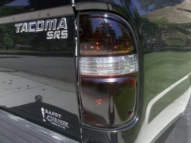

    My next mod was to tint the taillights. I used VHT Niteshades and masked off the reverse light to keep them bright.

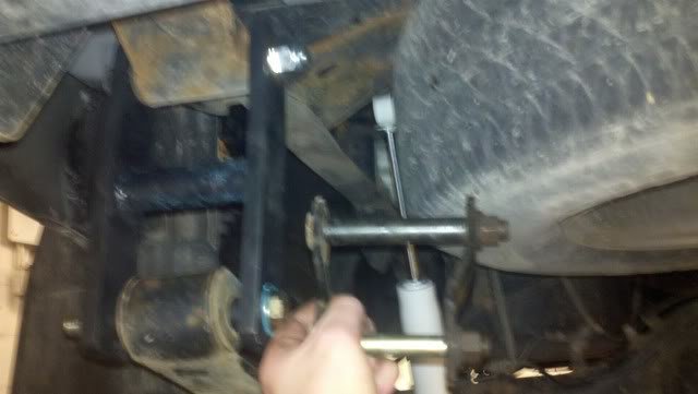

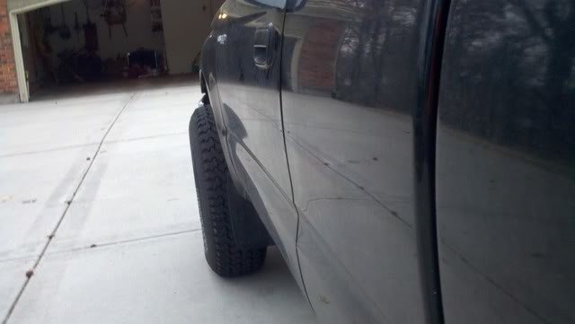

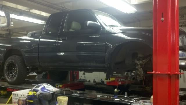

    And finally... the lift!
    Beefed rear shackles
    And my BPV relocation bracket

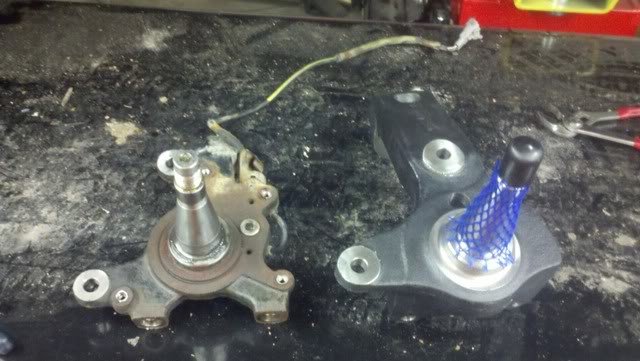

    Fabtech spindles
    Almost there...
    Complete :D You can also see my new wheels (Cragar D-Windows) and tires (Goodyear Wrangler Radials 235/75/R15)
    Doing the lift myself was pretty enjoyable. I learned a lot and having the use of a shop definitely helped. The only ill effect was that my ABS sensors were very rusted into the old spindles and I completely destroyed them with an air chisel (last resort, I definitely tried other less destructive methods first) so that's about a $400 incidental, thanks Toyota! :mad:
    I still need to align it and work on the tire balance, didn't quite get it right the first time (I also mounted and *attempted* balancing them myself). I also am considering bushwacker flares or something to cover the increased amount the tires stick out now.
