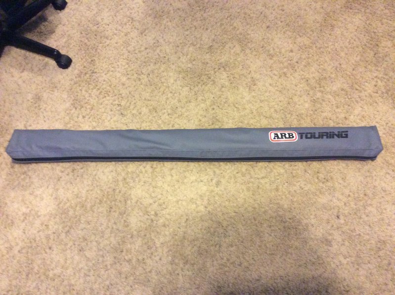

    Awning installed! Here's a little write up on how I mounted my ARB 1250 awning to my Prinsu cabrack.
    Started off by getting the hardware. You can buy it from lowes or Home Depot. I bought :
    (6) 1/4 x 5/8 x 1/2 stainless steel bushings
    (6) m6 1.0 x 40 bolts
    (6) m6 locking nuts
    (6) washers left over from my rack.
    Here is where I mounted the bolts, 4 bolts in the top slots (circled in green) and 1 in each lower slot (circled in red).
    Then put the awning up to the rack, put all the bolts in the correct slots, and mounted it up. Sits at a perfect height, and doesn't interfere with the doors what so ever. Only thing I could of done better was to remove the cross bars that were over the lower bolts as they were in the way and could of made it easier to get them on. Hope this helps! Now for some pictures.

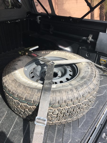

    Installed a extra OEM d-ring, along with a SDHQ Y-tire strap.

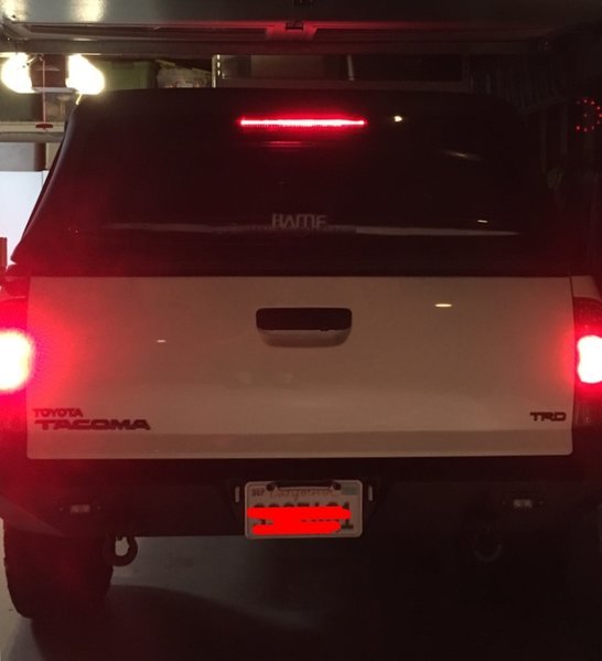

    LED third brake light installed on my bestop.
