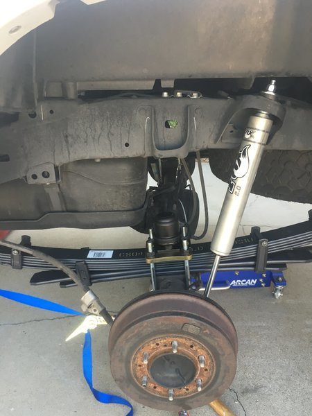

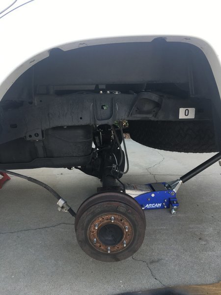

    Well, did my rear set up today! Before doing anything I measured it. I had 22-2/3" from center of the wheel to the top of the wheel well. That was with a 1.5" spacer installed. So without it, I would be at ~21-1/4" sitting stock. After the install I measured again and am now at 25-1/2". So from stock, I got approximately 3-3/4" of lift with the OME DAKARS. I assume they are going to settle a bit so the height will drop a smidge. Install took about 3 hours and was easier after doing the driver side. Passenger side was a breeze! Here are some pics of the install. Installed was OME dakars, all pro u bolt flip kit, wheelers super bumps, and fox extended shocks!
    Couldn't of done without @Bman4X5 help!

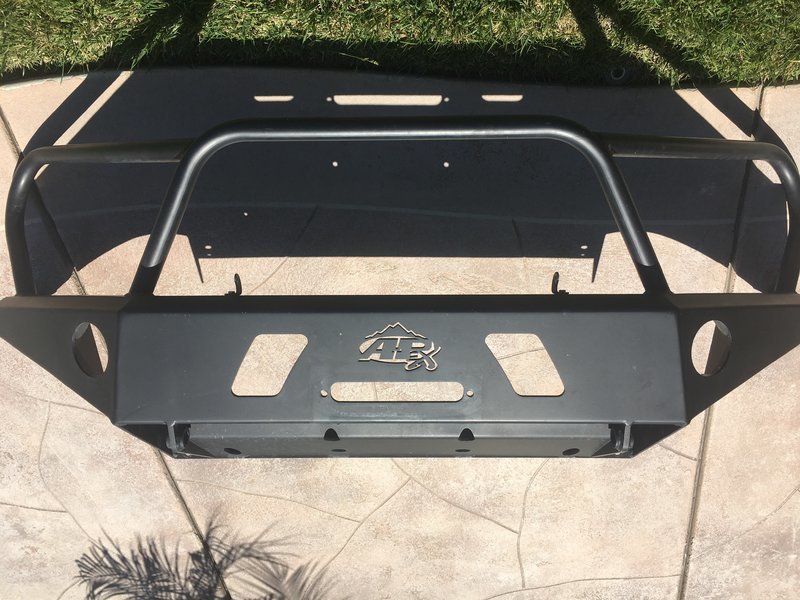

    Well fox coilovers are on! Will post pics tomorrow! Also, got a all pro offroad apex front bumper. Will be installed this weekend or early next week. Pics to come as parts get mounted!

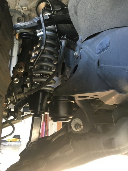

    New suspension setup on! Fox 2.5 non-reservoir coilovers, wheelers super bumps, and icon sway bare relocation kit!

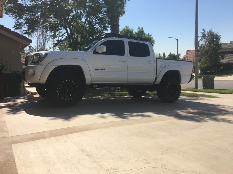

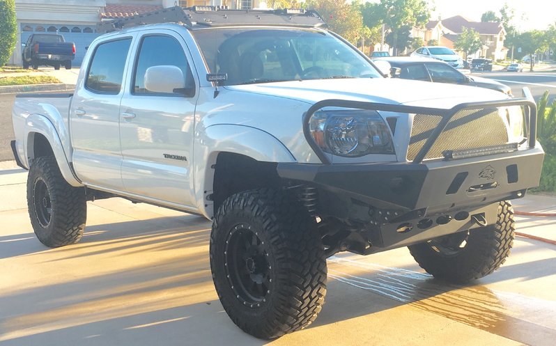

    Well here we go!

    And she's on!

    big difference :thumbsup:

    Huge difference! Completely changed the look of the truck

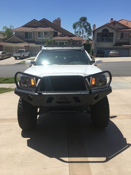

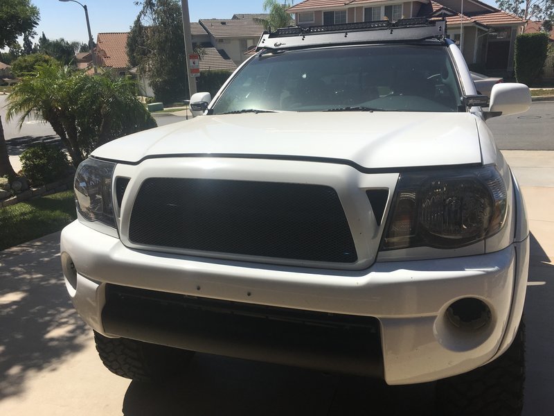

    Well I removed the sway bar and so far I like having it off. Mounted my rigid industries amber fogs in the new bumper, ordered some wheel spacers and also the coilover wrench to adjust my coilovers. So hopefully that stuff will be here soon and I can get it all adjusted! Last two main things on my list will be all pro sliders and a bestop softop! Will post pics of the new fogs in a bit!
