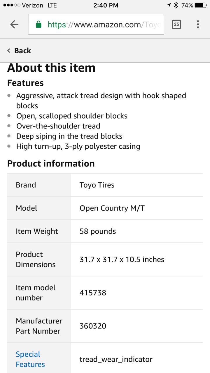

    Which tires did you get? I'm sorry, but there's no way each one weighs 68lbs. That's about what 35" tires weigh

    Toyo Open Country MT. The number didn't seem right either but found it on a few sites.
    Seems should be 58lbs.

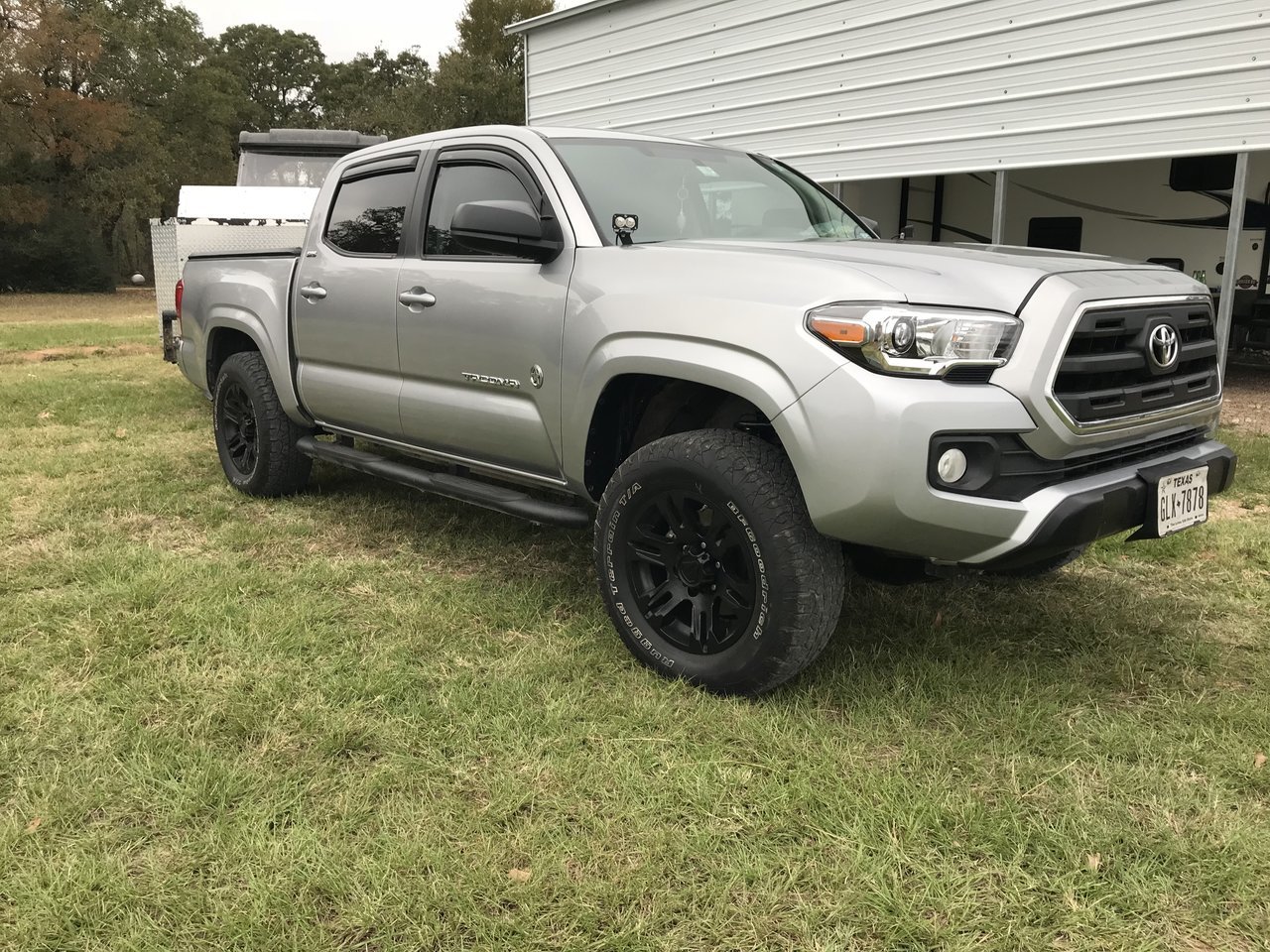

    Thanks for the advice guys. I went ahead and swapped the wheels and tires(With another member), no noticeable change in mpg but I also wasn't able to test it out accurately due to the snow and different driving conditions.

    Same tires and wheels I just took off, you should see 18 city and up to 22 highway like I did! Ex twinsies

    910
