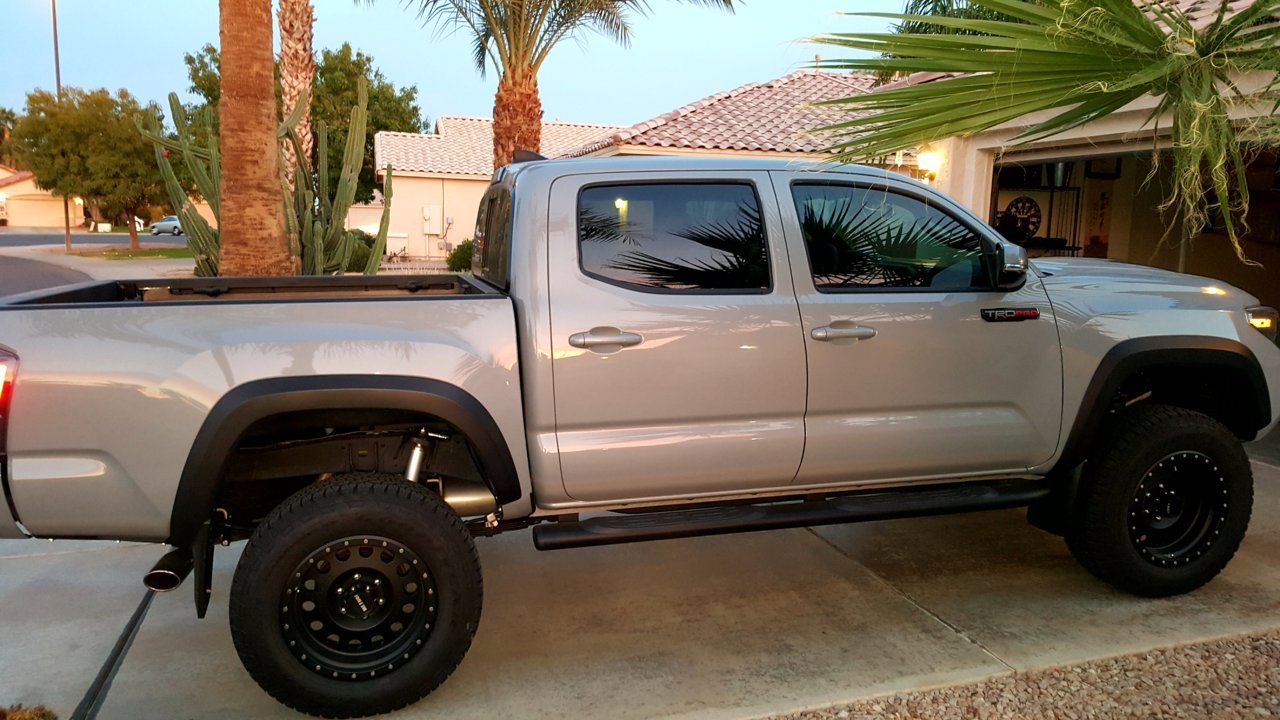

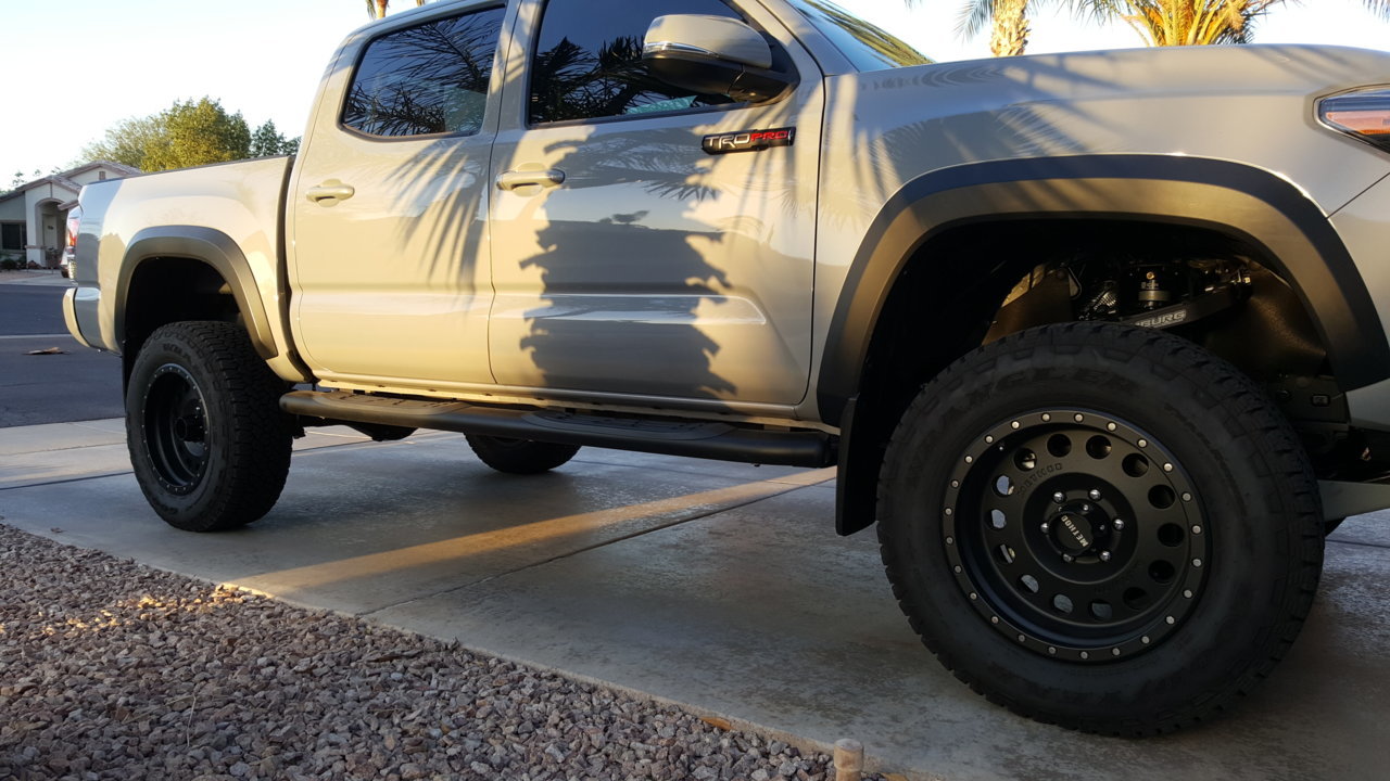

    Dacon 2017 Tacoma TRD PRO Quikrete
    Dec 20, 2016
    #205354
    2,937
    Danny
    Gilbert, Arizona.
    2017 TRD PRO DCSB. DOP 02.20.2017
    TRD PRO Cement 2017 TRD CAI and AFE Magnum Flow Dry Air Filter Camburg KINETIK Series Billet UCA Icon LCA skid plates Icon Coilover extended travel shocks with 700# springs Icon 2" rear shocks Icon RXT leaf springs full pack (new rims and tires soon)
    3" lifted on Icons.
    32.75" tires.
    89 gas.
