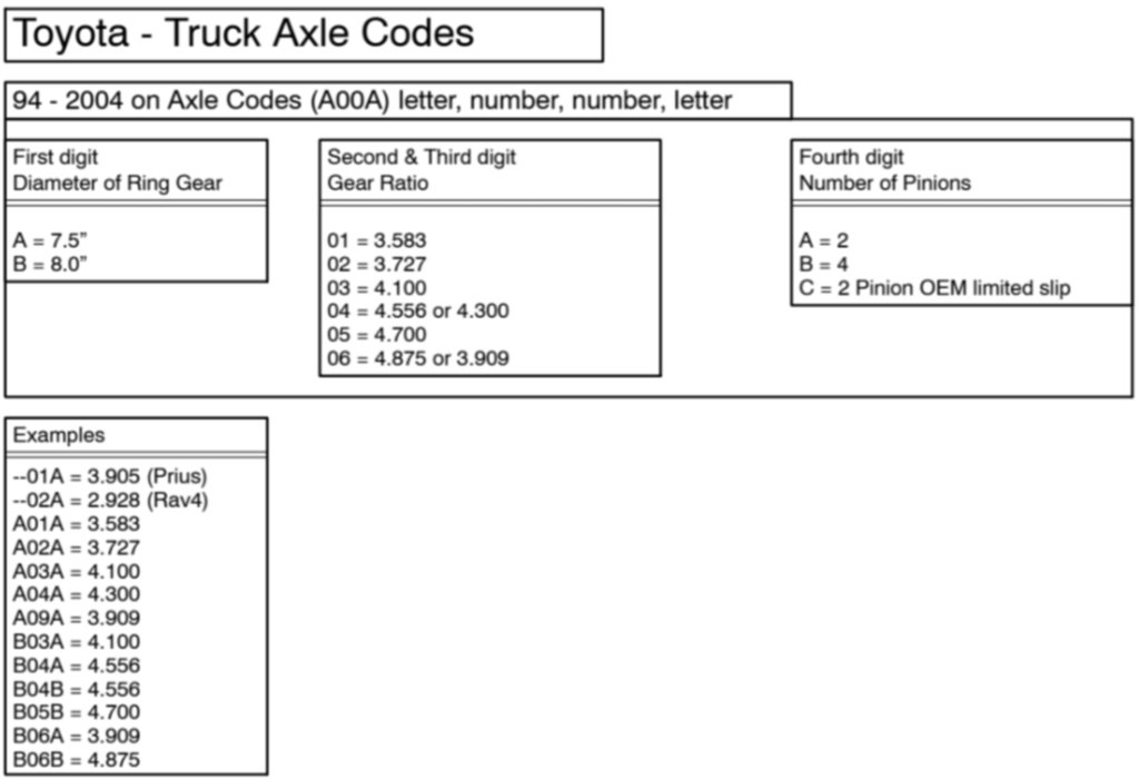

    Alright everyone, I called five dealerships in total. None of them are able to get me a replacement sticker because my VIN doesn't have one assigned in their system. Two separate locations told me that at those times, not all vehicles came with a door jam sticker since it was mostly just tire information.
    One of the guys said that he's been there for over 20 years and that if I don't have a door jam sticker, that I most likely don't have a firewall sticker either, which is true. I don't have neither. He said that that's how he remembers it being when he used to work on nothing but older first gens.
    But three of those locations gave me a code of B04A which is a 4.556 gear ratio. That's the only information I've been able to find anywhere. So unless anybody else knows where I can find the axle code, please let me know. For now I'm going with the belief that I have a 4.56, essentially.

    4.56 gears came in 2.7L AT Tacomas and 4Runners. I've found multiple sets in junkyard trucks.
    I think you're right about having 4.56. You can confirm by getting the truck up on jacks and counting turns of the wheel, but I'd put money on 4.56 given everything you've said.

    I was under the assumption I had 4.10 but after talking to three different Toyota techs, I might be wrong. I'll confirm with the driveshaft turn test this weekend.
    If it's 4.10, then I'll most likely upgrade it. But if the Toyota techs are correct at 4.56, then I'll keep it as is unless I end up getting more serious about this new hobby.
