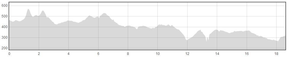

    For bullet #6, here is a handy site that lets you map the elevation change for your route: https://www.doogal.co.uk/routeelevation.php
    I used it to map my morning commute and it's clear why I get better gas mileage traveling to work than traveling home, especially when combined with bullet #16 where I often have a tailwind in the morning and headwind in the evening.
