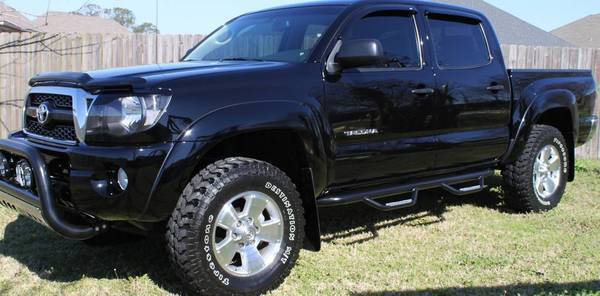

    I am new to the forum so take it easy on me haha. Here we go:
    Getting a 2008-12, Black Double Cab, 4x4, with 0-50k. Just trying to find the right deal.
    Want to:
    - Leveling kit, or 3" Lift
    - Bull bar
    - Steps, something like this - $330 Smittybilt Nerf Bar Steps - Smitty bilt Nerf Bars - Nerf Bar Stephttp://www.autoanything.com/nerf-bars/61A4999A0A0.aspx
    - Larger/more rugged-looking tires. Like Allterrains or something in that nature.
    Interested in how bad the feul economy drops off with these mods.
    I am going to try my best to sound like I know what im talking about, I am only 16, but we all have to learn sometime haha - Could changing the air intake, or some fuel efficient mod balance the drop off in MPG? Or get close?
    Soooo, I have been looking around the forum for a few months, and with
    trucks like ive been seeing, I would be showing them off every chance I could. Post picks of your ride, similar to the list above, and list your year, mods, and MPG (average, city, highway, idc)
    Thanks,
    Danny

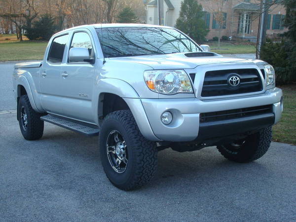

    Welcome from Flowery Branch. I can't say about the mpg's, but just put on some aftermarket wheels and tires a couple of days ago. We'll see if it affects the mpg on mine anyway. But before I averaged 19.5 with the stock sport wheels. More in the summer time but stay around there overall.
