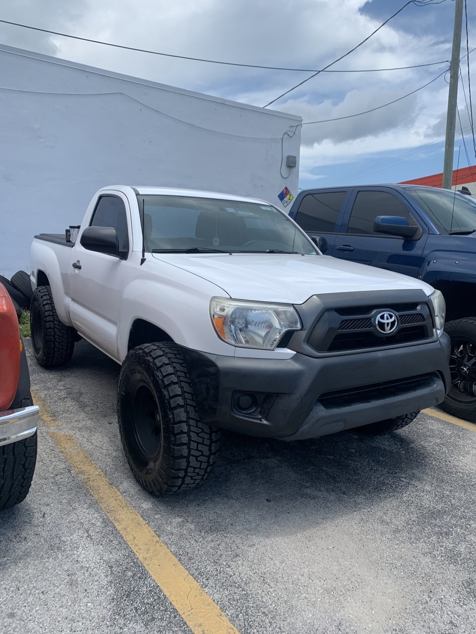

    Hey guys my name is Vic and I’m new to the forum! Got a 5 lug that I decided to put 33s on and I think I got a hole in my gas tank lol. Before I go re gearing is there anything else you guys can suggest? Thanks a lot, y’all! God Bless America!

    Put the factory tires back on it. What was your MPG before tires, and after?

    Run a street tire. It can be a 235 75 15 on OE wheels and not need any work to clear.
    Your tire choice has shot yourself in the foot, for looks, as everyone knows our 5 lugs are not 4wd
    Regearing a 5lug be a bit challenging. It will return some performance you've hampered your 4 pot with, but it may not alter/improve MPG.
    Since your speedo/odo are now out of whack, have you factored that into your MPG calculation? If not, it's not dropped as much as you think. Unless you are harder on throttle to compensate for the sluggishness of those cement shoes.

    Miles per tank is useless information, someone will be happy to do the math if you provide the numbers. It ain't hard to figure miles per gallon. Fill up truck. Drive until you're down below 1/4 tank. Fill up again and write down how many gallons it takes and how many miles you drove. Lets say you drove 250 miles on 15 gallons. Simply divide 250 by 15 for 16.6 mpg. You have a calculator on your phone.
    But to do it right you need to get a bit more complex. For one thing your bigger tires are now making both the odometer and speedometer inaccurate. You are really driving a lot farther and faster than your odometer and speedometer says you are. Meaning your fuel mileage isn't as bad as you think.
    Use this website to figure out just how far you're off. Plug in the factory tire size and the new size. Just a SWAG, but you're probably off by about 10%, which is a lot. That means you have to 1st multiply the miles your odometer says by 1.10 to determine how far you really drove. So 250 X 1.10 = 275. Then divide 275 by the fuel used. 275/15=18.3 mpg.
    If your speedometer says you're doing 60 mph, you're really doing closer to 66 mph. Driving faster hurts fuel mileage too.
