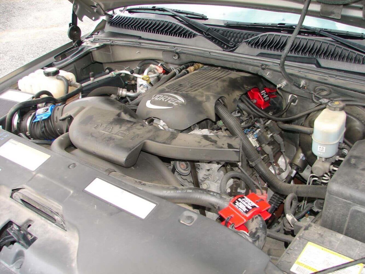

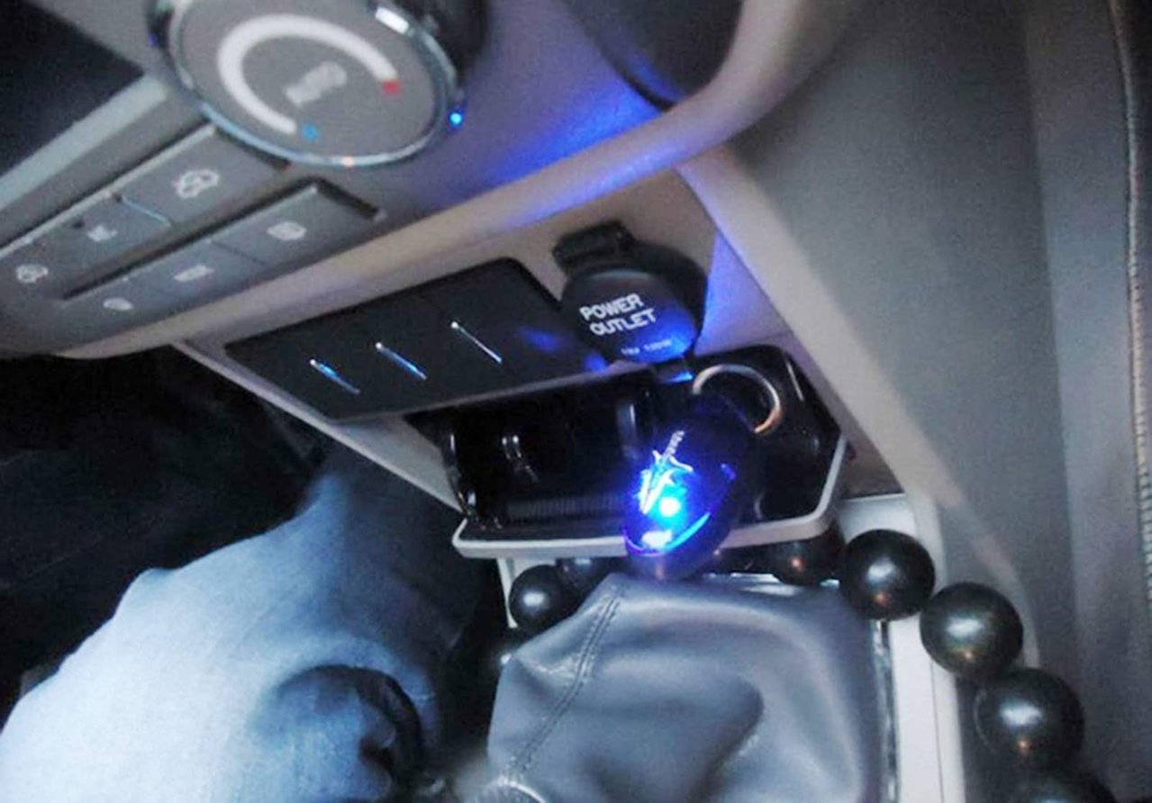

    You need a Fuel Shark in combination with the Vortex Fuel Maximizer Performance Saver and make your Prius friends jealous...
    This effectively reduces the weight of your wallet and your vehicle will be lighter, saving fuel. Please allow 100% margin of error.
