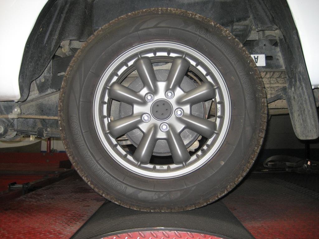

    I went with lightweight Enkei 16x7 5 lug wheels and high mileage low rolling resistance 235/60 Yokohama YK 580's (the 580 is the treadwear number which is high), and am enjoying 23-24 mpg city and 28-29 mpg highway. This combination retains the factory stock wheel diameter for an accurate speedometer and odometer, while being wider for better handling...
    The truck rides quiet and smooth and handles great in the corners. :)

    Very nice! Did you weigh the old and new to see how much weight you saved?

    I went from 16x7 stock steel Tundra wheels with 245/75/16 tires...
    ...to 16x7 alloys with 235/60/16 tires.
    That removed 15 pounds 4 ounces per wheel, for a total of 61 pounds of rotating weight. One pound of rotating weight is the equivalent of 10 pounds of static weight.

    That'll work fine as long as you retain the overall stock wheel diameter so that your final gear ratio remains the same and your speedometer and odometer stay accurate.
    I used a wheel and tire specification chart and found that I could go with a combination of a slightly larger and wider 16 inch rim and a 60 aspect ratio tire, while still retaining the factory diameter.

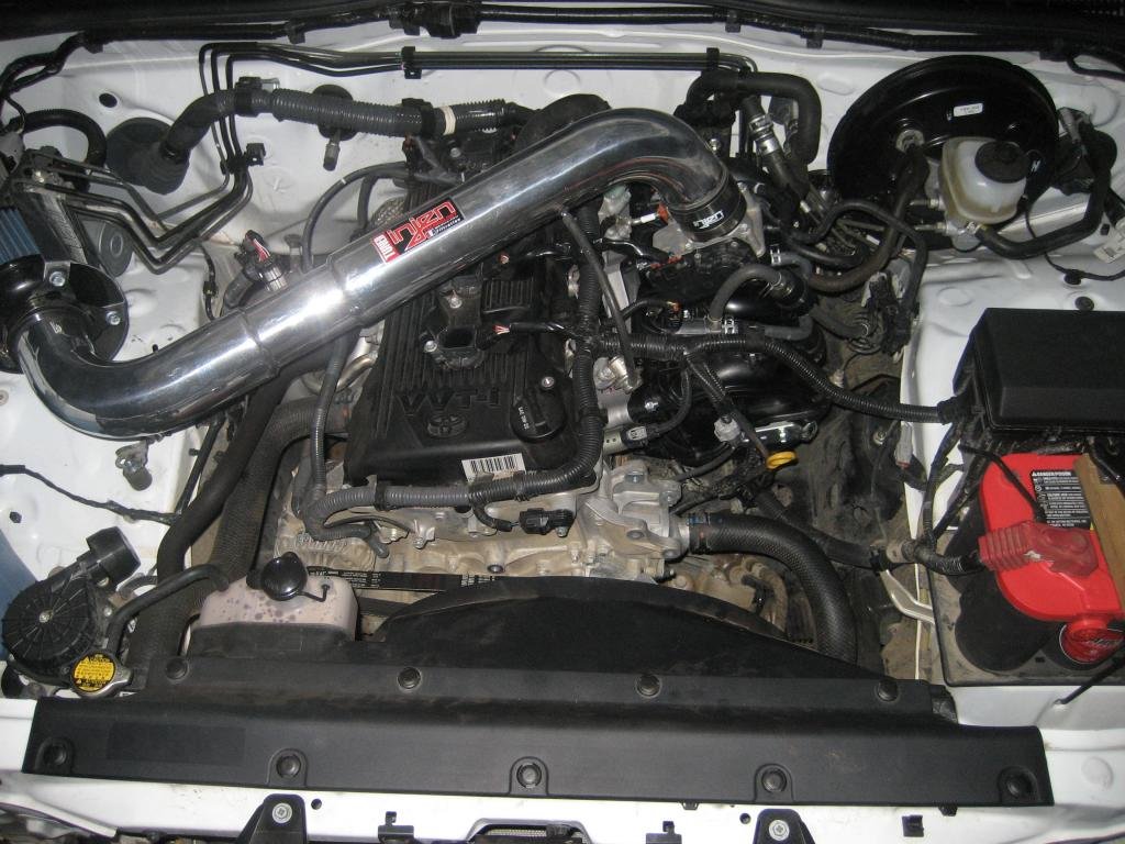

    Also, for better MPG, wouldn't a warm air intake be better?

    I think so... but then I'm the only one on this forum who runs a warm air intake. ;)
    ...and I get very good mileage for a work truck that's always loaded down with hundreds of pounds of tools and material.
    Summer: 22-24cty/27-29hwy
    Winter: 20-22cty/25-27hwy
