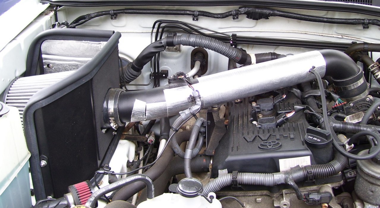

    I'm running the AFD air intake on my truck this summer and I wrapped the main pipe in some heat wrap I had sitting around. Comparing May-Sep from the previous 2 years, I'm getting around .7 to .85 mpg better gas mileage. I think the straighter/smoother airflow helps. My truck averages 16.3 mpg with the lift and 33" tires so the increase is around 5% roughly. If you do a lot of highway, I bet it will be closer to a 7-8% increase since I just do around town mostly at 45 mph or less and almost weekly boat towing.

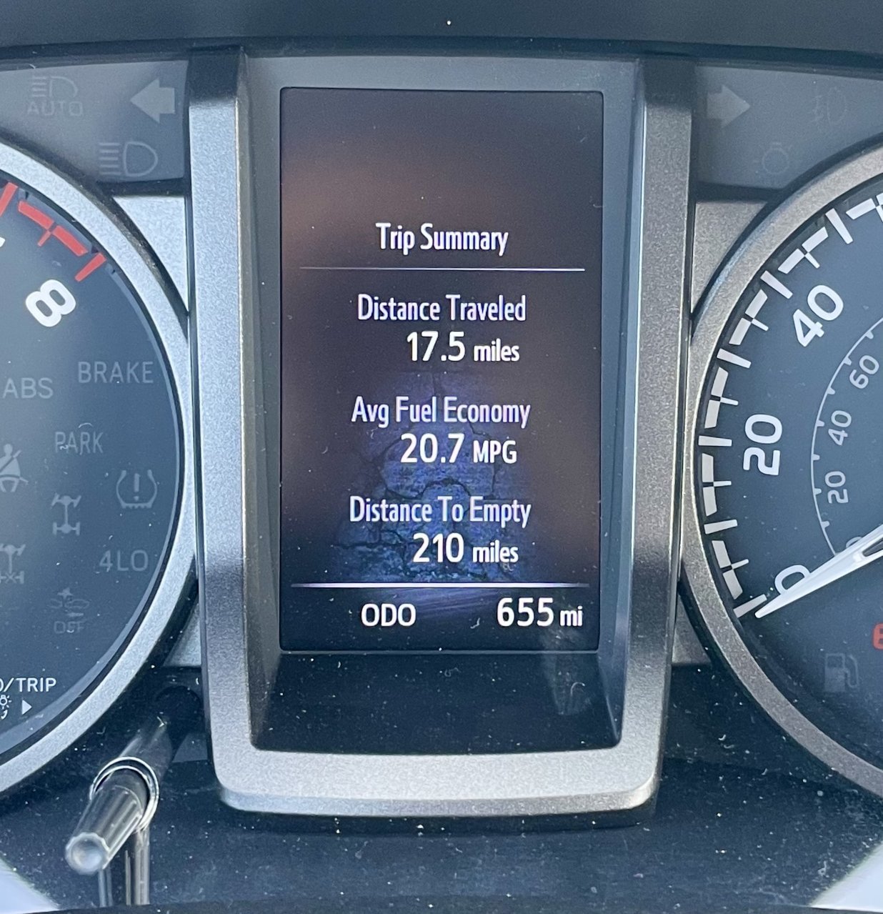

    Hey! Just bought a beautiful 2021 OR with a 3 in lift and 285s. This thread helped me go from about 14 mpg to around 20 mpg on my commute just by using the egg trick and keeping it around 65 mph on the freeway. Thanks!

    I am running the same exact setup
    Tell me your secrets...

    Over about 55 aerodynamic drag starts to take over from rolling resistance for fuel use. Once you hit about 65 drag really has it's way with your fuel tank.
    Brakes convert kinetic energy into brake dust and heat, avoid that. Don't creep up to speed, and don't floor it as one keeps you in inefficient gears, the other puts you into open loop fuel management. And quite literally due to differences in climate, drive cycle, traffic YMMV.
