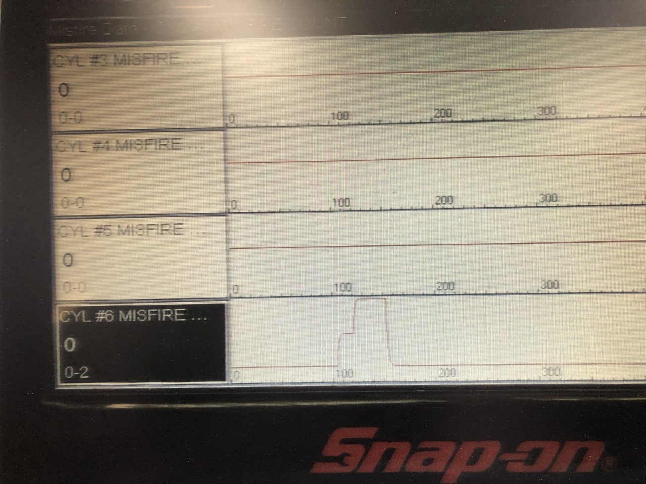

    I’m mechanically inclined so I do all my own maintenance. Just changed plugs about 3k miles ago. Checked the MAF sensor, air filter, etc.
    I took it to 2 different mechanics and none of them can find anything.
    Took it to my buddies house last weekend, he has a $2k dollar SnapOn scanner, it was reading cylinder 6 misfire but I don’t have a check engine light ?
    I also checked each coil by doing the “ticking test” and all 6 of them seem to be working.
    This is by far the strangest thing I’ve seen and I’m super curious what the culprit is, it’s been driving me crazy lol

    Move that #6 coil to a different cyl and see if the code follows
    That cylinder is prone to small headgasket leaks too
